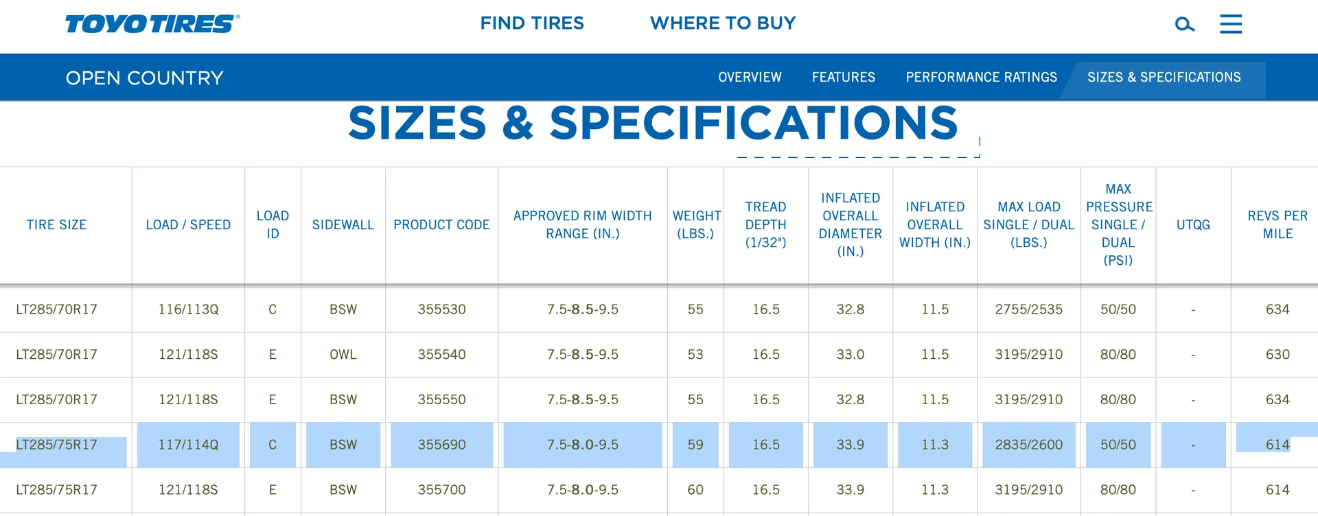

New shoe day tomorrow - similarly to above, paging @gaijin for RCTIP for 2013 LX570 for Toyo AT3 in LT 285/75R17 C load rating, highlighted in blue in the screenshot below. Placing chips on 37 and 35. Appreciate the help very much!
Can I piggyback on your request with same tire but E load rating? Since you posted the specs and all, thanks!
2011 LX570 if it makes any difference. Thanks @gaijin
It's a twofor!
The RCTIP for those LT285/75R17 tires, both Load Range C and Load Range E, on your LX570's is 35psi F/R.

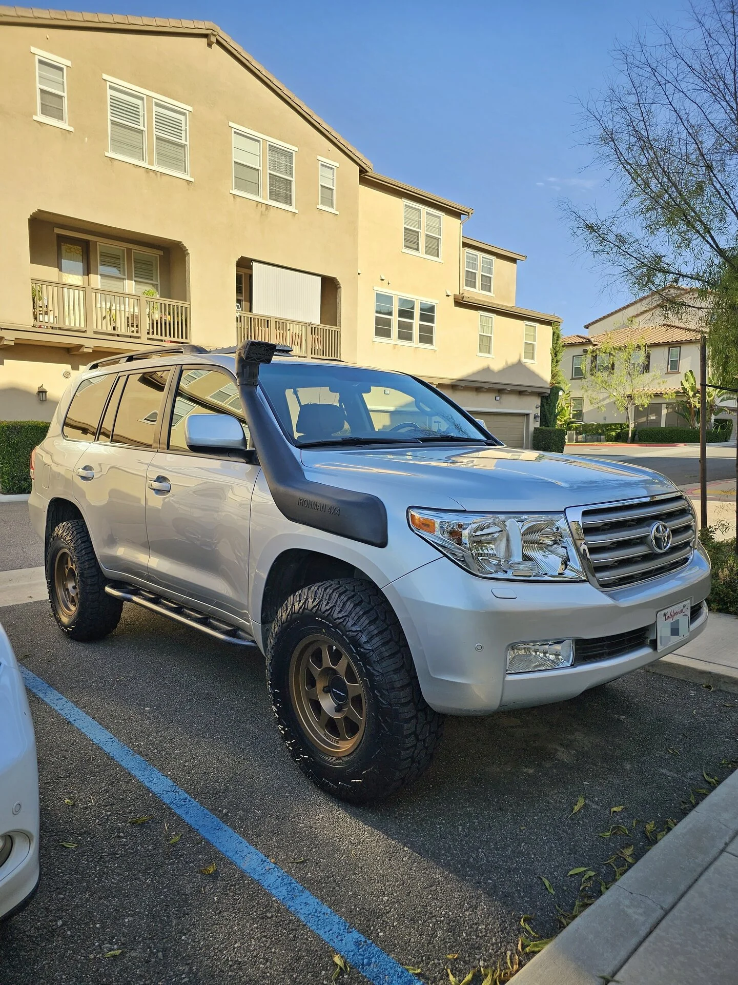

Thank you everyone for the help. After lot of analysis paralysis, this is what I ended up with.
Tire is 45lbs
Wheels 30lbs
Offset 40mm
Total 75 lbs.
MR318 with General Grabber ATX
Lots of photos here:

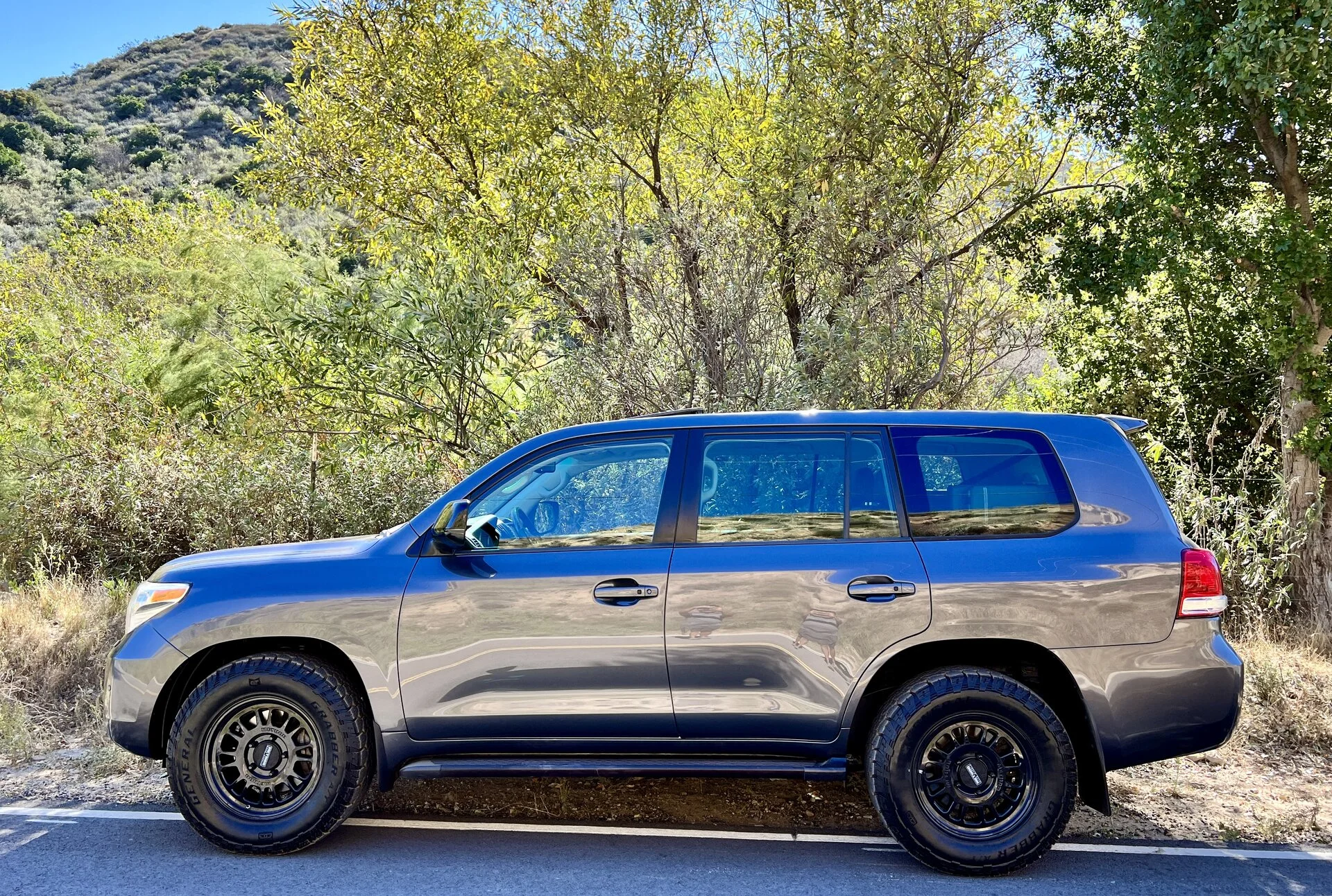

@ryanCA
I have run a 9” wide 25mm offset Method bead grip wheel without issue with Lt275/70r18. Typically i would air down to 15 psi in the rocks and rough terrain. The method bead grip is legit. Haven’t lost a bead even after inadvertently running below 8 psi which eventually went to 0 psi after 2 miles into the trail. Valve core was not put all the way back in after airing down.
The Kenda Klever RT does measure 11.43” wide so it’s extremely wide for a 275 , even wider then alot of 285 width tires.
25mm offset looks great without too much tire extending beyond the fenders. I had to remove the mud flaps and trim / mold a lot of plastic compared to a more conservative offset say between 45mm 60mm.

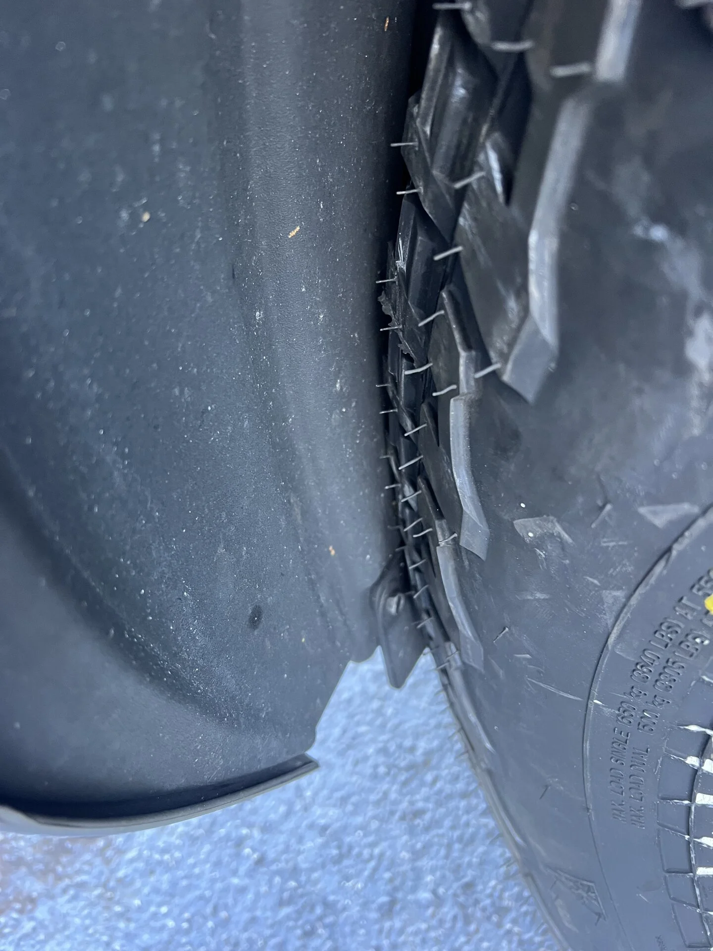

After reading through most of this thread and taking a look at that spread sheet, I ordered some Falken Wild Peaks in 275/70/R18. From what I read, there was supposed be no rubbing. Unfortunately, they do in fact rub in the front mud flap nearing full lock in both forward and reverse. Not the end of the world, but very annoying none the less.
Specs are 2021 LC HE with stock 18's and 1.25" spacers. Here are some pics for reference:
STOCK:
With the Wild peaks mounted:
THE RUB A DUB LOCATION:
Going to remove the spacer even though I like the way the tires fill the wheel wells right not and see if they still rub but my initial guess is that they will.

I run this size in a different tire. You have a few options. 1. Removing the spacer may cure it but the tires are skinny and could look off. 2. Add OEM coil spacer may cure it while keeping wheel spacer 3. Go to HF and but a cheap heat gun and go to work.

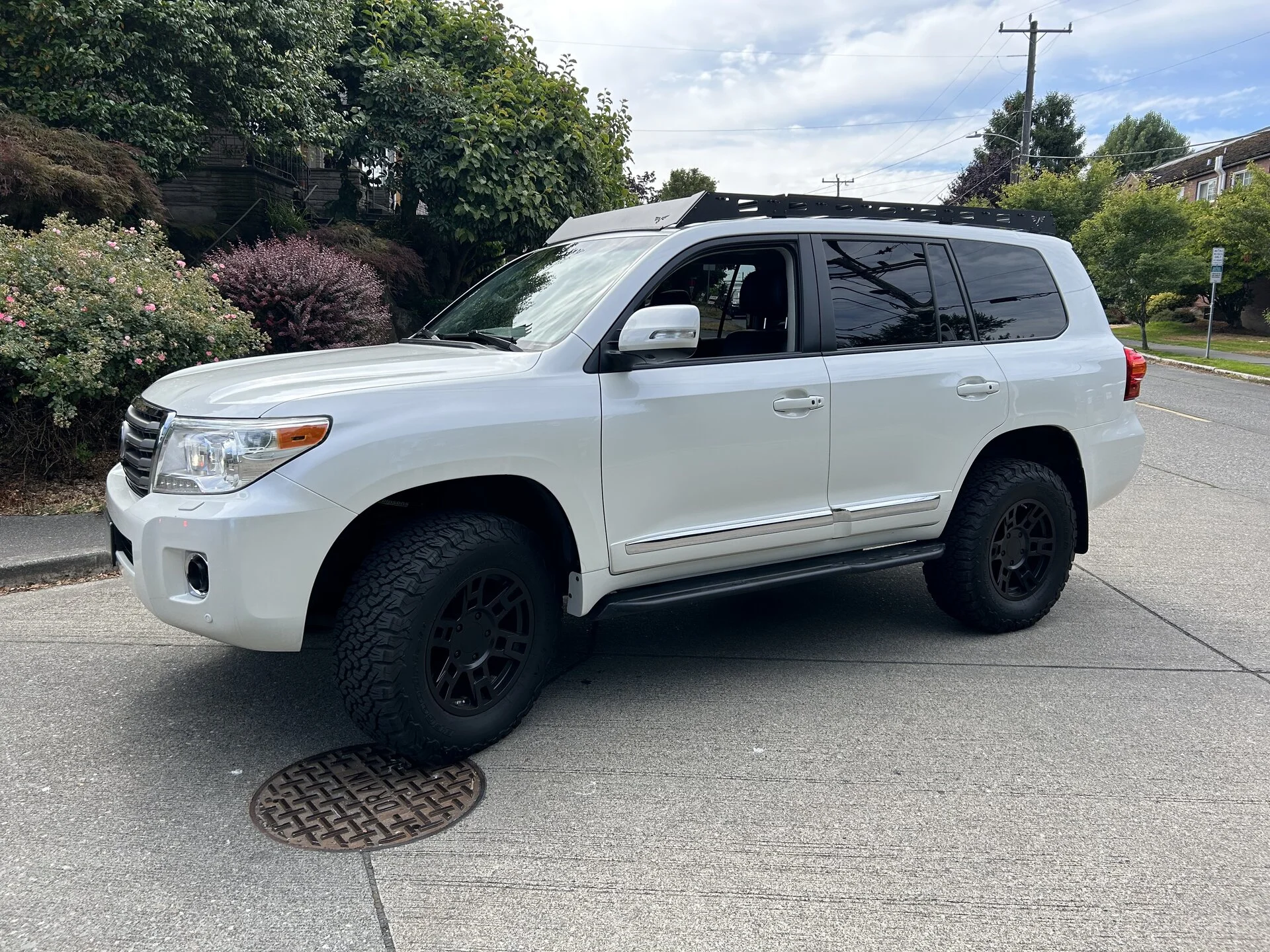

Thank you, they are the 116Q SL. I think they are a very nice ride and the road noise I very minimal. I took my dad for a ride to get his thoughts. He is very noise sensitvie. He also agreed that the ride quality was great and noise was very minimal and not noticeable if having a conversation or listening to the radio.View attachment 2336399
Looks good. Tire size and do you have a lift?
