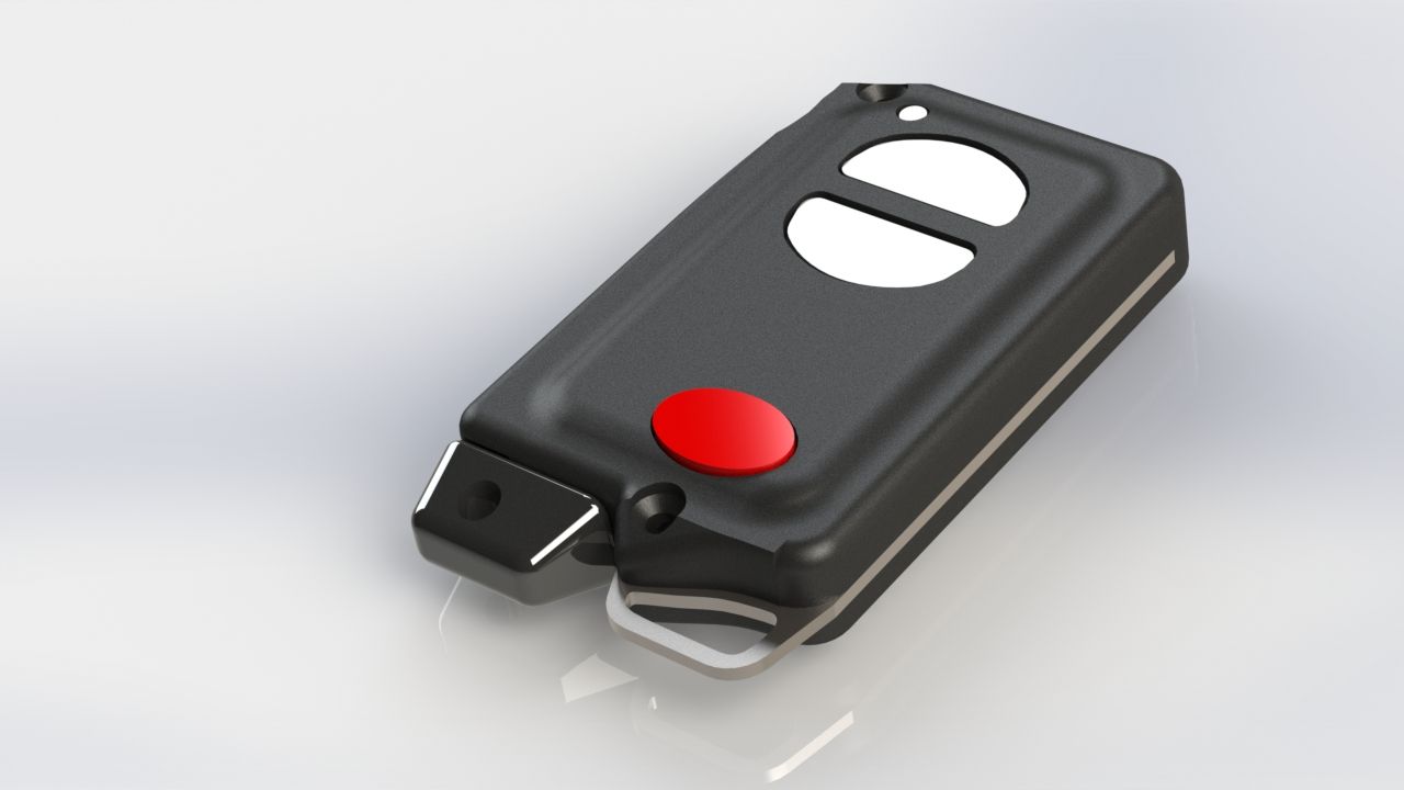

In the spirit of keeping info/updates flowing, here's the most recent render. Aesthetics are not 100% complete, but are close to done. Thoughts are appreciated. Note the PANIC button will be recessed more than the render leads on.

Now that looks much nicer to me than previous renders. Would you consider adding a radius to that sharp corner in the bottom of that picture, right above the key? It is hard to tell from that perspective, but it looks like there might be a similarly sharp corner at the top of the picture.
These are two locations that I'm referring to. Would you consider adding a radius to these locations? I just don't like sharp corners in my pocket.
The top location might not be an issue, I just can't tell from that perspective.
Absolutely, good eye. I was hoping nobody would notice the little remnants I hadn't tweaked yet!
Those will be rounded and aren't right now just because I ran out of time to troubleshoot SolidWorks refusal to let me radius them like I wanted. I need to go through and do some multi-radius fillets on those areas and I expect that to clean it up nicely. It'll all flow more seamlessly when I'm 100% done - I hope in the next 2 weeks since I've got business travel impending.
Latest printed version is in - black below. It's still showing the sharp corners from the render in post 162/165, but those are already fixed in CAD and will be reflected in the next print.
The button holes still need refinement (darn organic shapes are tough to match), but we're very, very close here. I'll do one more titanium revision, one more test print and then I'll move into trials with one or two folks to ensure I'm not missing some functional aspect and that fitment is solid on other remotes aside from my one tester.
