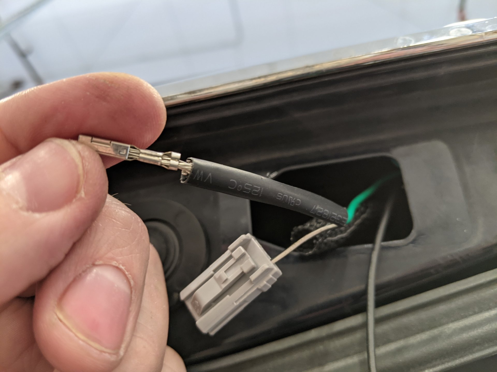

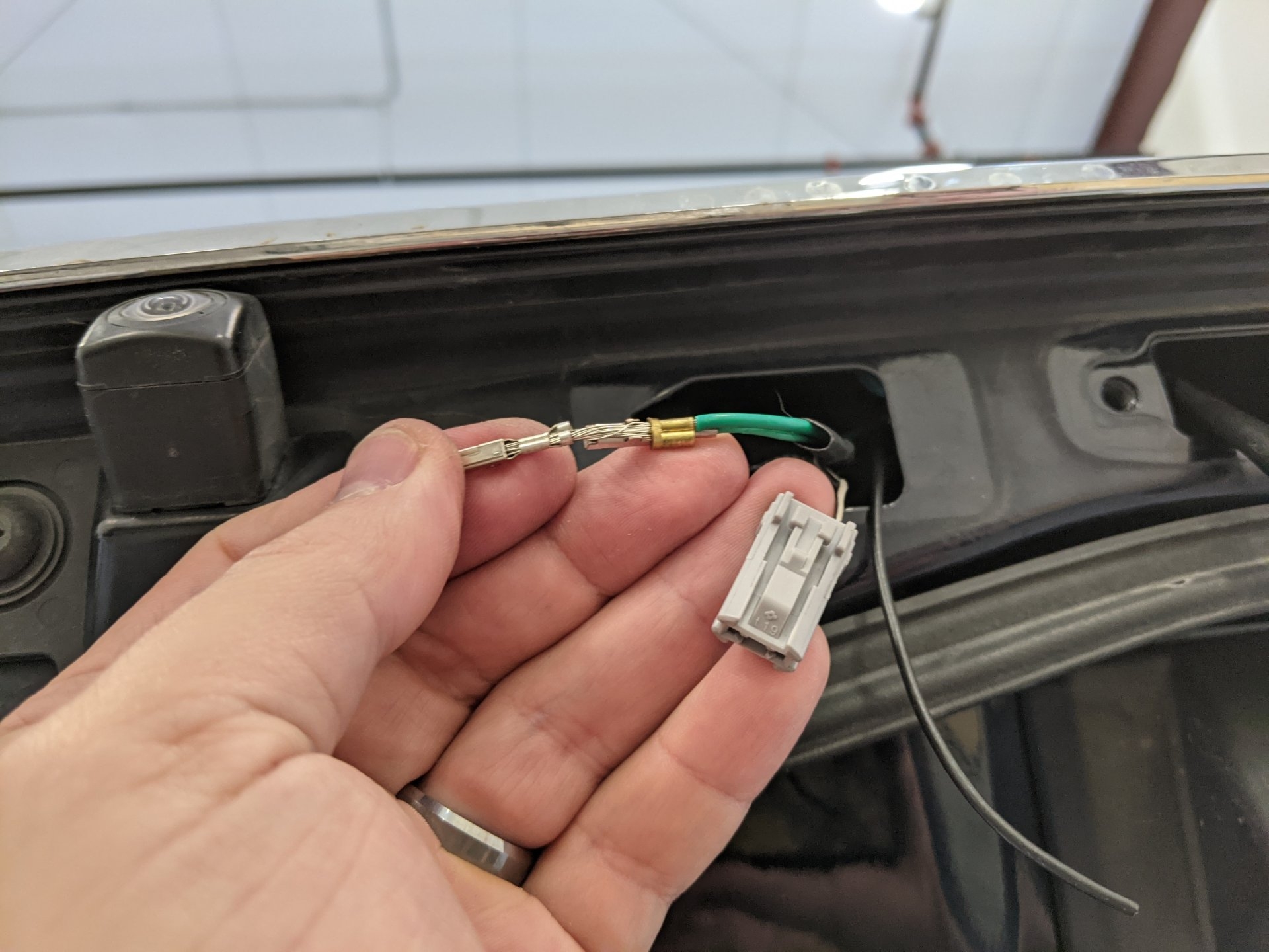

Thanks. We did the install without any patch harness, but I was able to avoid cutting the illumination wires by releasing the terminals and using an open barrel butt splice to crimp the neck onto the kit wire and then used a new 090 II terminal on the end of the kit wire.
The switch wires are a bear. Tiny gauge and not much space to work with the crimper.
