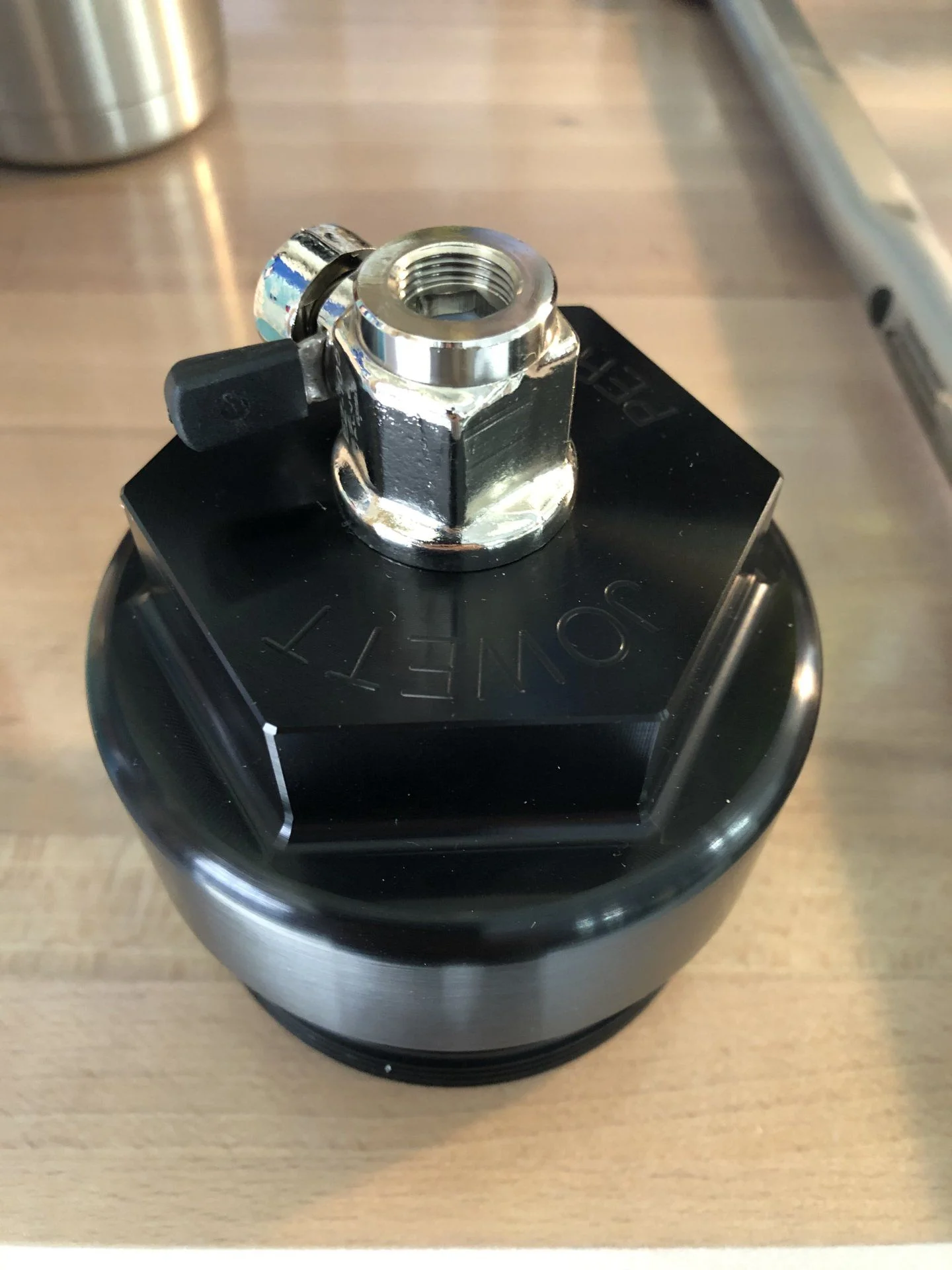

You may want to consider replacing it with an ez-valve.
There is also a oil filter cap with a ez-valve from (Jowlette?) Also worth every penny.
It does need a large socket to go with it.
Fisher23: Yup, that's a good investment, I ust got it: the Jowett Performance Oil Filter Cap. It has the EZ Drain valve on it and I'm sure is going to make things easy in the future. I ordered the large socket with it.
there is a hose nipple that goes with it .. so you can use a 3/8" fuel hose to direct the oil. He may have it , he didn't when I order mine but he gave the thread size and I got one off amazon.
Thanks for the tip, will do!
