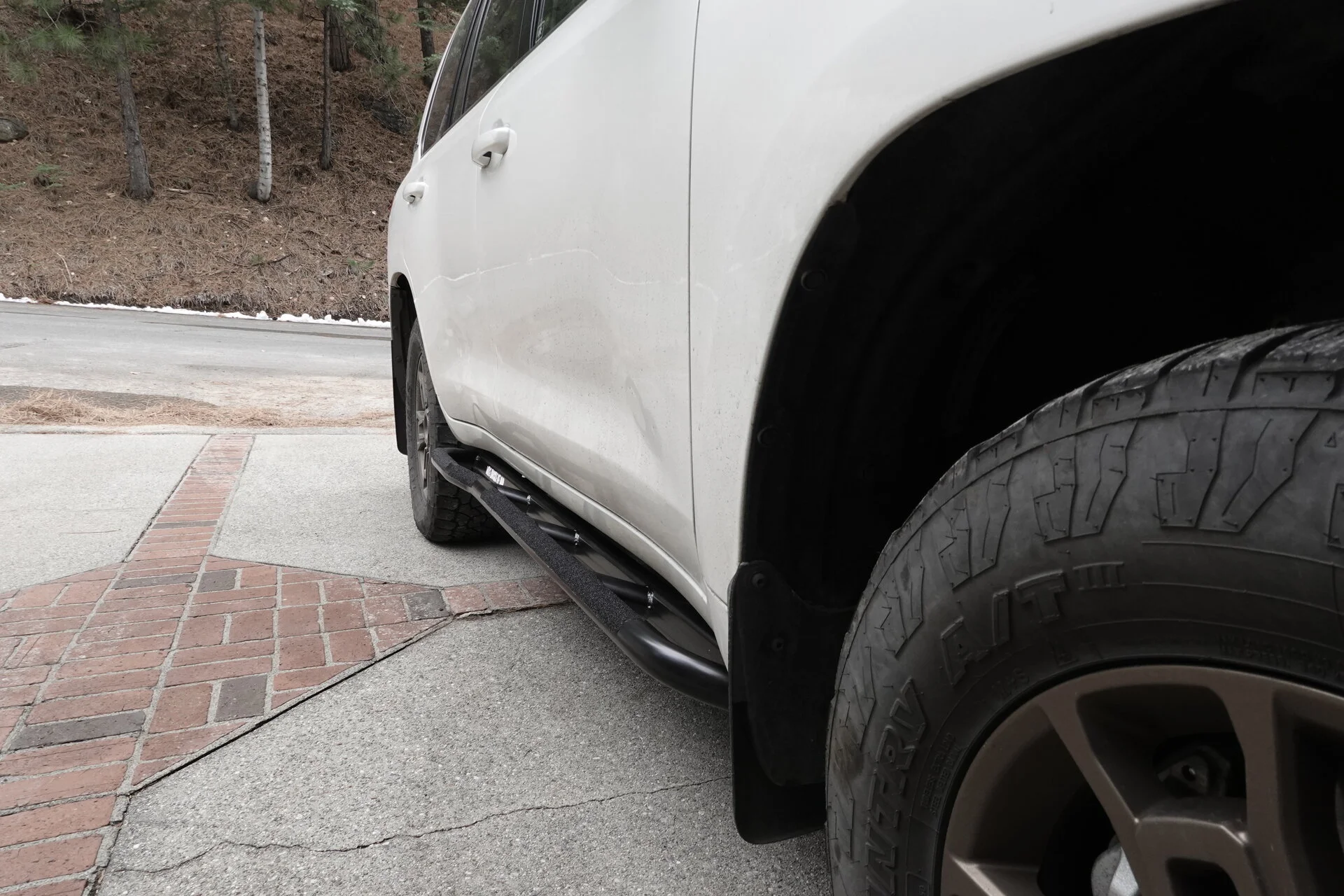

I ordered the tube step sliders from Slee on January 11 and received them in San Diego on January 20, which is lightening fast compared to ordering sliders and other components for this and my prior builds. (Hello, Gobi, are you listening?) And, hats off to the freight company. The card board box in which the sliders arrived was pristine and Slee did a great job packaging everything to protect the sliders.
I spent a good part of the weekend installing them by myself with a floor jack to position the sliders. If you plan to tackle this job: (1) Make sure you have a 17/32 drill bit before you start. I spent too many hours on Saturday driving to various stores looking for the drill bit, which is not carried at HD, Ace, HF, etc. and I was lucky to find one; (2) Don't hesitate to sharpen the bit as you go along. Had I done so, instead of waiting until the bit practically stopped cutting, I would have saved a lot of time; and (3) Use your phone or a tablet to look at the pictures in the instructions. The pictures in the printed instructions accompanying the sliders are too grainy, which makes it difficult to determine where to drill.
The sliders look like the stock running boards from a distance, which I like. They are lighter than OPOR sliders that I put on my old 4Runner and Demello sliders that I put on a Taco, but I do feel the added weight when I drive. I hope they are as strong as folks have reported on this board.

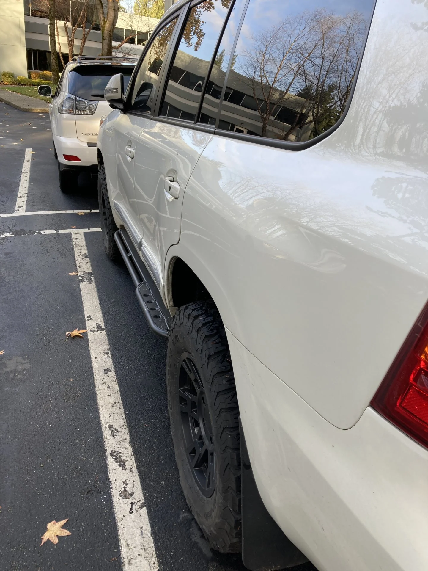

I went with WK angled with no plates. Looks great!!! Best decision for my needs and still very functional. Angle looks good and still is a good enough step. Debated a lot on the rear top plate and decided if I wanted it later it is very easy to add (can buy separate) with clamps, but if you get at the start and take it off you have welded brackets showing. Just FYI, I tried putting some anti slide step tape and then took that off because it was always catching the my calf when getting out of the LC. Kept the small piece on the back step part for now.

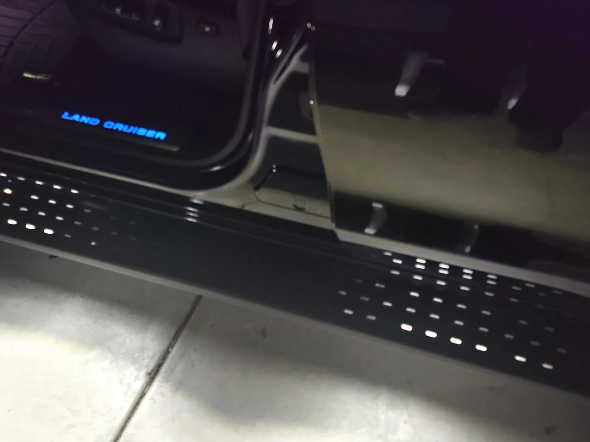

What's a good fuse to tap to trigger the LEDs under the sliders? From slee: The LED Light kit is wired into the existing circuit for the running board lights if vehicle is so equipped. The shop that installed my sliders used a source only triggered when the driver door is opened.
Does the LC200 come equipped with illuminated running boards?
Could be wrong but believe the LX had illuminated running boards and the LC did not.
