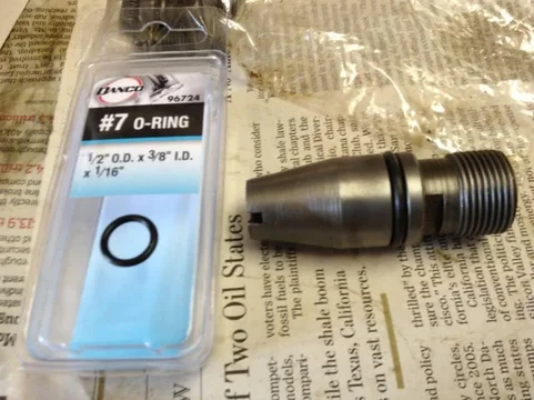

A speedo drive rebuild kit will have what you're looking for. There is a little o-ring inside as well that comes in the kit. The part # escapes me right now, but it is available thru Toyota.
2th - you are right, and the transfer rebuild kit has those parts in it, minus the o-ring (by mistake). Actually, the speedo housing, in my case, has room for TWO o-rings, side by side inside the housing. Really odd.
Anyone seen that before?

Here's the speedo housing that the two 3/8"x1/16" o-rings went in.
Speedo Housing
I'm going to play with it a bit but it looks like they both fit.

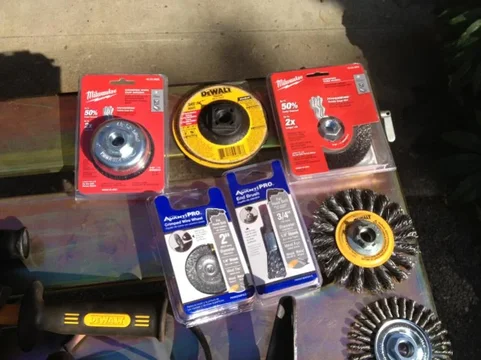

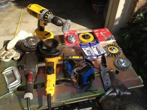

Here is my current arsenal of wire wheel attachments and tools.
Anyone got any suggestions to something that will speed things up?

I like flap discs for grinding down welds and rivets. You can get them in any where from 36 to 120 grit. Also, Harbor Freight has there 50 lb glass media on sale til the end of May , with a 20% off coupon its $37 I believe.
Curious how do the twisted wire wheels work compared to the non twisted?

The twisted ones are some serious stuff. They last a lot longer and take off the tough stuff. I'd only use them on non-body panels though - they can gouge.
I really like the 1/4 in. arbor pneumatic die grinders, both straight and 90 degree, because they are a bit more manageable than a cordless drill. If you have a largish compressor they are nice to have. A/c units are available too. The Fordem flex shaft tool is nice. It's like a dremel on steroids. Flap discs and those crazy abrasive pumice sponge thingeys like that one TCSTARK has up there^^^^are good for flat stuff like body panels. These things can add up but pneumatic tools can be found pretty inexpensively on ebay and easily rebuilt if you get good ones.

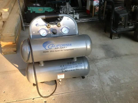

I have a 6CFM-ish dual tank California Air Tools compressor. Good enough for plasma cutter but is it enough to run pneumatic tools?

I bet that compressor would work. If it cycles too much, big tank compressors are cheap on CL all the time around here. You would need something bigger if you want to do any HPLV painting anyway.

For a 4.5" angle grinder these work the fastest by far -
http://www.fastenal.com/web/product...lckqRhpX34LNQGWxhm2vxTq!-799979082!1119852750
http://www.pferdusa.com/products/208c/208c03/208c0302.html
Both of these brushes are designed for very fast removal and require almost no pressure on the tool - be careful as you can damage body panels quickly but they will easily go through any coating ever applied to the sheetmetal including rubber products . Just a note about that - don't ever expect complete results from blasting - anything rubber or silicone that is soft will not be removed unless using a very aggressive media . You must also consider media types on panels that will be painted as they can leave a pretty porous surface finish . Glass bead or Soda is the best choice and for large stuff leave it to a pro shop - money well spent .
For air , no small compressor will keep up with any decent sized blaster - takes at least a good quality 5hp/80gal unit to keep up . Got an old Speedaire here for free - just had to haul it away and build a new set of legs , had it now for 12 or so years and never a hiccup . Newer compressors , unless you really spend the coin for a good one are a joke at best . CFM ratings are seriously exaggerated compared to the older units . You need at least 15+cfm to keep up with any decent blaster , cabinet type or otherwise . I use a pressure-pot type from TSC which is good as well as an old cabinet I got used (Snap-On) . The amount of work you ever plan on doing is how I guage what to invest in equipment - everything I own has paid for itself several times over easily .
