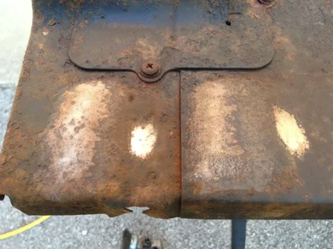

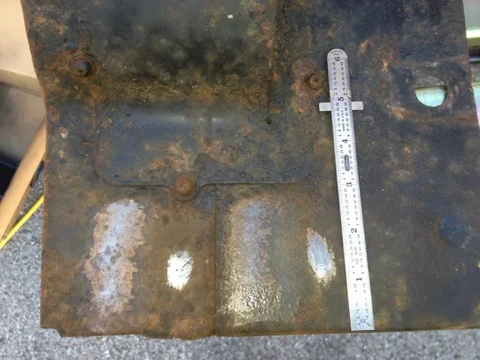

So I did a quick test for "all y'all" to see the diff in the cupped wheels and the twisted wire flat wheels. I don't have a twisted wire cup (that fits - accidentally got a Dewalt brush with the metric nut), so I'm sure the twisted cup would cut faster.
I did a 5 second stripe on a work piece with both the horizontal angle and the vertical angle.
Cup cuts are on the left, wheel right.
Left cut on each pair is horizontal (ie cup wires pointing toward the work). Small cut on the right is at a vertical (90 degree to the work surface) angle. With the cup, it's not quite a 90 degree angle, something like 60 degrees.
The cup is my preferred wheel right now. It works faster on large surfaces, and is more forgiving when you catch an edge. It won't cut really rusty stuff if you hold it flat, but turn it at an angle and it cuts very well. If it was just paint, holding it flat would work very fast. The wheel cuts deeper and faster at an angle, but it cuts a smaller path and takes longer to cover the work piece.
If someone has a twisted cup, compare it to the other types. Show some sample cuts if you can.

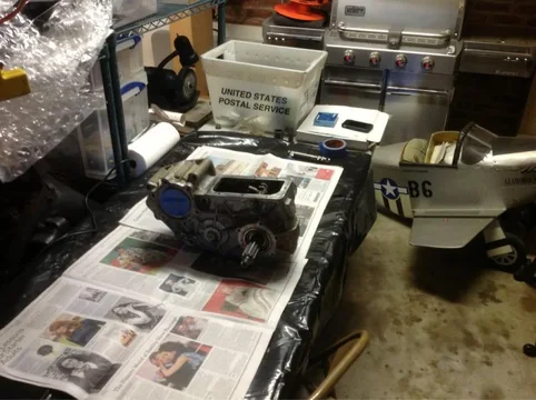

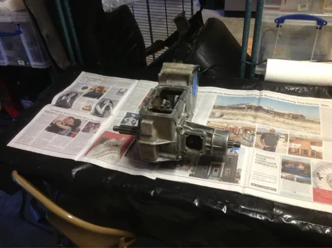

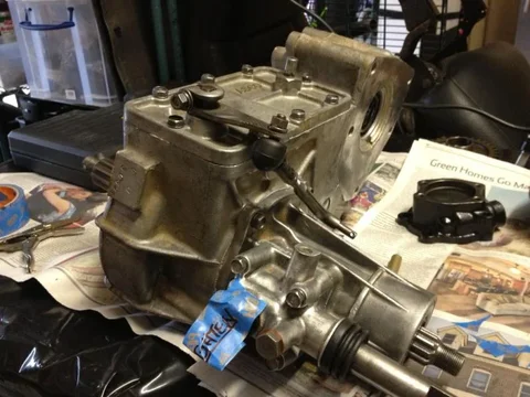

Last few days didn't show a lot of progress, but I find I'm enjoying the slow methodical build. I'm wire wheeling every bolt and part inside the tcase to get all the grime and rust off. Heck, I'm just having fun getting it really clean and putting back together right. T-case is close. Got the shift knob and housing cleaned up and reattached, now just need to do the e-brake assy cleanup & rebuild, and do the seal on the output shaft, and determine proper pre-load on the bearings.
Before cleaning.

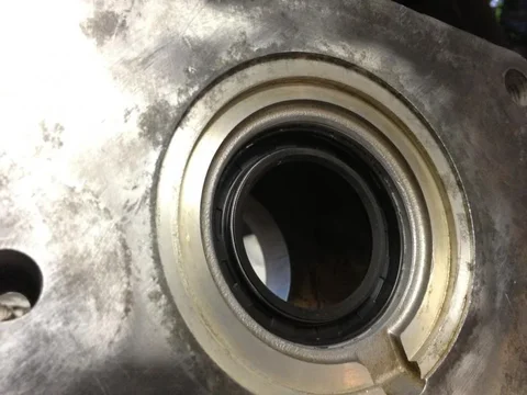

Transmission Seal - it goes on "backwards"

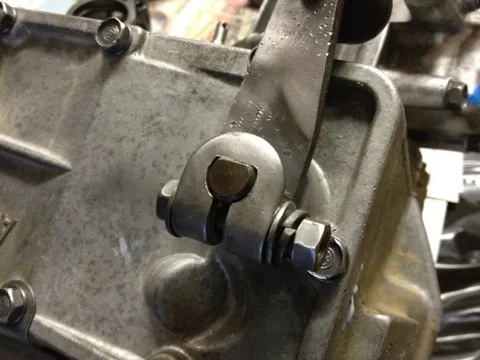

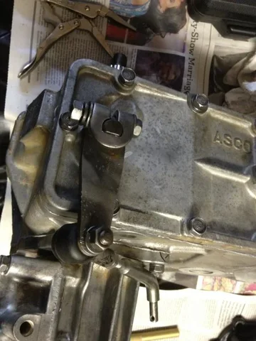

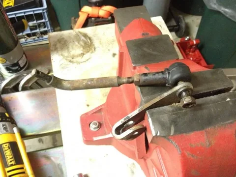

Note the flat connector piece that attaches to the shifter shaft coming out of the case - it is bent (or it it supposed to be that shape?).
Close up

Does your kit have 2 rubber and one metal lipped seal, or 2 metal and one rubber?
Very good. I should have worked a bit more on the case. I may do a bit more once I get it finished and can cover up the holes. Not essential but my OCD kicks in....
I haven't looked through it closely yet. And, I'm out of town this week.

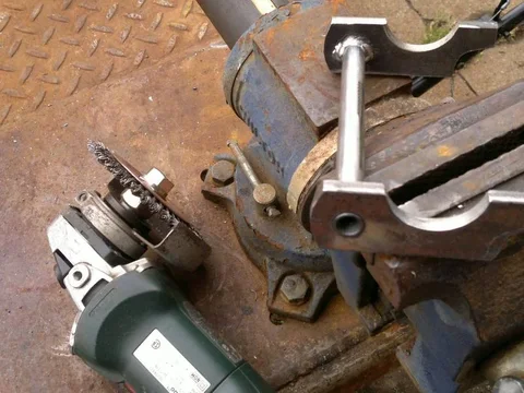

Here's the dually stringer brush - narrow and gnarly ....
Use these with only light pressure as they will eat into metal easily . Once it stops cutting efficiently , just flip it over and keep going . Just watch out for clothing or anything they can catch - some grinders just don't know when to stop .
Gloves are a must , too .
Sarge
Sarge
Ok, I looked through my kit this morning and I have 2 rubber seals and 1 metal. However, I bought a 3 speed rebuild kit.
