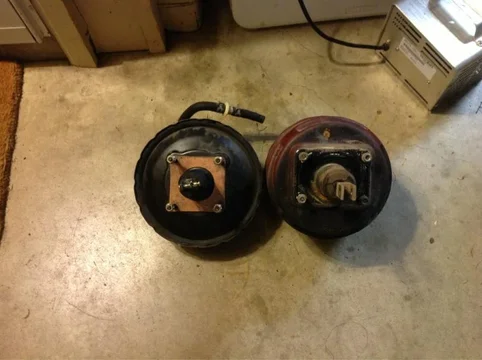

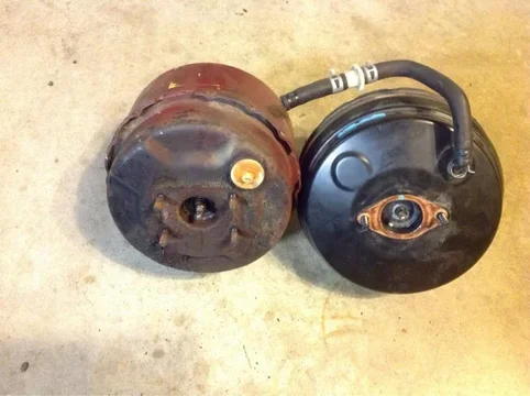

Thought I'd remove the old brake booster and put in my snazzy new PullAPart find from yesterday. I pulled a 95 Camry for $28. It was mint. So mint in fact that it did not fit.
One of these things is not like the other. Didn't notice the difference until I tried to put it in.
:doh:
Sigh. Back to the PaP.

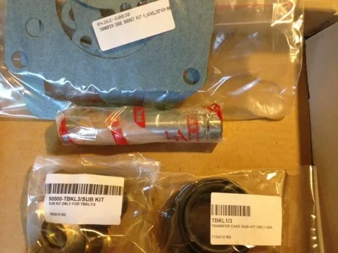

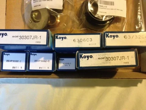

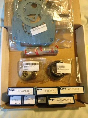

Bought the transfer case refurb kit $175. Has gaskets and 3-4 seals in it. Also bought the pinion seals for the diffs.

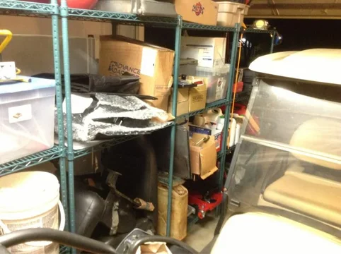

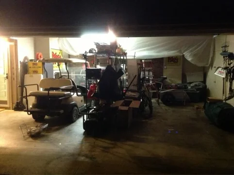

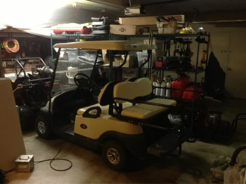

If it had not rained Saturday, I would have started on the transfer case rebuild. In reality, I needed to clean the barn out of 10 years of restaurant parts, POS systems, furniture, and a bunch of my tools. There is still a room full of kids bikes that need to be moved but I got it all organized. Loosing all that precious storage for a new pool and pool house.
Recognize any of this stuff? It might have been yours! The first 3 racks are FJ40 stuff only.
Best news is that my wife has agreed that the next structure we will build is a garage/workshop for me. She is tired of parking outside while I park all the projects inside. Right now, as I counted today, we have 8 vehicles for 3 drivers out of 5 in the house. Mind you, one is a diesel Gator that is 10 years old, but looks brand new due to being barn kept, one is a golf cart (gift from father in law - we don't even golf but helps us get around the farm) and one is a dune buggy we bought last Christmas (2011) that did not get driven, so that will be sold soon. The MINI Cooper is going soon too. Suddenly everyone loves the MINI even though my wife scoffed at it for years my wife and my kids won't ride in it.

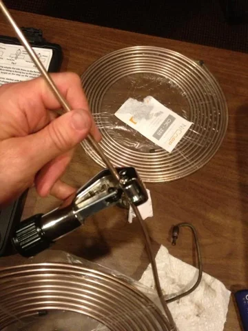

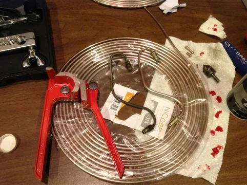

And for my tech, I'm making my first brake line piece. Starting small. Plus it's 11:50 and I need to go to bed.
Well, there ya go. Lessons learned: NiCopp is not *that* easy to bend by hand. Tube benders are not for short lines. Making sure the line is cut square is vital, else you get wonky shapes. Make sure the exposed end is not longer than the step in the adapter when placing in the die block, else you get kinked edges (which I'm sure will leak). Cut your tube a bit longer (2-3") so you can redo ends if you goof. Putting a drop of oil on the adapter for the first press seems to help, and again on the second press, seems to help. Oh, and last lesson, the die block has some sharp edges.

Did you ever find a booster VV?
There is one in classifieds for 40$ right now. "(MN) early FJ40 parts" is the thread. Comes with a master cyl.
Sorry I can't link here. I'm on iPad.
Fish, I did. I ended up going with a reman for an '84 4Runner ($120). I found that my booster has brake fluid in it (it sloshes), and that you cannot find old enough vehicles at the PullAPart places to get the proper bolt pattern. The oldest with the correct bolt pattern is the 95(? I think) 4Runner or FJ62 (up to 98). The former is hard to find at a yard not already picked over, and the latter just doesn't exist. I wanted something that if it failed, I'd know what to get, and would already have the linkages sorted out.
I was leery of a 30+ year old set of diaphragms for what I consider a key safety component of the vehicle. That said, I've not installed it yet, so we will see. I started a thread called "1976 - 1980 FJ40 Brake Booster Replacement List" with a bunch of cross reference data in it for vehicles that have the same bolt pattern.
