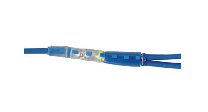

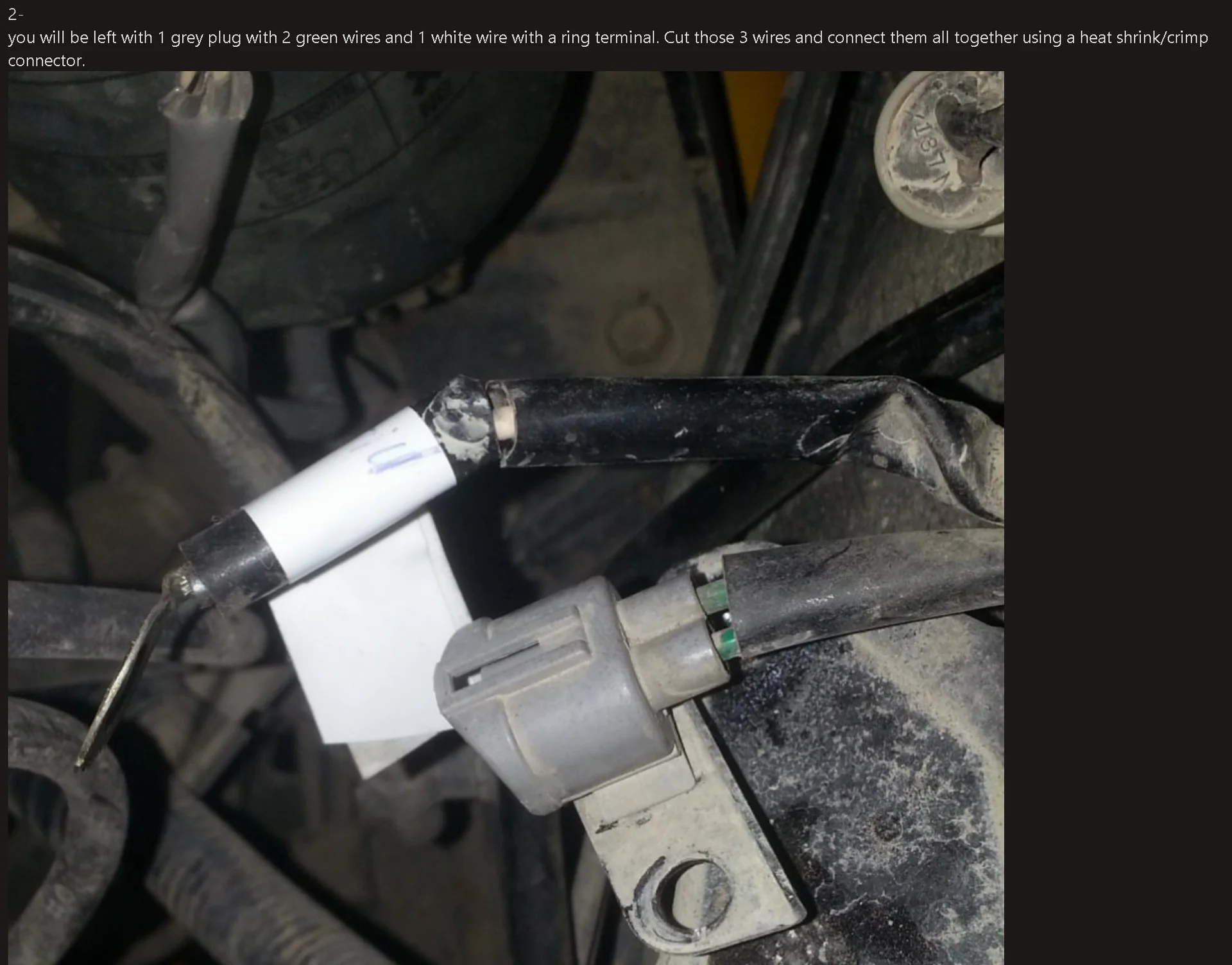

I used a 3way heat shrink butt connector similar to this.
I don't know what those three wires are, but it sounds like this serves as a functional connection?

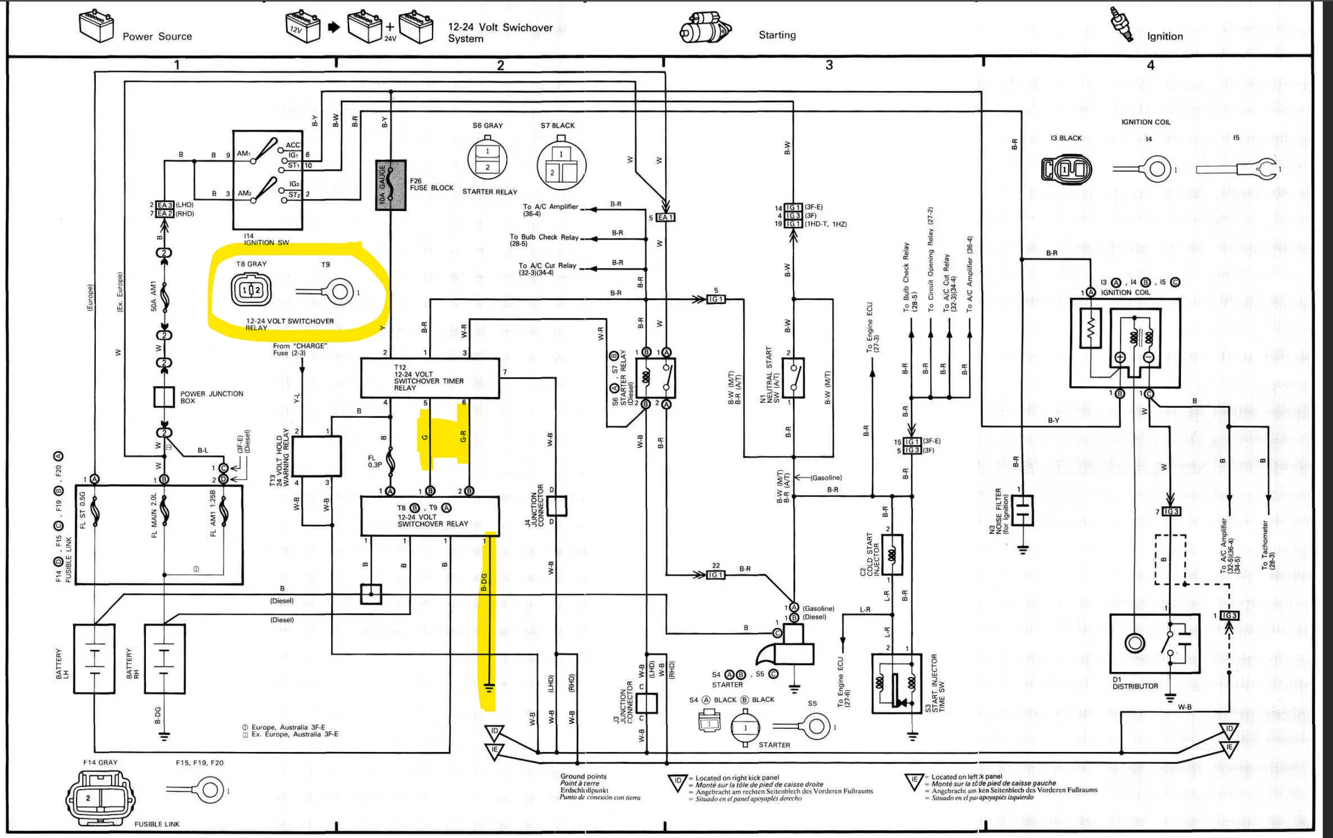

Just got back (I was overseas) to my 80 after it sat for a year with starting issues. replaced the 24v starter with a 12v. didn't do any of the fancy isolation or switching. But now I've got a small solenoid to on a momentary switch because when we put those 2 green, 1 white wire together we got nothing.
I want to unfrankenstein this thing after I get the rest of the tlc maintenance done, but neither my father or I understand properly where power from ignition is coming or going.
Are those 3 wires power from ignition?
Do they connect down to the small negative post on the starter?
I have the old 24v starter relay and starter timer relay still in place, but they are buried behind my webasto. Are they interfering?

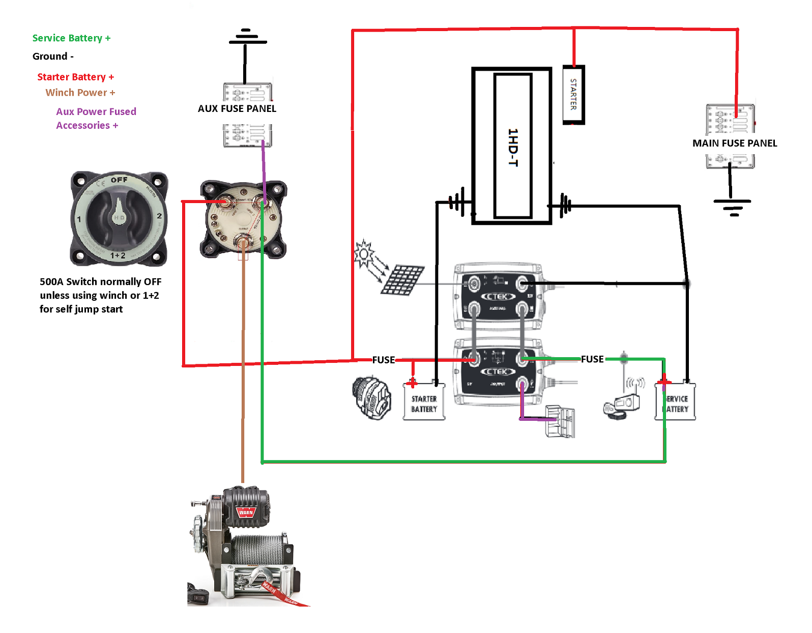

Excuse my chicken scratch but I wanted to share a diagram of what have come up with.

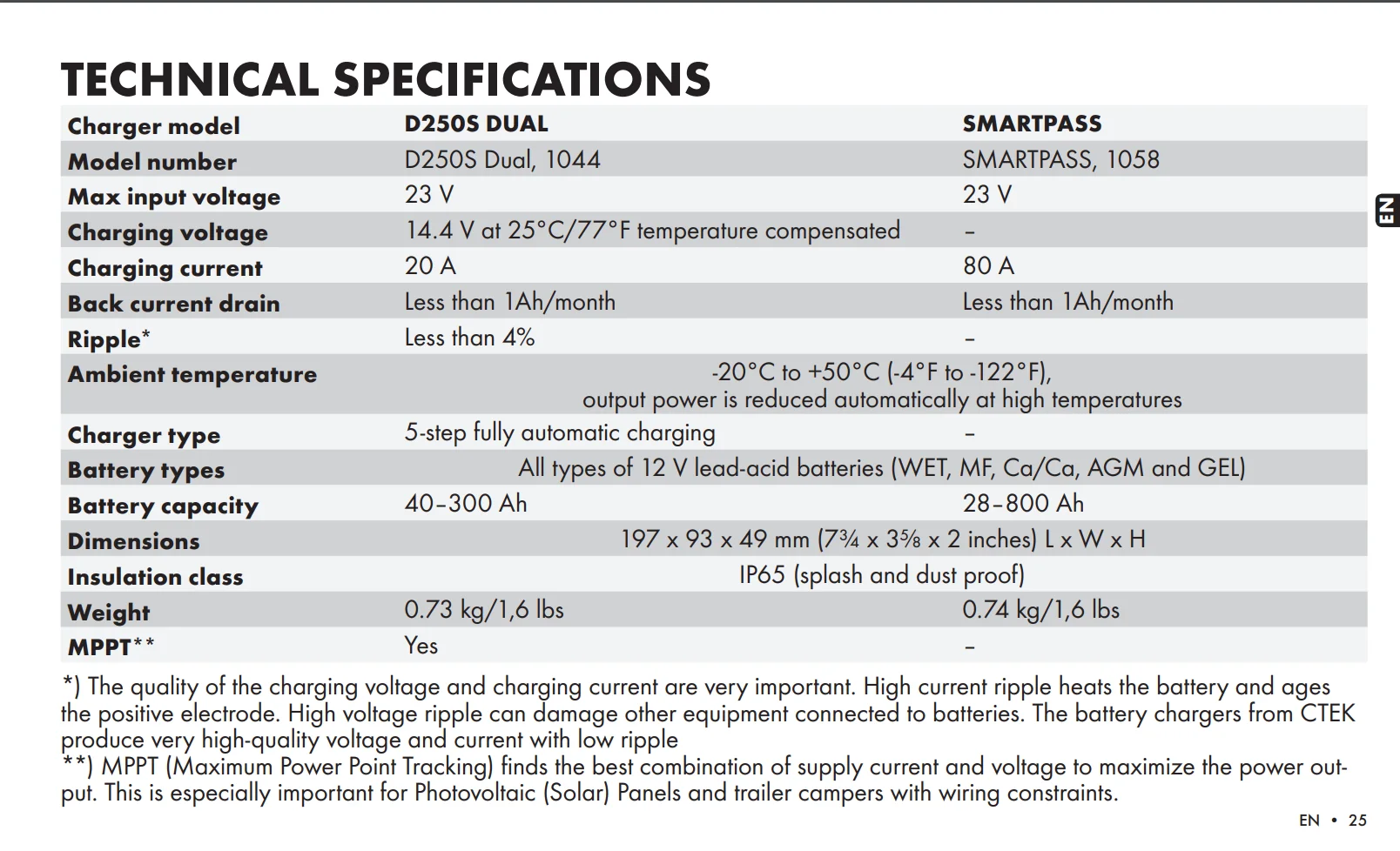

I have a CTEK D250S Dual + SMARTPASS
I'm thinking of adding a couple of solar panels 2x 175W MPPT as the ctek has its own MPPT charge controller built in.
I have added a switch so I can self jump-start myself and enable winching.
my idea is to have the switch in the off position and if I need to select 1+2 to self-jump start or both batteries for winching
switch set to 1 will be the main battery and winch
switch set to 2 will be aux battery and winch

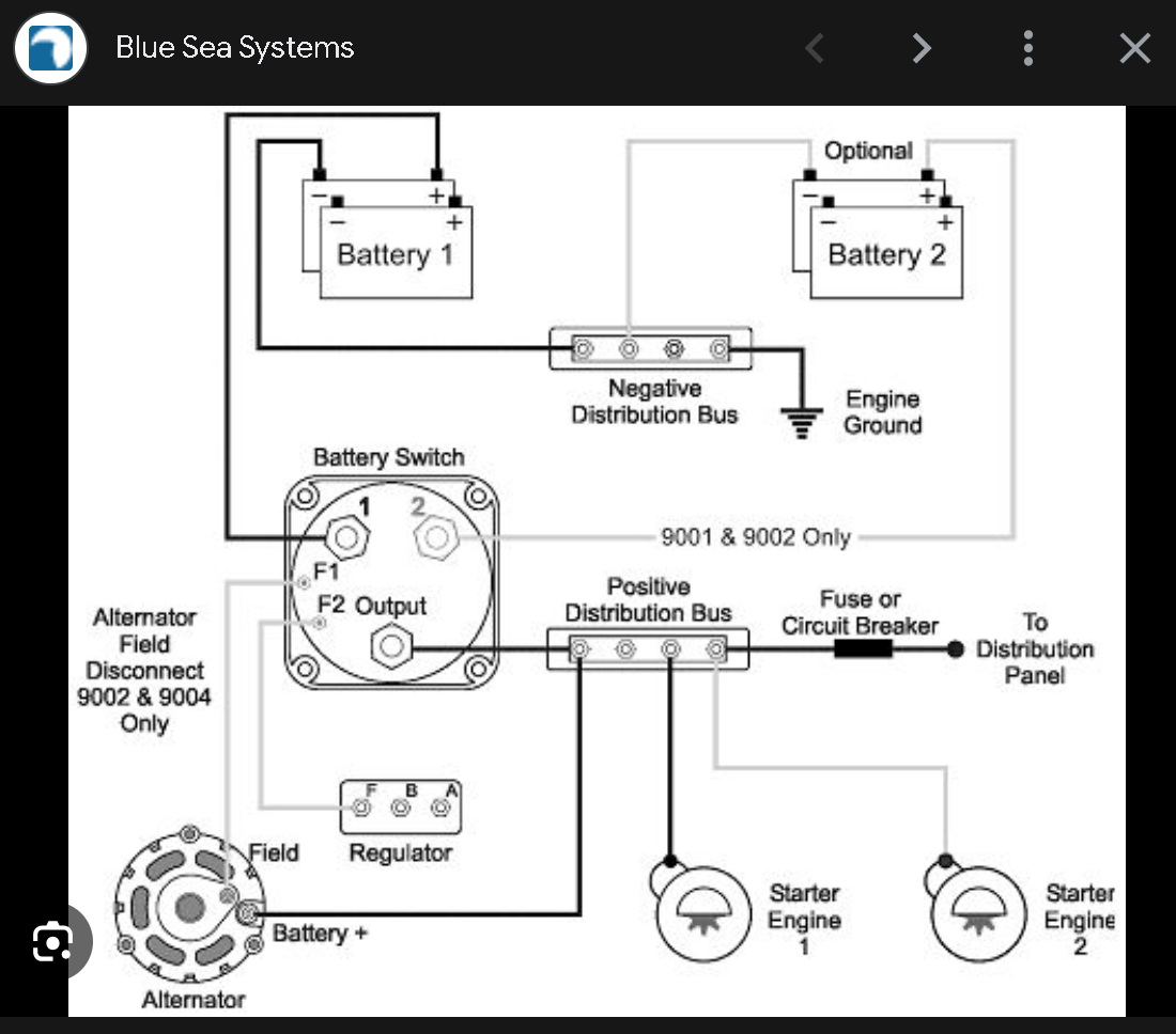

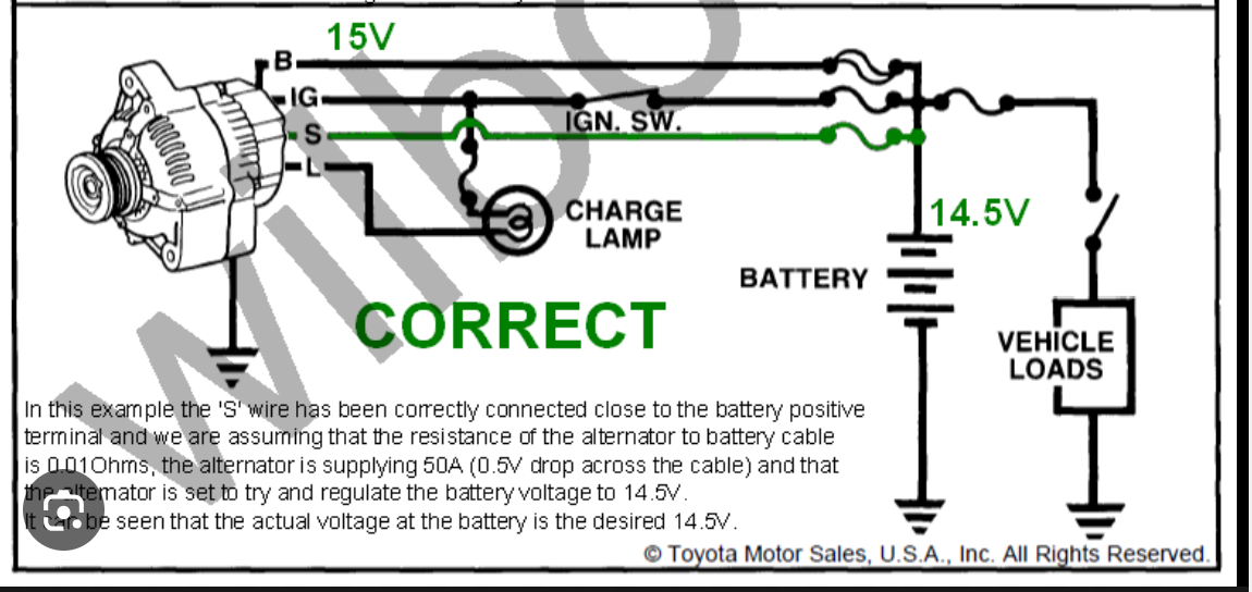

Hi guys I have a question about wiring up the "alternator field disconnect to the Battery switch" here is the diagram by blue sea.
i was wondering which alternator wire do i use if i want to use this feature?
would it be the IG wire or the S - Sence wire on the toyota Denso alternator
there's no F - Field terminal so I'm guessing IG - Ignition because that wire turns on and off the regulator. but I just want to be sure.

i have a question guys, im redoing the wiring in my truck and i have noticed that i don't have these wires connected together but my 12V starting is working
am i missing something what is the purpose of connecting these 3 wires together?
my old thread here of what I have done
but I think connecting the 3 wires (white + 2 green wires) together goes to the ground according to EWD
please correct me if I'm wrong I have highlighted in yellow.
