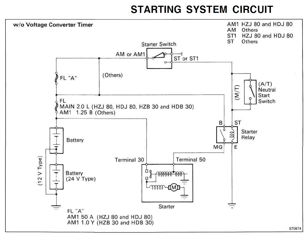

I am trying to make sense of this EWD on how to make this conversion work and how to wire it up for 12volt starting.

Items to be deleted from the posted EWD below:
  • Voltage Converter Timer
  • Voltage Converter Relay
  • 24v Hold Warning Relay
I have been reading other posts here on mud on how to wire this I cannot make sense to how its supposed to work without a EWD so please correct me if I am wrong.
  1. Battery Positive goes to starter Terminal 30
  2. Starter Relay has to go to ground for the ignition switch to activate the starter. I am guessing ground goes to terminal "E"
  3. Starter Relay Terminal "B" Also goes to a 12v battery +
  4. To Alternator "L" goes to - Ground
  5. IG1 goes where?
Yep, from what I recall you have all of that right.
You'll have to cut out and ground the Terminal E wire from the starter relay located on the LHS fender. I just extended it to the starter relay mounting bolt with a ring terminal. One other item to note is that the wire that feeds starter terminal B is already located near the LHS battery (I believe it is a green fusible link) - this is also somehow tied to the voltage sensing for the alternator and therefore needs to be connected to the main battery that is charged by the alternator.
ok so To Alternator Terminal L goes directly to + of main battery.

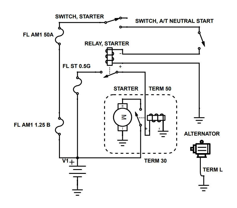

And here is the revised wire diagram. Please excuse my chicken scratch.
I have deleted the following from the diagram
  1. Voltage Converter Timer
  2. Voltage Converter Relay
  3. 24v hold warning relay
  • Alternator Terminal "L" goes to ground
  • Starter Relay "E" goes to ground
  • Starter Terminal 30 goes to + of battery
Where does wire from Starter Switch IG1 "2" from voltage converter timer go once the "Voltage converter timer" has been deleted?

Made a diagram to help me understand the necessary changes. This is how I interpreted the final circuit to look (liberties taken where I didn't have correct symbols, also Im no EE). This look about right to anyone?
Plan is to just use the DS battery for now so I can get it on the road, and take the time later to OCD a dual battery setup. Im a little concerned that '0.5' (assuming green) fusible link is not appropriate for 12v but I'll probably leave it be. Worst case is it burns out faster and I need to take the time to select a bigger one.

Its very similar to the FSM diagram w/o the converter, so thats gotta be a good sign.
** Edit **
Hey Dan do you happen to know where the "FL ST 0.5g" fusible link is? I've got a tricky no start issue going on and I know it has to do with the power being fed to the white wire going to "b" on the starter Relay.
@DancesWithMutts I wish I could remember exactly, but I believe its a green fusible link near the passenger side battery.
All good man, I think I found the problem I'm having. Thanks!
