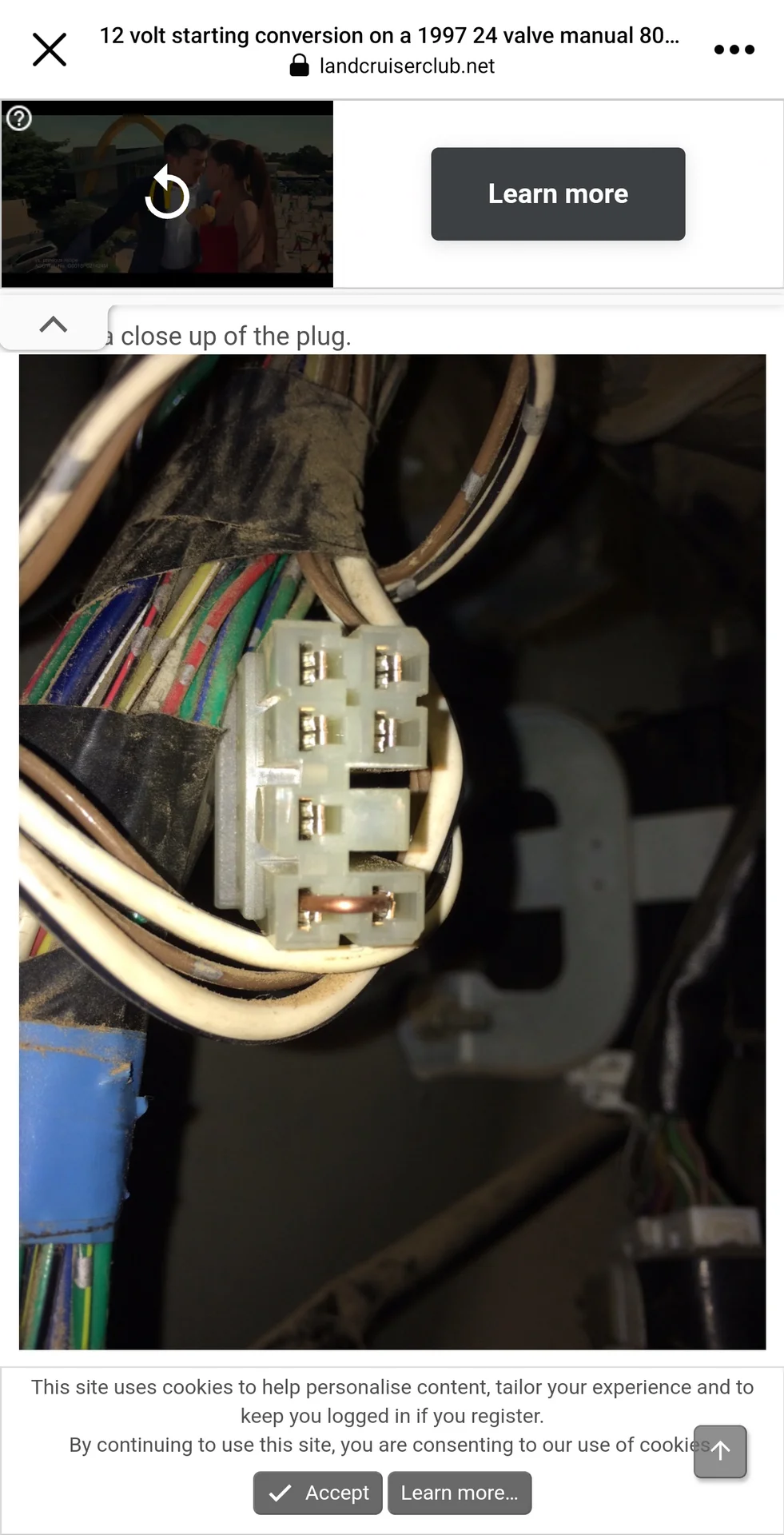

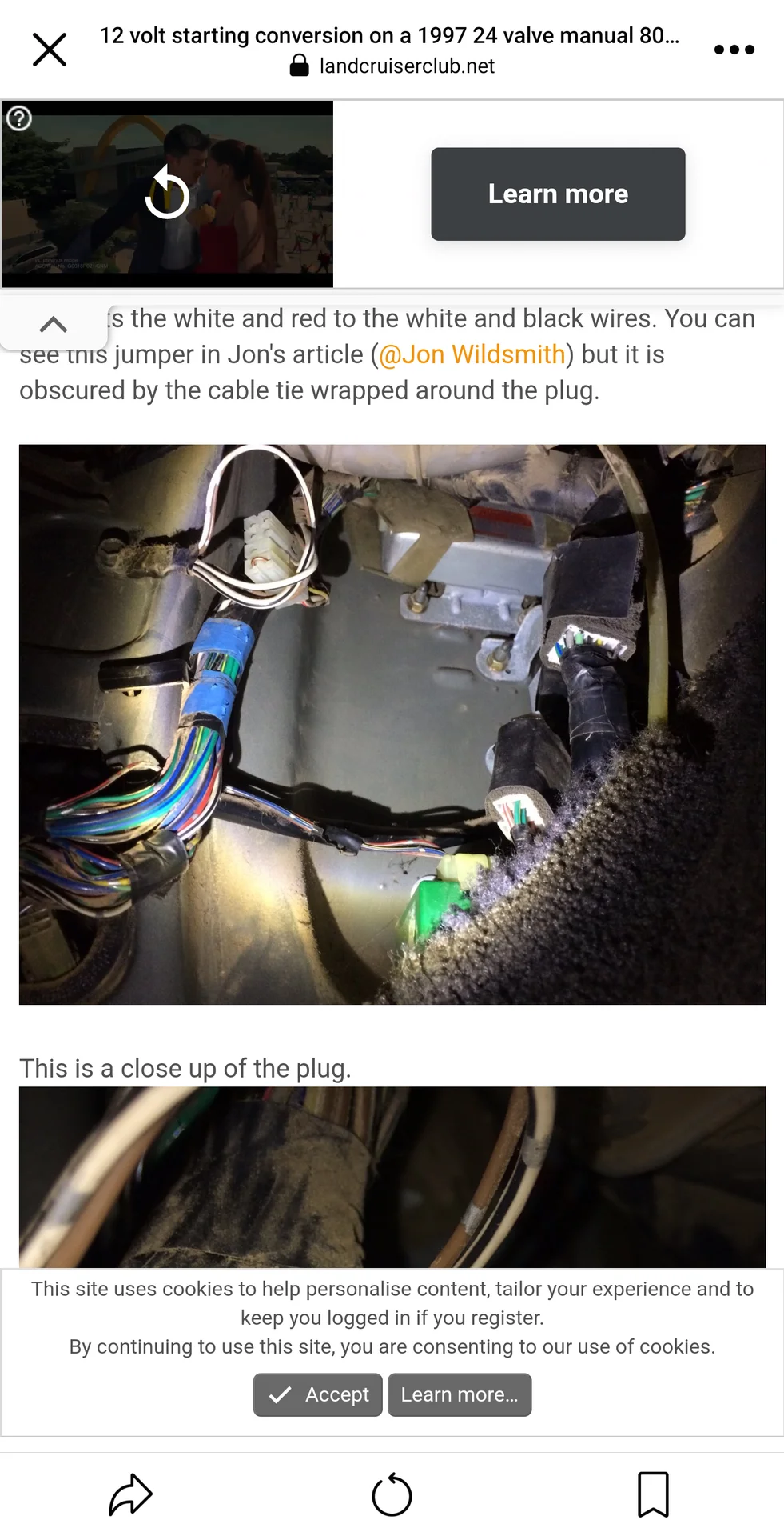

Hi I'm trying to figure out what these 3 wires do being connected when removing the 24V starter
my 24v starter is removed and the 3 wires are not connected to anything I haven't noticed anything odd unless I'm missing something or its wired differently somehow
If understood correctly from another thread those are the for the switching relay timing solenoid, that's why you need to wire them like that to bypass it, because the switching relay has to be removed. If not then you will have to unplug the timing relay in the kick panel and jump the 2 wires.

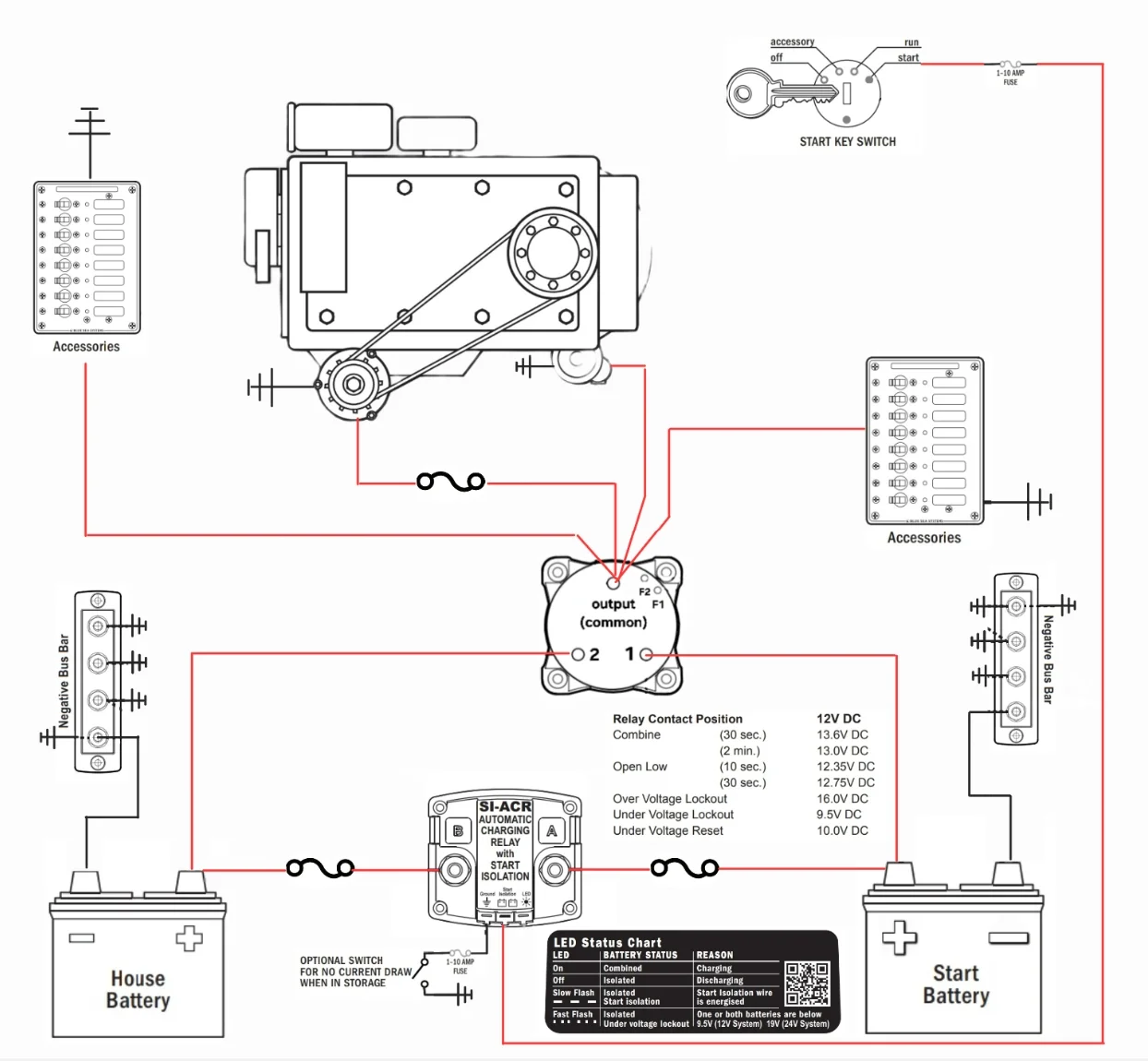

On that note, I put together a diagram of what I would like my system to be. Appreciate if you legends can opine. 1993 1HDT HDJ81 converted to LHD A442F. Already replaced the alternator, got one from a fj (at least that's what the seller said) just changed the pulley and rewire the plug to the round one. I also got a 12v starter. Just finalizing the design / diagram to see what else to buy.
Saw a post from Dave on that other forum, I'm planning to go a similar way with the blue sea systems automatic charging relay and a 4 position switch to be able to choose what battery to start from or self jump (combine) if needed (I think in my diagram is designed that way, please correct me if wrong)
Here is the diagram appreciate the feedback, special on where to connect the alternator + or if there any more efficient way to wire this around. I'm planning to go the way to jump the wires in the timing solenoid instead of joining the 3 wires as mentioned in this thread (if that's correct).
Or
I understand alternator direct to house battery will have less voltage drops as is a shorter distance
Planning to use 35mm² wire with a 150 amps ANL fuses for the ACR.
Last question, do I need a fuse coming out from alternator? Stock 24v starter goes unfused up to the switch start relay, not sure if there is some protection elsewhere.
Cheers!

Howdy all, I am now in the middle of this project on my 97 1HD-FT and looking for a quick bit of guidance. I have the old 24v wiring out along with the 24v starter. I have one additional grey plug compared to step 2 in the OP, picture below for reference. It has two cables, one black/white and one red/white, and they are taped together with the plug going to the fuel filter. Any idea what these may be and if I need to do something with them? Picture below for reference if it helps. I am asking about the plug my thumb is touching as shown.
Thanks!
Disregard above note, I believe the 3rd plug I was asking about is for the fuel heater, but my truck does not have one. The connector itself is gunked up pretty bad and clearly has not been connected to anything in a very long time.

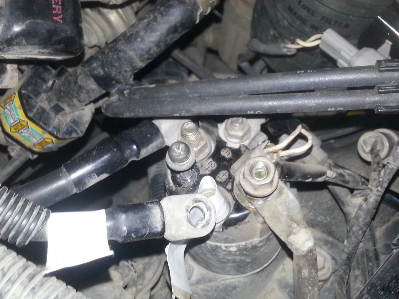

12V STARTER SWAP
The current 24v starting worked great but the need to have an isolated house battery and the safety factor of being able to self jump-start indicated the needed swap. I kept the driver side battery as the Main (start) and the passenger side as the House (aux).
1-
Disconnect and remove all wires attached to the the 24v starter solenoid located behind the passenger side battery.
Remove the starter solenoid.
20160206_101419-jpg.1208145
2-
you will be left with 1 grey plug with 2 green wires and 1 white wire with a ring terminal. Cut those 3 wires and connect them all together using a heat shrink/crimp connector.
20160206_104344-jpg.1208143
3-
Disconnect the starter+ and the small negative connector from the starter. Remove the original starter and replace with 12v version. Connect the negative connector just like the original and run a new cable from starter+ to Main+. (I used 2/0 welding cable for almost all my connections as it was free.)
4-
Ground both batteries to existing body and engine grounds
5-
Connect Main+ to Battery Isolator(I used Battery Doctor 150amp), Battery Isolator to 150amp fuse, Fuse to House+
6-
you will be left with this wire originally connected to passenger side+. Use a heat shrink butt connector and extend it to the Main+ post
20160206_104729-jpg.1208158
7-
make a new wire from alternator to Main+
I think that's it...
