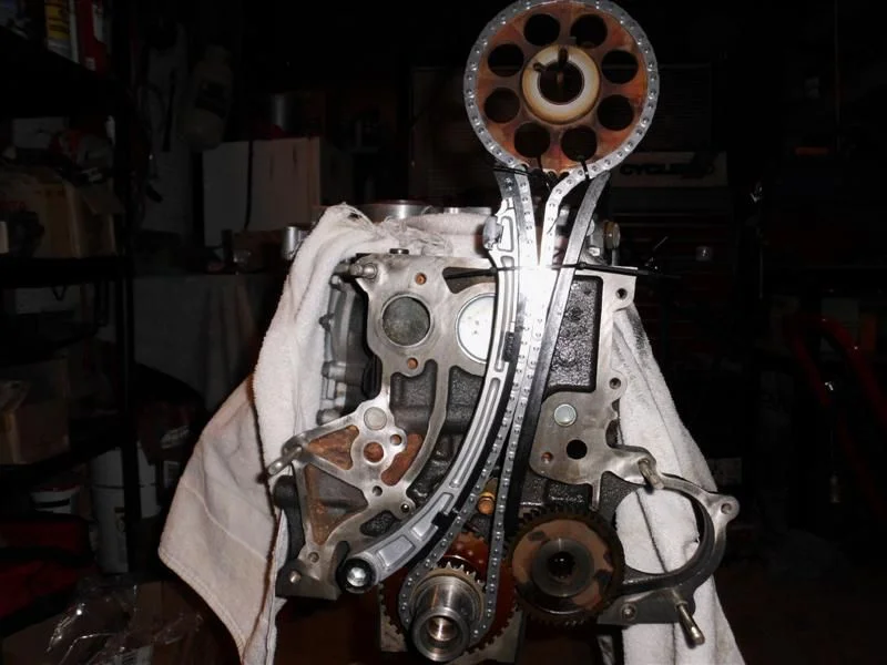

Anyone want to remind me what size torx bolt to get for the oil pump cover so i don't have to search? :D
Also on a serious note, the FSM does not show which way to orient the oil pump gear (i guess you would call it the orbital gear that moves around the center stationary gear)? I ASSumed that since there is a mark on the underside of the oil pump drive gear that the orbital gear would also orient the arrow on the lower side?

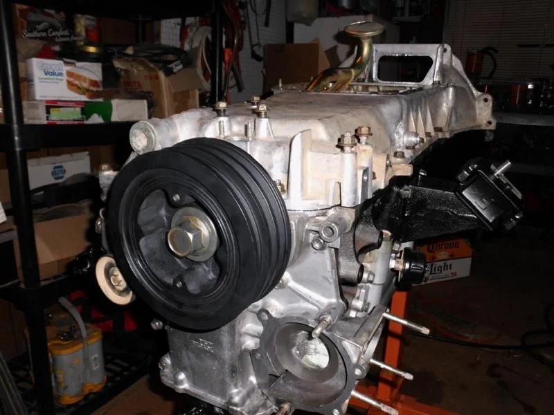

got a little done today. I had a little set back because i was going to put the head on today and then put the oil pans on another time, but the FSM calls for the oil pans on after the timing cover, so, i took about an hour and cleaned up the upper oil pan really well. Slapped it on and then slapped the No 2 oil pan on along with the timing cover today.
Here is a pic of it upside down.
Also decided to use Toyota FIPG instead of permatex stuff. Kind of glad i did considering the Toyota stuff is about the same price anyways.

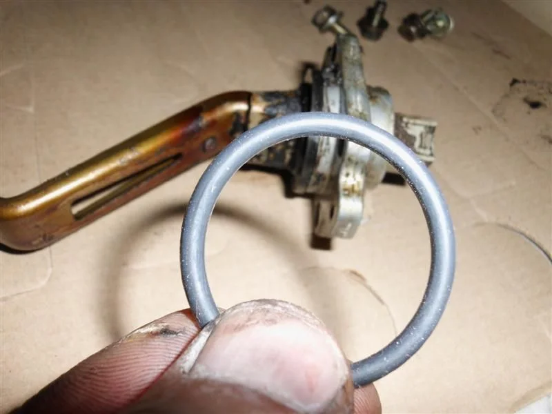

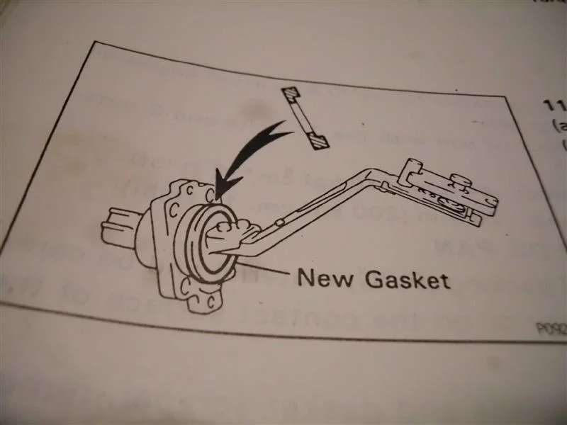

Now here is where i may have a problem and i may be a little upset. It seems that the "gasket kit" that has "every gasket you need to overhaul the 1FZFE" in fact does not have every gasket you need.
Right as i'm about to put the oil level sensor back in (after i clean it up of course :hillbilly:) it calls for a new gasket. Well, unless it's this O-ring i'm showing you, then i'm missing ANOTHER gasket :mad: I really don't think it's the o-ring i'm holding.....
I'm assuming it's the black plastic ring pictured on the picture below? Any suggestions on what this gasket is supposed to look like? I"m going to be upset if i have to stop my project again to order another gasket that i should have had in the "KIT". :bang:
