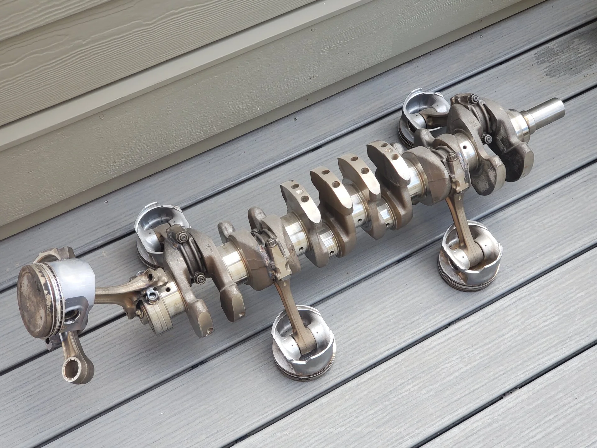

The resulting Cruiser-dog, made from original internals, is shockingly heavy...
(No wonder nothing ever breaks; just eventually leaks/burns oil.)

Yep I can lift the corner front tire on my truck in corners if I mash the throttle.
True.
Ever seen a broken one?
Nope.
I once watched a driveline behind a kta600 Cummins get pretzeled when someone dumped the clutch with a big load on and got impatient with the right foot.
I’ve shattered a few u-joints drag racing.
1st gear in a h151f is 4.08:1. Assuming you stomp on the skinny pedal, that 500 ft-lbs at 3500 rpm is going to be 2,000 ft-lbs before something breaks loose.
Hopefully it’s the tires. Assuming 35s, it will occur at about 20mph.
