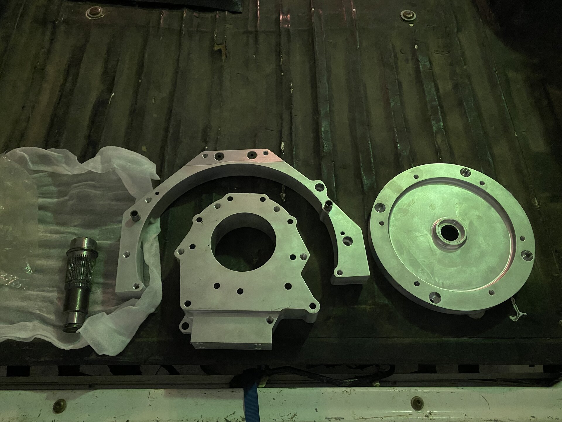

All the pieces required, not including nuts, bolts, gaskets etc.
1 torque converter to flex plate adapter.
1 engine to trans adapter
1 trans to transfer case adapter
1 transfer case input shaft made to fit 6R80 output

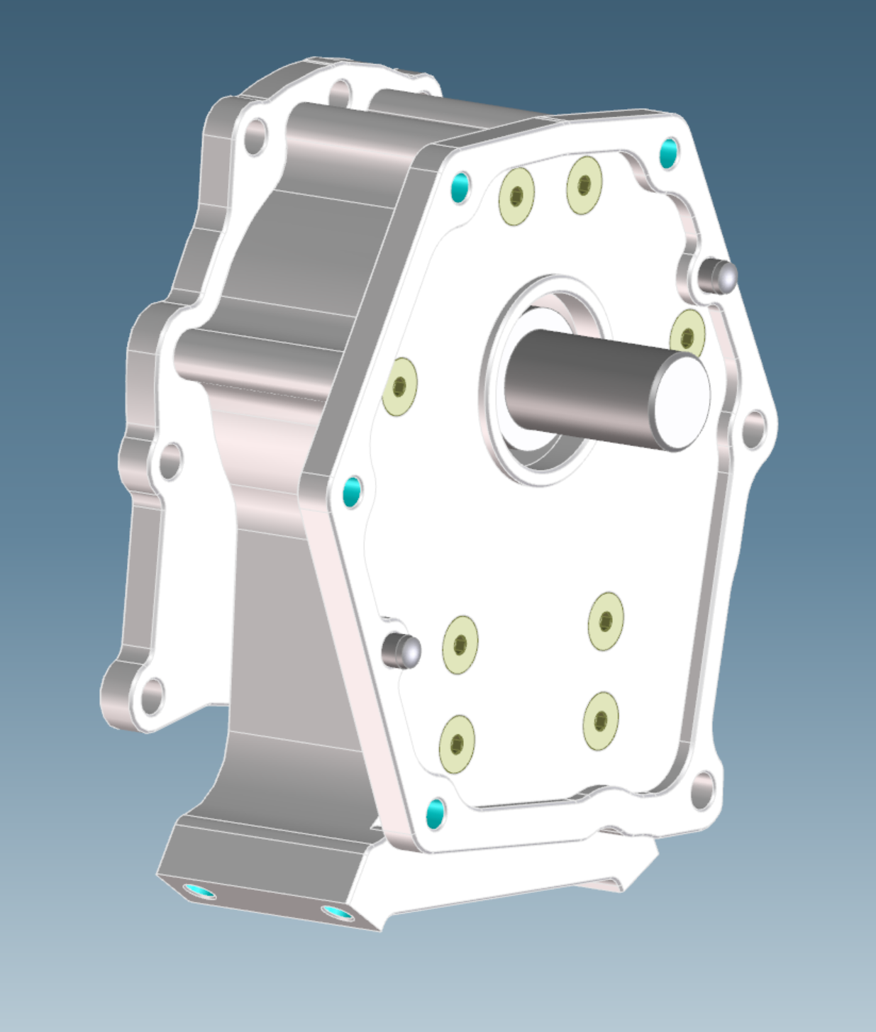

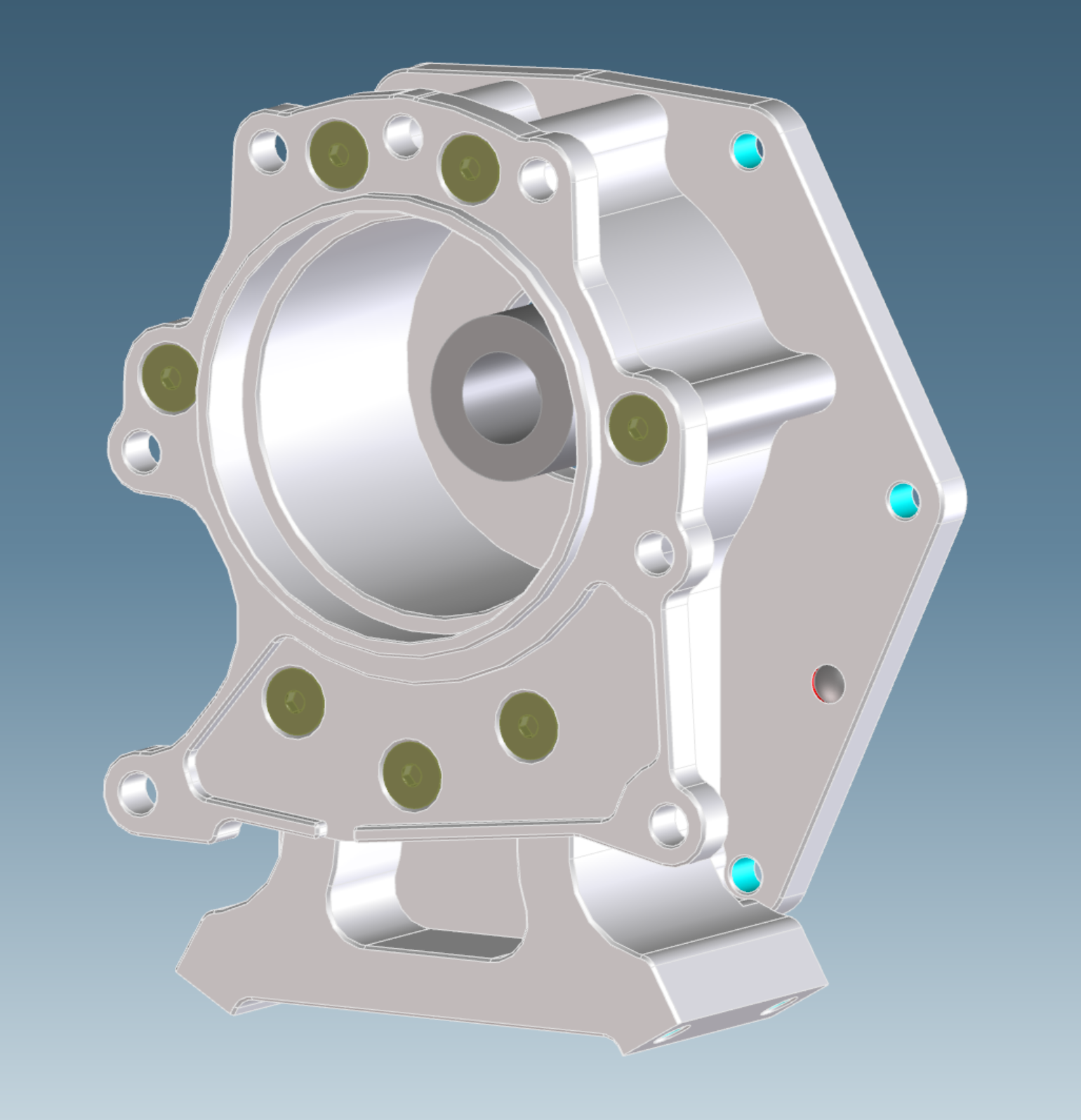

Picture below of my version of the tail housing adapter 3D model. This is my IP. We designed in parallel and then compared designs, taking the best from both. This is not the final design. I will share that when I get permission from DomiWorks. You can see how using the stock transmission mount geometry dictates most of the length of the transfer case adapter. The increase in overall length of the assembly is driven by the Bell Housing adapter, resulting in a movement of Transfer Case rearward by 68.7 mm (2.7").
Also, we do have an intermediate shaft support bearing in the tail housing adapter, much like the stock A343F. That did not cost us any additional length. It is not a wet bearing like the stock A343F, but a sealed, pre lubed bearing. The end of the 8HP75 is sealed, unlike the A343F which pushes ATF into the tail housing and lubricates the wet bearing.

Just from your visual, I would strongly advise removing the sealed single row ball bearing from your design. That is going to bite you hard in the ass down the road. There are ways you could constrain that shaft with bearings, but that is not it and it's 100% unnecessary.
Countersunk head screws are never ideal.
Machine that from one piece or make a pattern and cores and have it cast. That part, as one solid piece, presents no challenge for any common full B axis HMC. Any extra material cost is 100% mitigated by eliminating four other setups to machine the two additional parts.
As I said above, not the final design. This was my preliminary design that we morphed as we did design reviews. The final design uses low profile cap head bolts. I will share that as soon as DomiWorks signs off on divulging the IP.
DomiWorks wanted a modular design so that he could swap end plates for various options. The 3 piece design supports that.
He has done several of these flavors of designs with intermediate shafts and used a support bearing for the intermediate shaft. I will defer to his design opinion on that, as this will be his product to sell and support, not mine.

Fair enough. With Domiworks 4 year stockpile of business experience I'm sure he's got it down.
When trying to identify Domiworks manufacturing capabilities I found this read interesting: Inspection and quality control - https://www.domi-works.com/pages/inspection-and-quality-control
I don't have the guts to claim 3D scanning as geometric part inspection, but it's a big enough deal for them make a whole page on their website and use buzzwords like "ISO program" and "certification".
So the thing that happens when you add a single row ball bearing to a shaft like that is you overconstrain it. Basically, the bearing is being used improperly and such use will lead to failure. If the spline fits are sloppy the shaft can wiggle and vibrate. If the shaft spline fits are too tight the imperfectly concentric shaft and bearing fight each other, taking out the bearing. We're talking tiny bits of out of roundness, but it's there, and ball bearings don't like that.
You see, the splines aren't cut in the shaft after heat treat. Steel moves in heat treat. The bearing journal is ground or hard turned after heat treat held between centers. That puts the bearing center of rotation inline with the ends of the shaft, not the splines.
You could support that shaft with two ball bearings, one at each end, and design some clearance into the spline fits. That would work OK sans the clunk you'd get going from drive to reverse. This really would be a poor choice given the lack of lubrication. You'd get spline fretting in time.
Or, you could work your spline fits out to be something like a light tap fit in the transfercase and a sliding fit onto the transmission output shaft , eliminate the bearing altogether and have a decent setup with no bearings to fail in 20K miles.
Another thing that can be done is to not bore a 4" hole in the adapter. give it say, 1/8" clearance around the spud shaft, add a seal to the rear of the adapter to seal on the snout of the HF2AV and pull the seal out of the back of new transmission. This way the splines will get splash lubed with ATF, Exactly as good, experienced Toyota engineers intended, the splines will never wear, and it won't trap any ATF or debris in the adapter.
Just my 2 cents. Good luck with your design.
