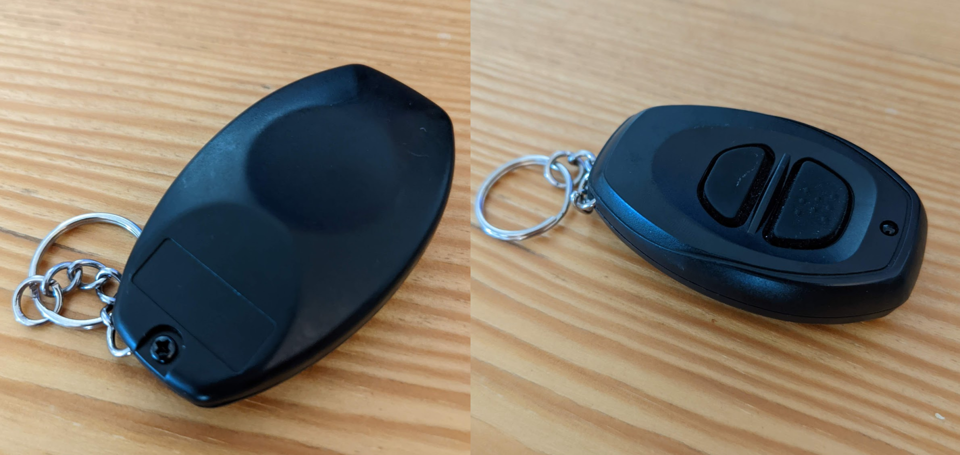

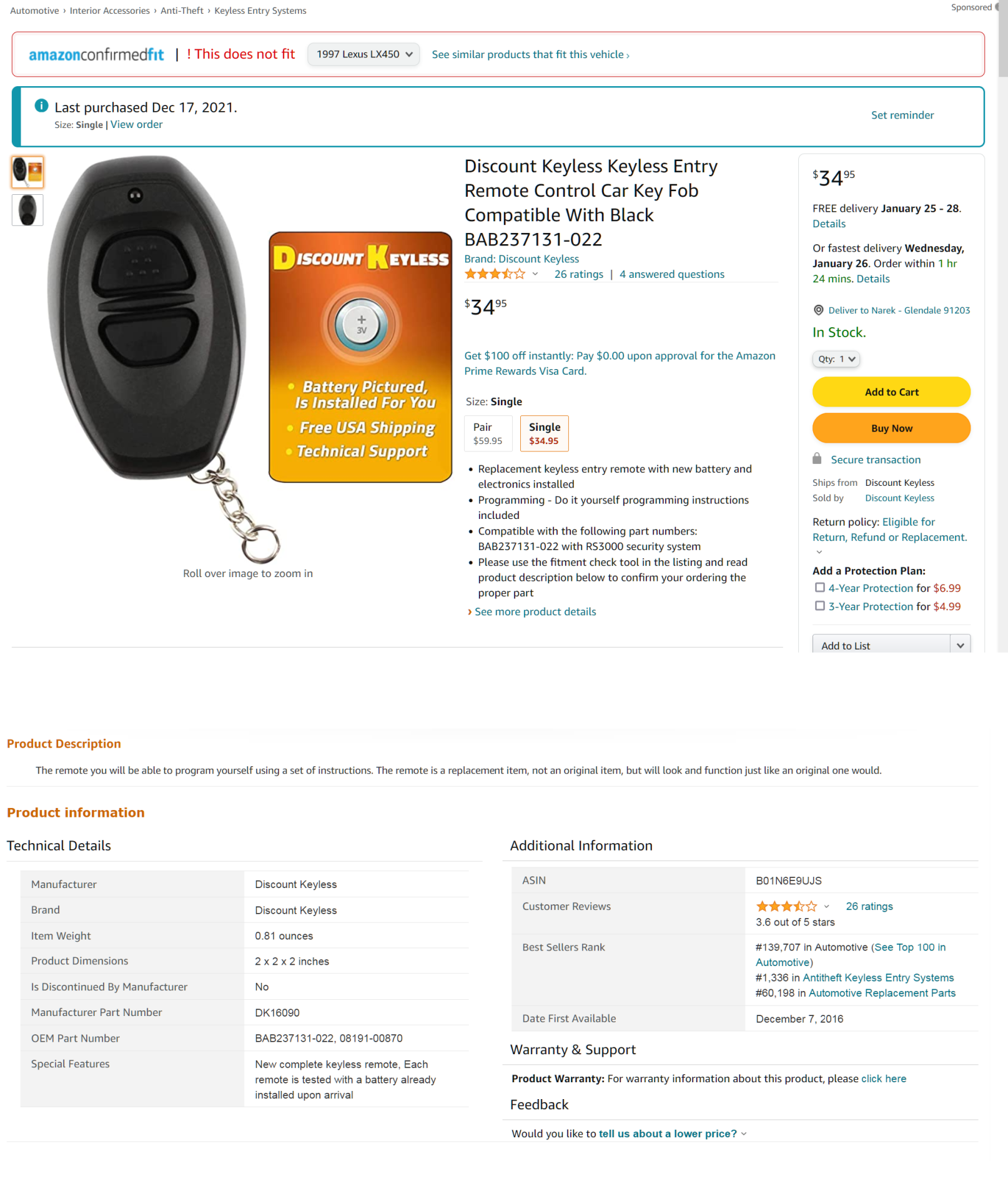

Just to update anyone that might stumble on this thread while searching.
I ended up buying this remote off of Amazon for $30 (Even though Amazon says it doesn't fit). It worked with my RS3000 system (part number in original post). A single button both locks and unlocks, so I ended up programming the remote twice. So each button on the remote can now lock and unlock. Programming was done by the standard RS3000 instructions. The remote came with the instructions printed. The remote has no markings anywhere on it, so no FCC ID.
One issue I've experienced, the "beep" on lock, and "beep beep" on unlock is intermittent. Sometimes it does it, and sometimes it doesn't. I don't think this is a problem with the remote. I believe this is due to one of my door lock actuators getting old / tired.

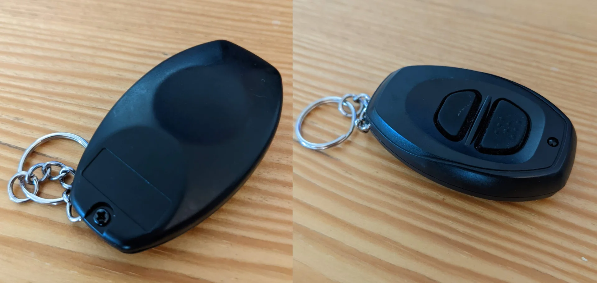

One more shot... I have a 1996 LX... Exactly what you said you have. The back of my factory remote has FCC ID:BAB237131-032. Exactly what you said you needed..
I bought the one I linked to on eBay (Replacement for 1991-1997 Toyota Land Cruiser Key Fob Keyless Entry Car Remote | eBay - https://www.ebay.com/itm/112183350037) and it worked fine even though it is listed as the BAB237131-022 fob.
