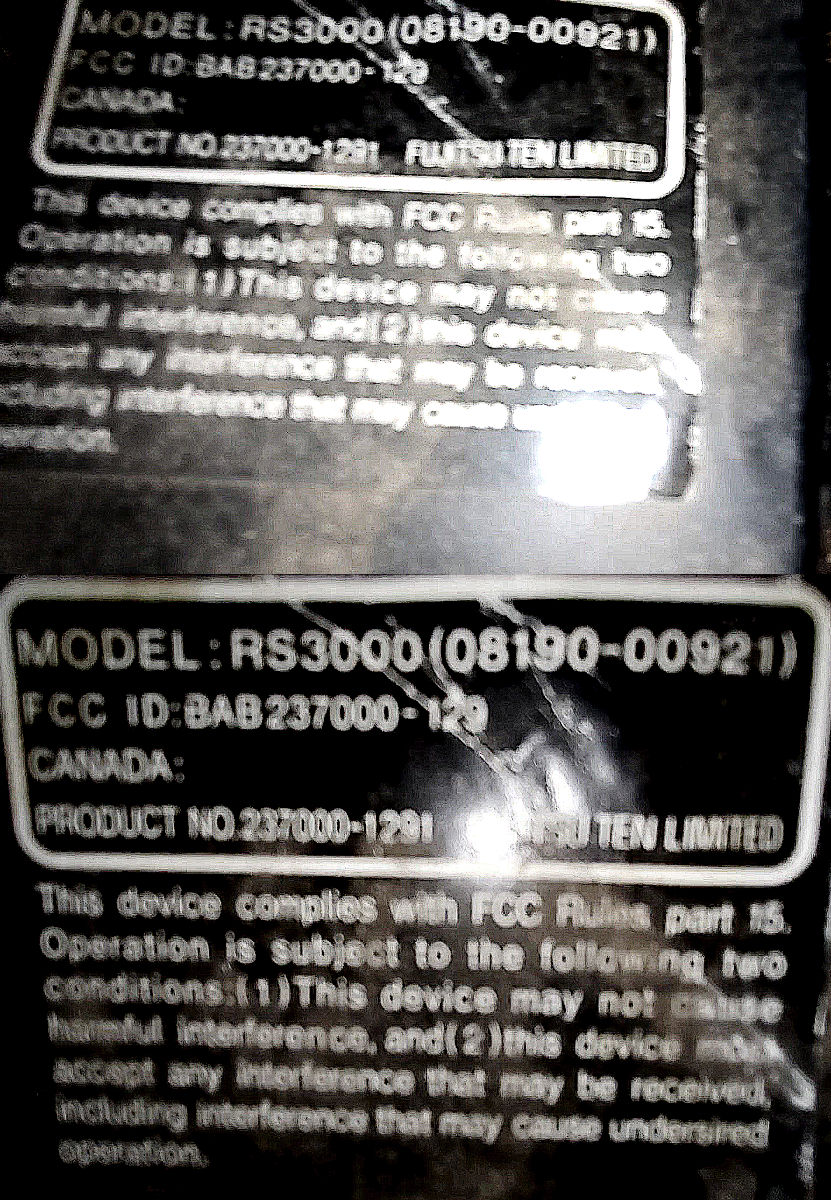

My Alarm: RS3000, 08190-00921, BAB237000-129, 237000-1291 (working)

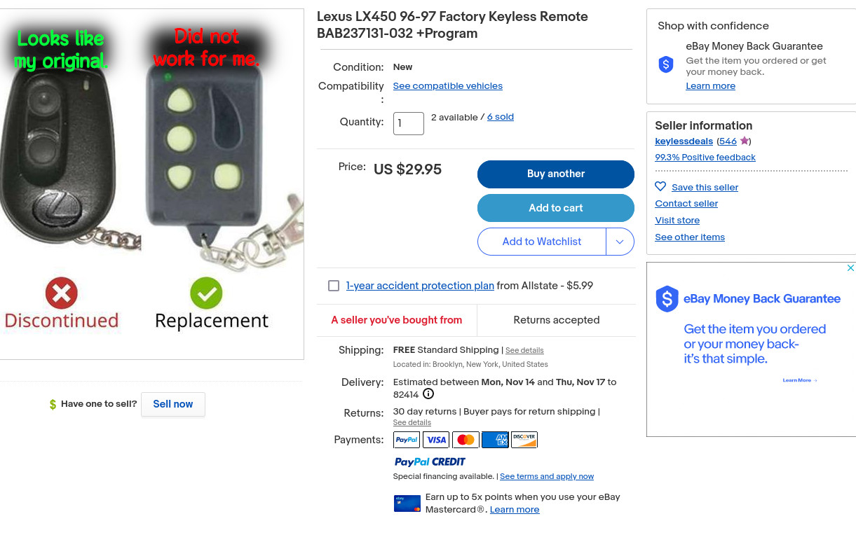

Because of the success had by the two other contributors in this thread, I have ordered this one and will report back:
This other one did not work for me despite the listing saying it's for LX450. (looks like the one that did not work for another LX450 owner in this thread)
I've attached a pic of my module, and a screenshot of the one that did not work for me. Hopefully the KeylessKing with the FCC ID discrepancy works for me too.

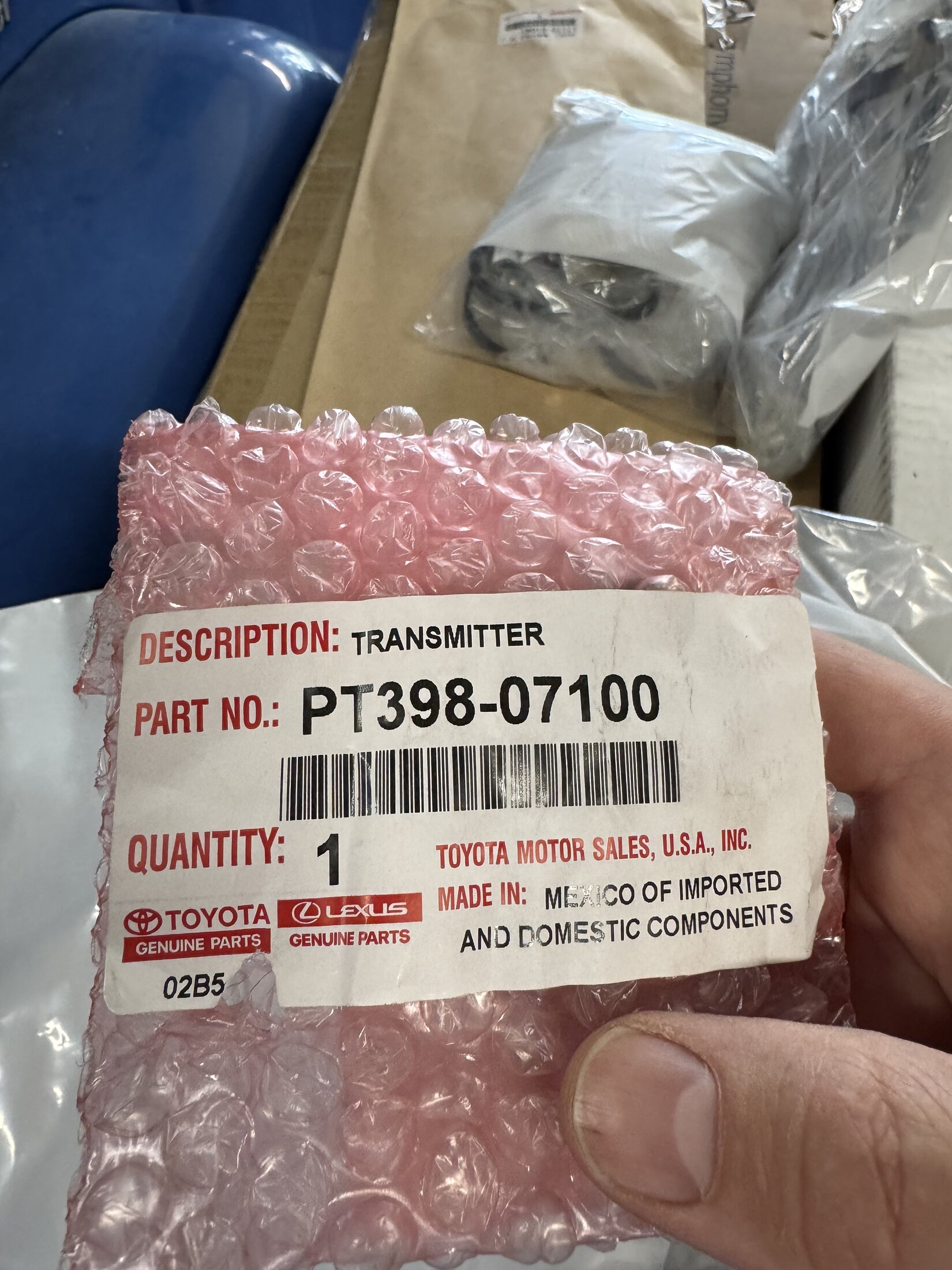

After spending that much you could have bought one from Toyota. 60 bucks for PT398-07100 worked on my 96 LX450 and 95 Land Cruiser

I sent back the fobs that didn't work for a refund. Plus I need 3 working new ones, and my original is on it's last legs.

To add to the thread, As a reference for PT398-07100 I can confirm it also works for my 1996 lx450 with original rs3000 system.
Programmed it by turning key to on, then pressing green button as mentioned by previous poster, for 3 seconds, then pressuring button to program on the remote. After closing the door and trying new oem remote, it works well.

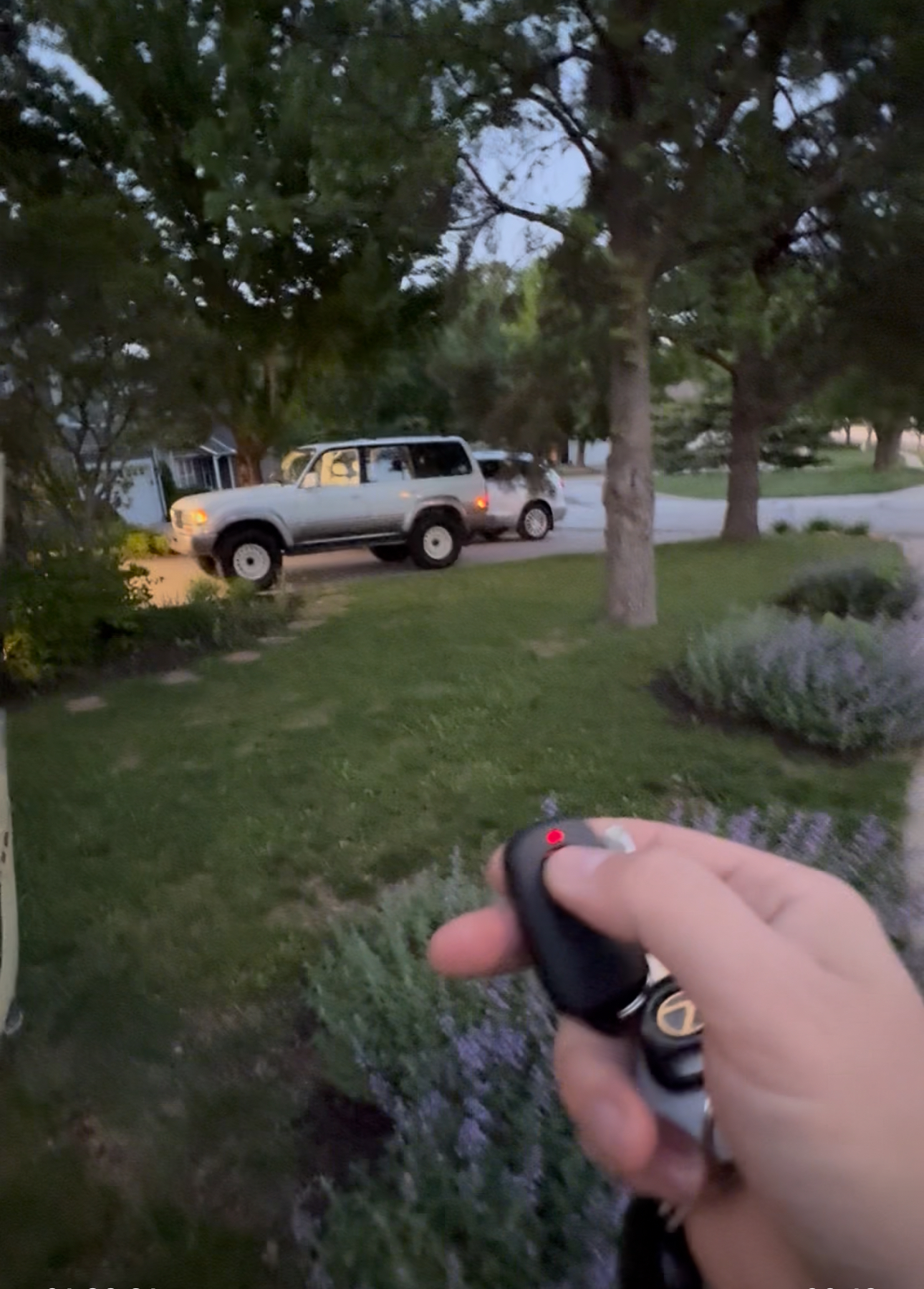

Most important is the distance the new PT398-07100 fob works at is amazing, it’s about 45-55’ from the vehicle! see image of distance and parts below:
Toyota Dealer has the fob, PT398-07100

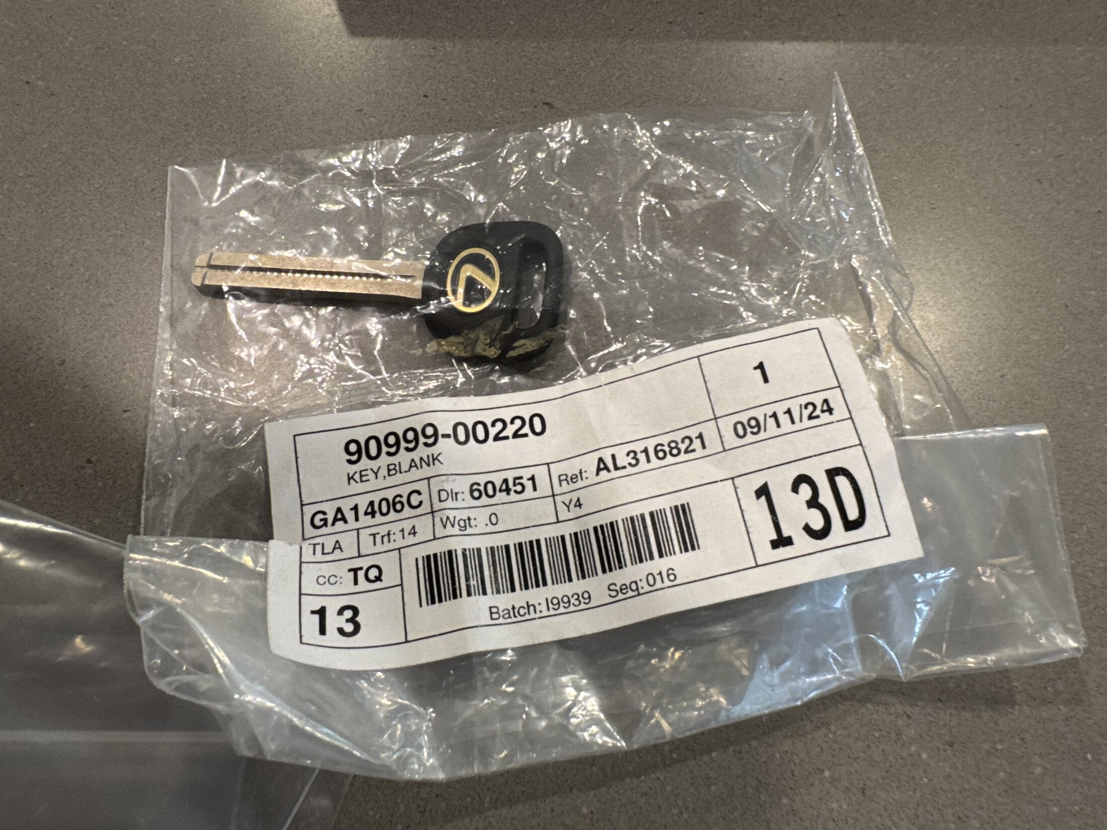

Key4.com has the oem key: Lexus Master Blank Non Remote Key 90999-00220 - https://www.key4.com/lexus-oem-master-blank-key-9099900220
Time to cut the new key :)

Wow!
My "new" one has better range than the original. But, yours is amazing!
Almost too good
