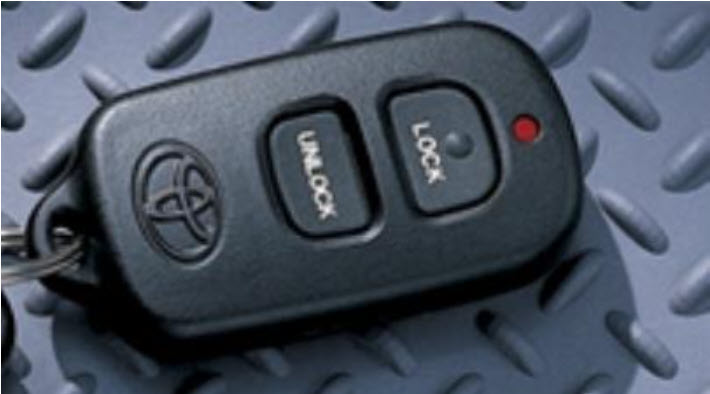

Here is what is I thought it looked like:

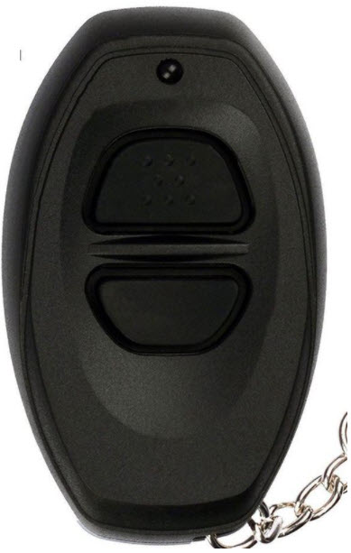

Here is my eBay one:

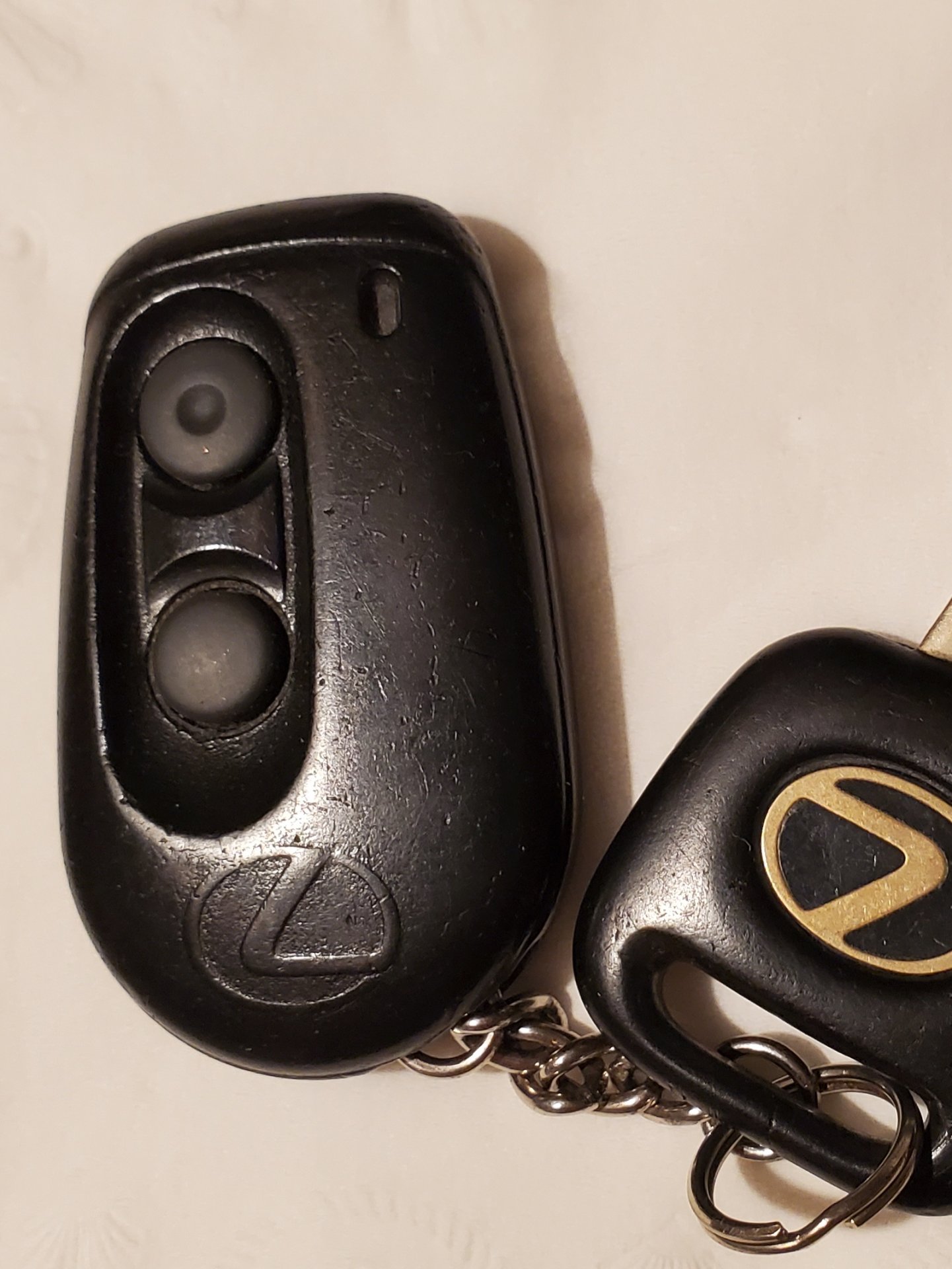

Here is the original Lexus one:
