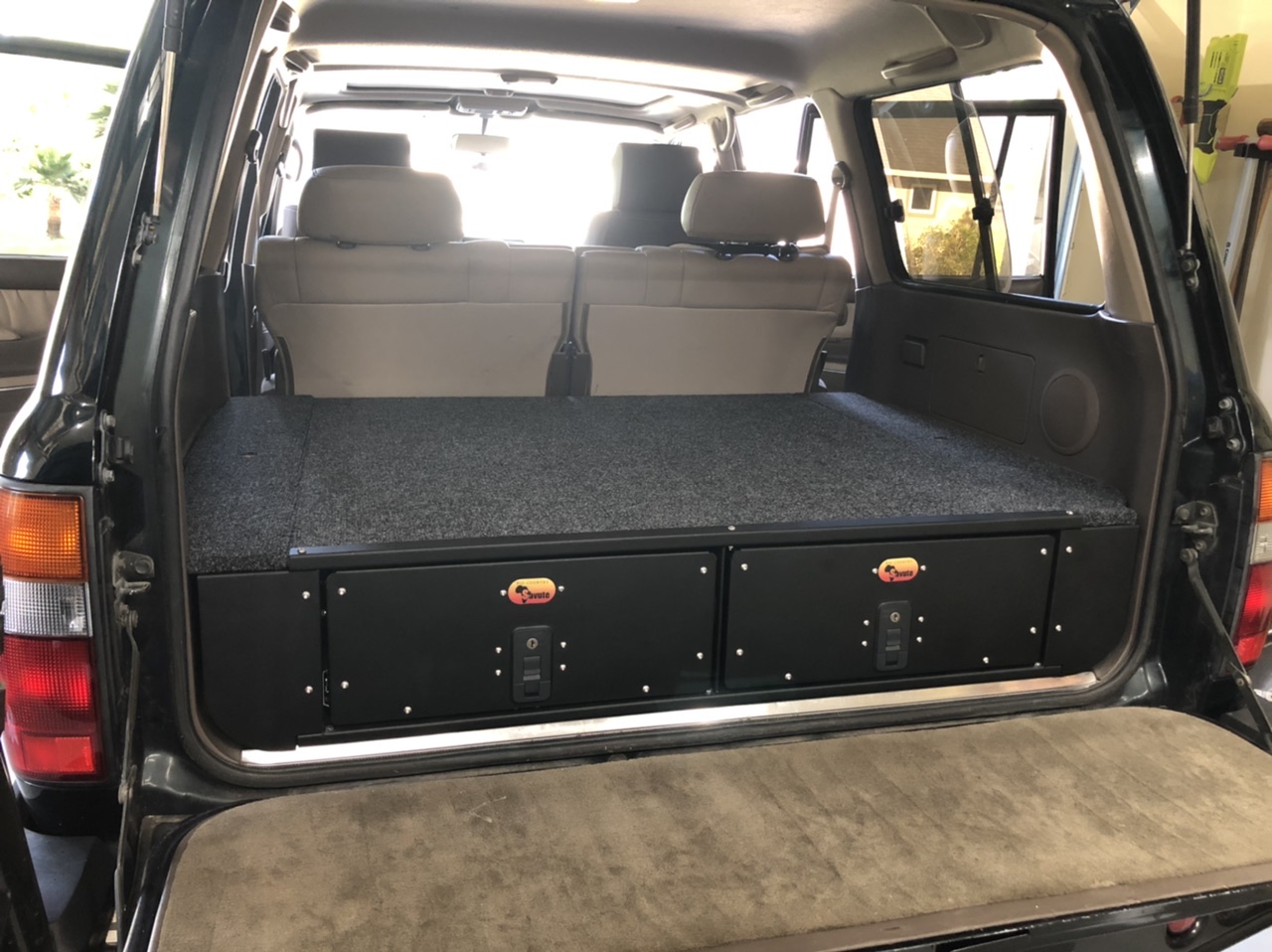

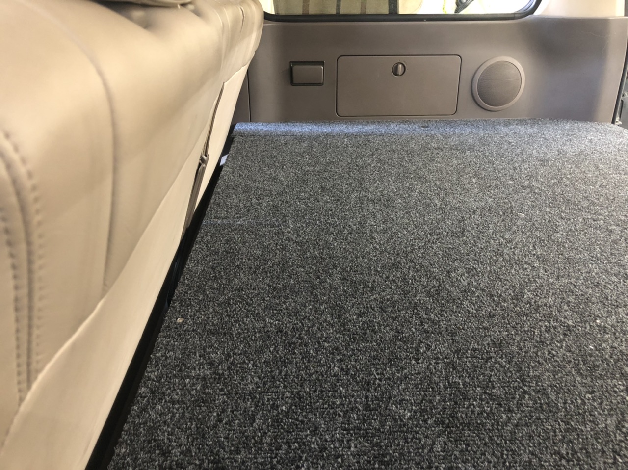

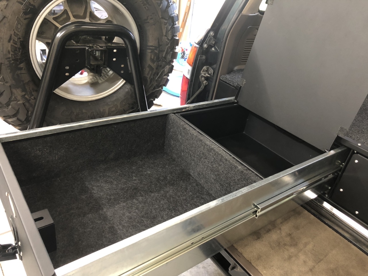

Finally got around to installing these from @RuggedBound
Turned out better than I had expected even! Pretty straight forward install and a righteous fit. Excited to start organizing. Fender measurements show I lost about 1/4” in height, so may need to tweak rear coils depending how it goes once loaded out. BP-51s will be up to the task.

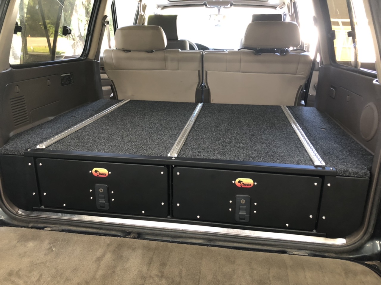

Up next is getting L-track in place, but holding off as I decide for a “fridge” slide out. I’ve got a large RTIC 65, but it’s just outside of typical fridge dimensions, so time to get creative. L-track mock-up for now...
Also waiting on the fancy seat leveling blocks from @Outsane so I can get a mattress in for camp. Looks like it’s coming together...
Looking good! I still need to get mine installed, these look great in the truck.

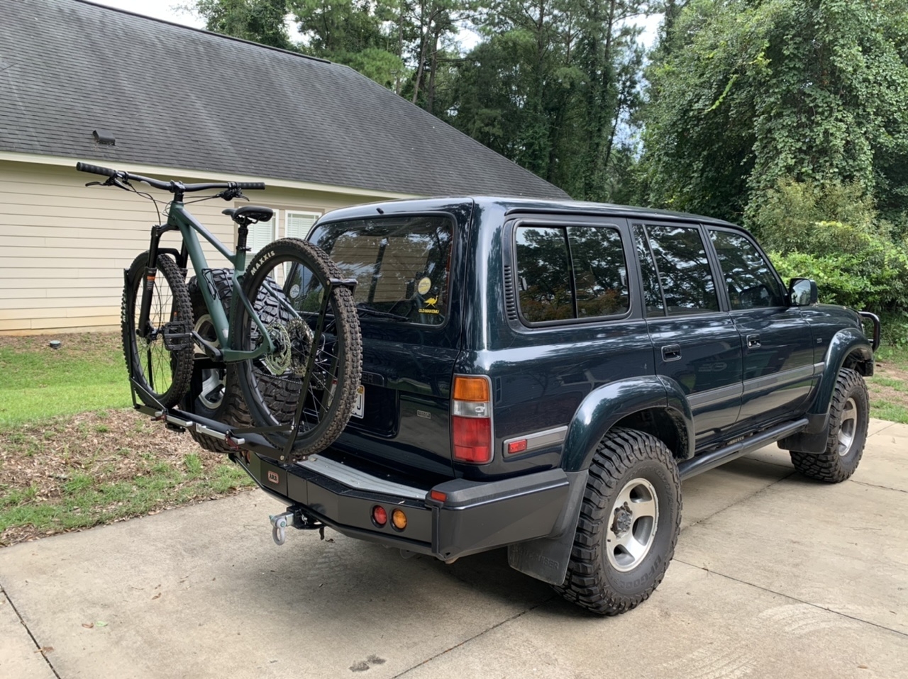

Rev 2 bike rack turned out better than expected.
Can you share some details on how you mounted the bike rack to your spare tire swing? I have been contemplating how to mount my 1UP rack on my 4x4labs swingout without having to weld something up. This may look for me.
I'm not familiar with your bumper, but the ARB swingout has a 2" receiver that is centered in the spare wheel.
My 1UP is intended for a roof rack, not the typical ones you see with the swing down mount. This was important for me because it offers a T-slot the entire length of the mount and gives options to mount.
I took a drop hitch that's used on Bro-Dozers (I think this was an 11" drop?) and went from there. The mounting lugs and the bolt pattern for the spare wheel only give me space for north to south direction for a receiver pin instead of the intended west to east, so I drilled two holes through the drop hitch and used a locking pin to secure. An anti-rattle clamp should be here in a couple days to tighten it all down.
Included with the 1UP are a couple aluminum clamps that are intended to clasp around a roof rack rail, but I'm using them to clasp around the drop hitch. The drop hitch has about a 1" hole where a receiver ball would be mounted and I grabbed three 3/8" carriage bolts for the T-slot. I sized up some nylon to act as a positioning bushing for this hole and drilled a 3/8" hole for the center carriage bolt which goes from T-slot > through top clamp > through nylon bushing that's inserted into the drop hitch hole > through bottom clamp > fastened with flat washer and nylon locknut. This helped position for install but will also help promote things staying in place.
To keep the clamps inline and really crank things down, I used two shorter carriage bolts on opposing sides of the center bolt in the T-slot that fasten to security barrel nuts that run through the clamps with Loctite. This gives me three bolts that span across a 6" length clamp against the rack to help battle the overhung load. I also offset the rack about 5" from center to the driver side to help with this as well. The design of the 1UP still allows me to center the bike on the truck.
This is the best shot I have of what’s going on right now. Hopefully it makes sense.
I'll probably just keep the rack on the truck even when not in use. Can't even tell it's there and I've got a locking pin plus security nuts. 1UP does a great job with their coatings, so corrosion isn't an issue.

Very clever way to mount the 1UP. Unfortunately, the 4x4Labs doesn't come with the receiver behind the spare wheel so not possible for me. I do appreciate the thorough response and I'm always amazed by the willingness of the members on here to share their knowledge!

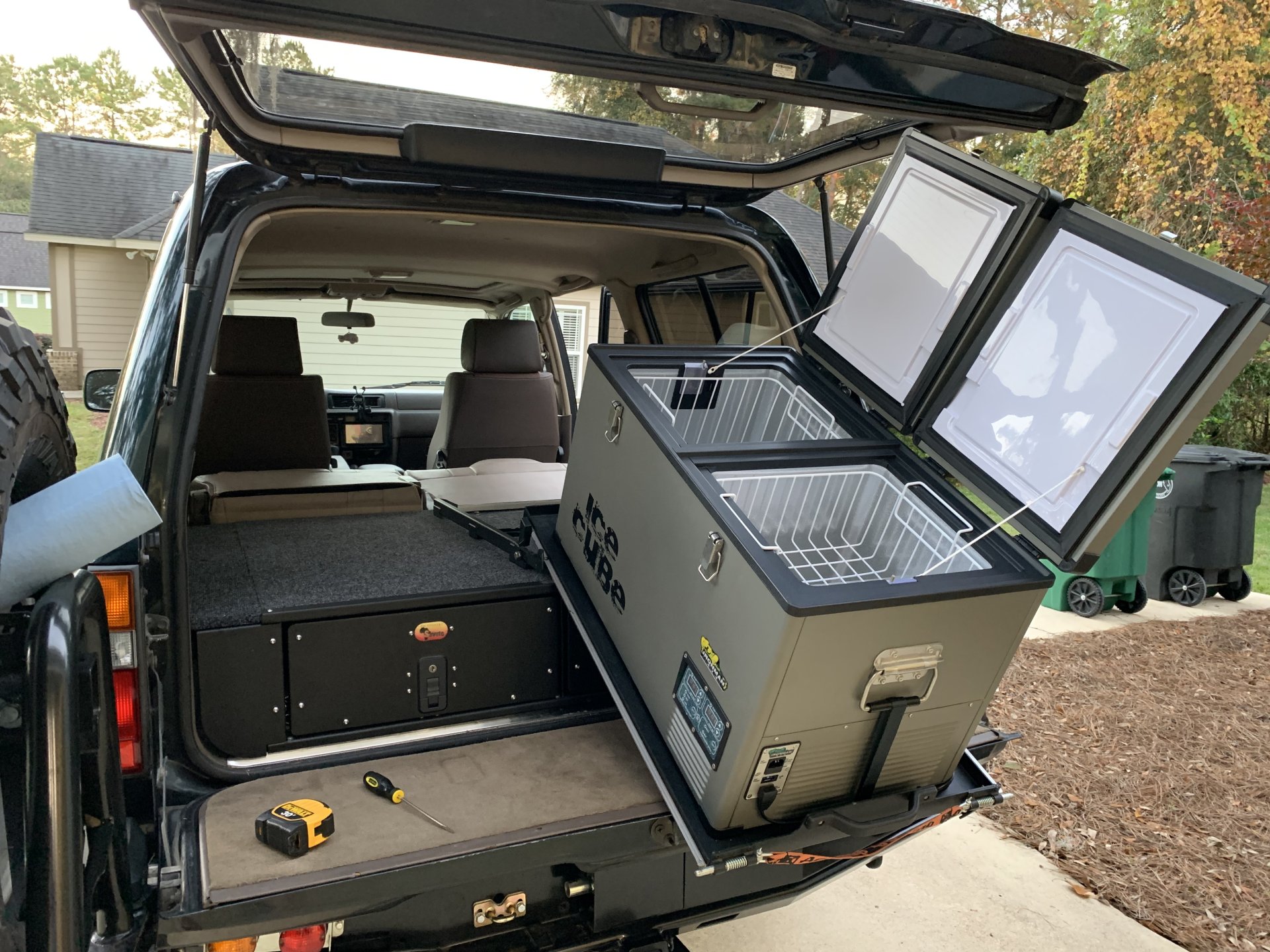

It's been a while.
I have since...
Installed an AluCab tilting fridge slide + 65L dual zone fridge on the passenger side (couldn't ask for a better fit)

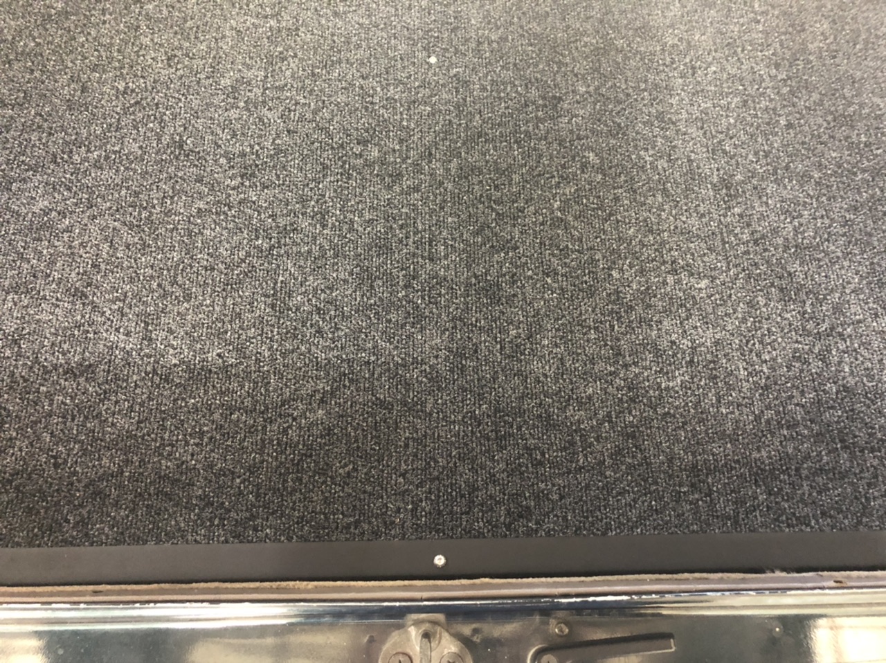

Come up with a working surface to replace the tailgate carpet (not interested in storage, just a panel)

Looks great. Seems that alucab slide integrates well with the savute drawers.

Good choice with the tilt-slide and dual zone fridge!! love mine!

This slide is the biggest one they make (one size smaller would be perfect), but even still it fits great. Really happy with the ergonomics and quality. Added some trim between the slide and the base to keep it taut. No rattles and good to go. With drawers, I think a tilt/drop is a must.

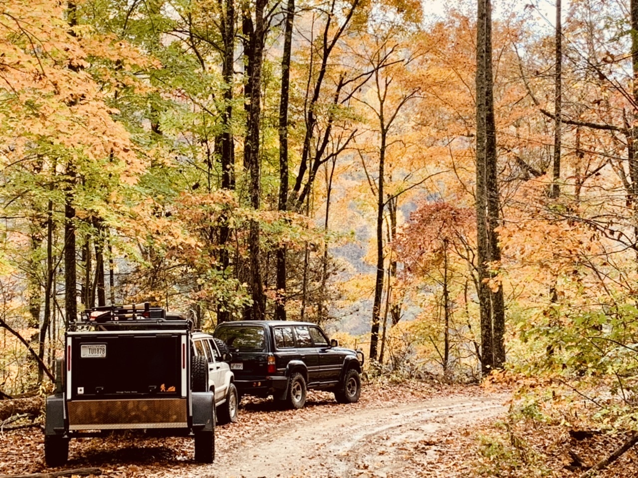

I recently left the truck at my parents’ property in North Georgia. Glad I did for a recent work trip. Impromptu camp weekend with Pops and his Jeep/trailer combo.
