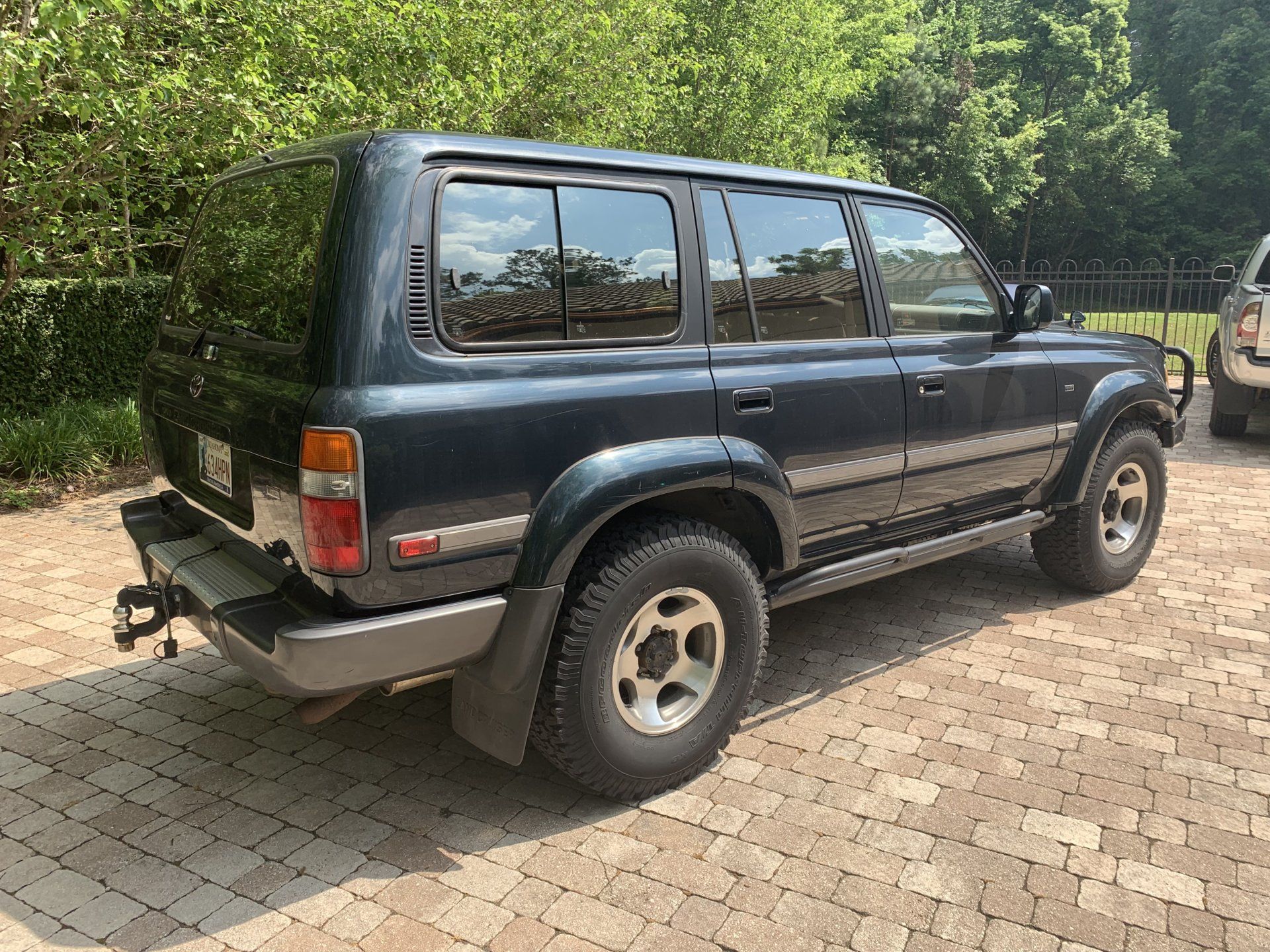

I have been wanting a green Collectors Edition for a while now. I finally came across this one in Oklahoma and shipped it to Florida. It was delivered new without the factory roof rack or running boards. Yes, it has factory front and rear lockers. The mileage was decent (170k) and condition was pretty good. It had a collision a few years ago but the owner was able to supply me photos to confirm the impact was upon the front ARB bumper and no body damage occurred. All in all, the truck checked a lot of boxes for me so here we are today.

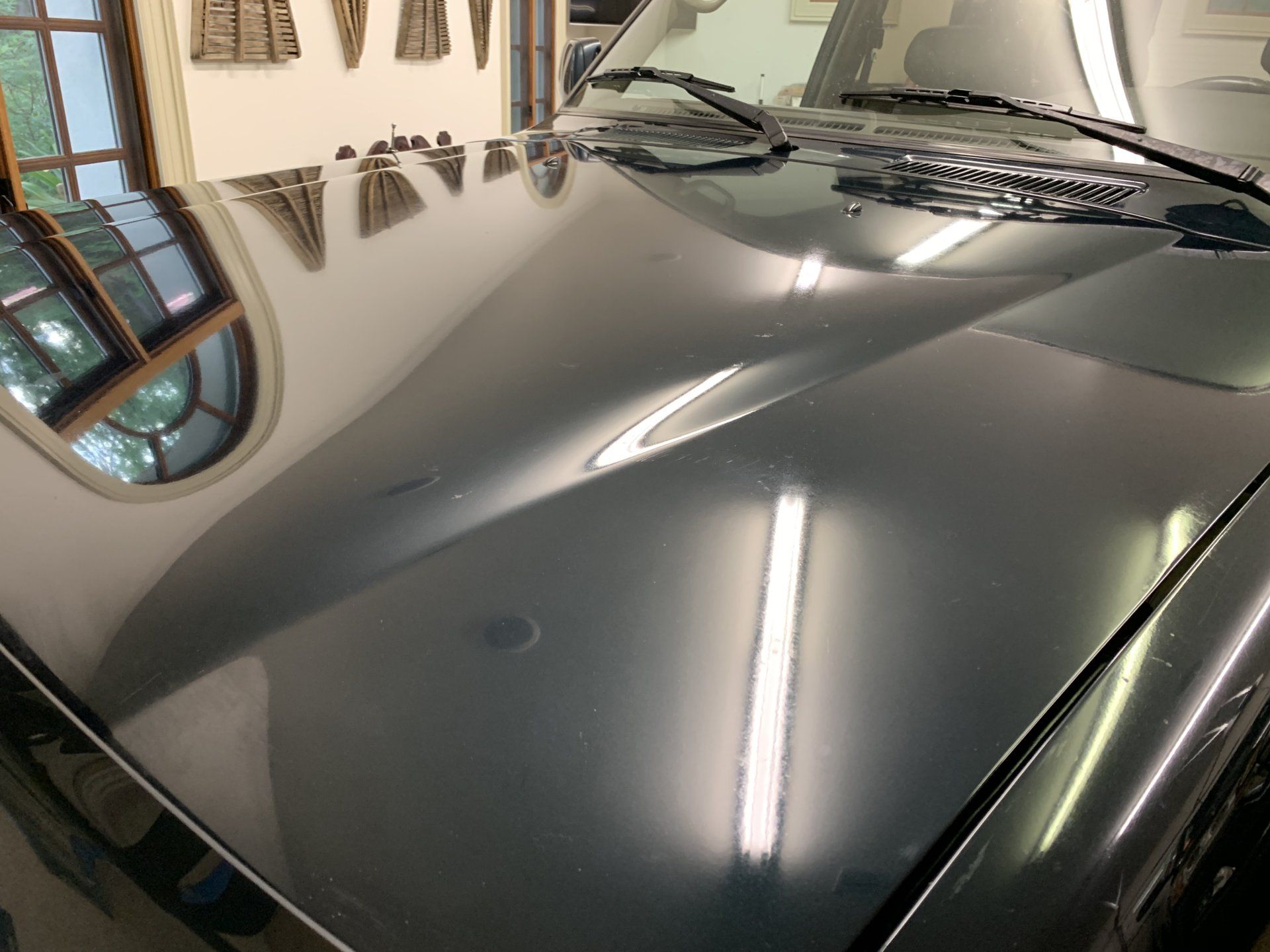

This truck had been sitting outside for the last year or so and the hood has started to develop some oxidation. Not to the point of paint peeling, but it definitely needed some love. I have never attempted to buff or polish a car before but after watching some YouTube videos and reading some threads I thought I would give it a try. What’s the worst that could happen?
I purchased a Griot’s Garage DA polisher from Amazon after reading some reviews. It wasn’t cheap but it wasn’t the most expensive. I think I paid around $150 for the polisher along with some various pads to try out. I bought some Meguiar’s Ultimate Compound and decided to take my new toy for a spin.
The hood definitely had a strong haze before I started this project. It wasn’t so bad I felt like I needed to get it painted, but it certainly made me notice it every time I walked past the truck.

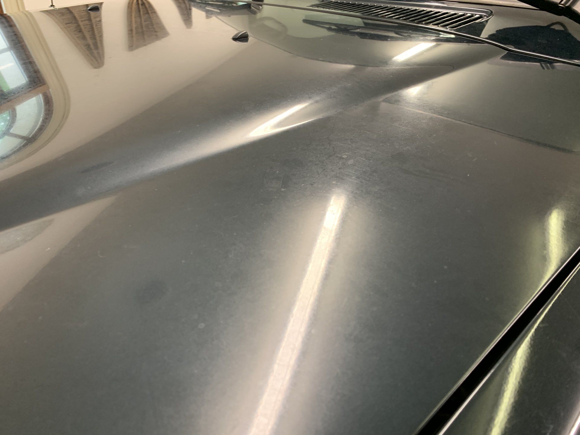

The entire hood took maybe an hour or so. I took my time and worked my way around the hood in small portions. The end result was much better than I hoped and the picture doesn’t do it justice.
I am not sure why it took me so long to buy one of these. After doing the hood, I walked around the truck and took out some scratches here and there. Overall it’s a huge improvement.

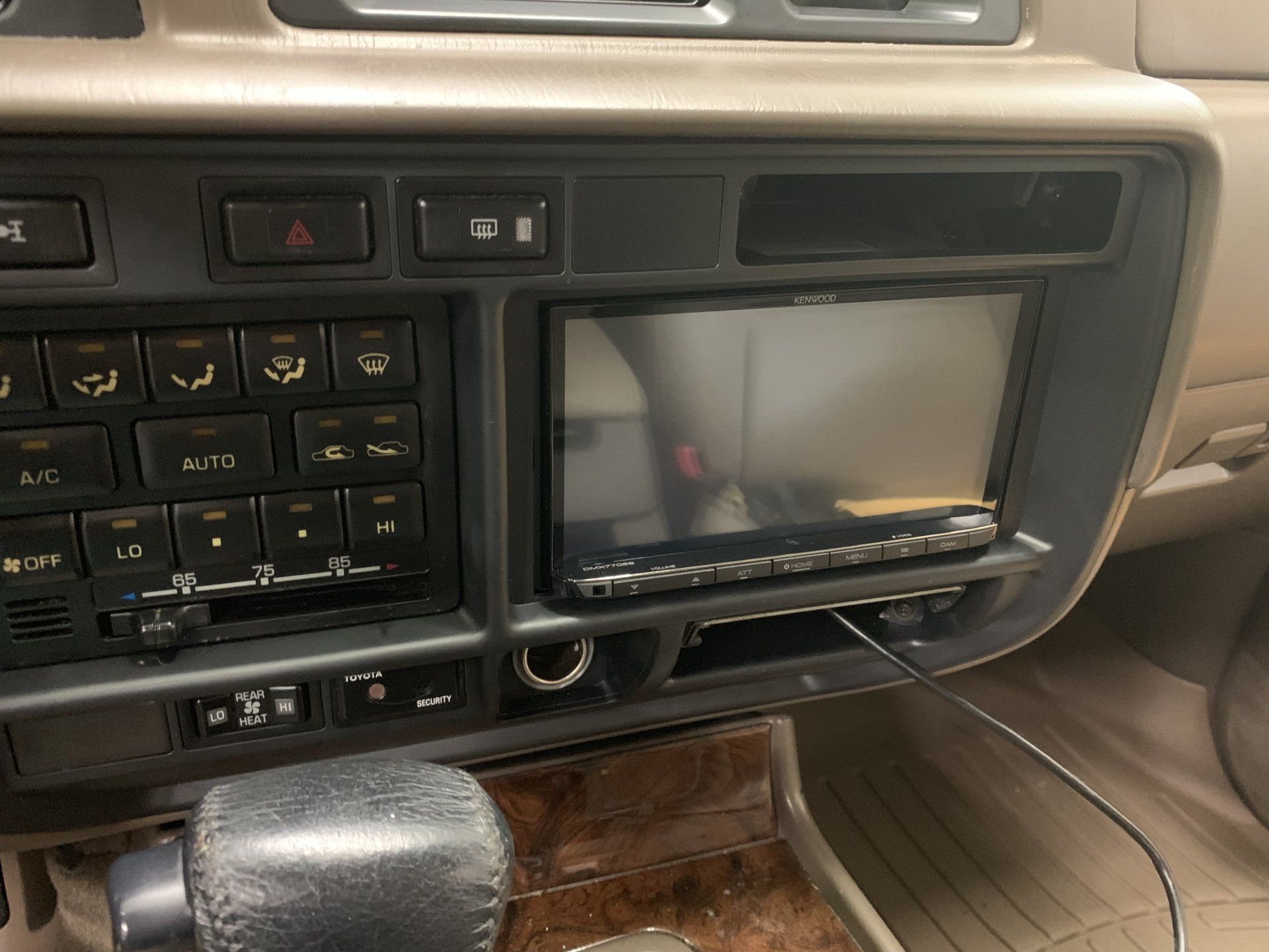

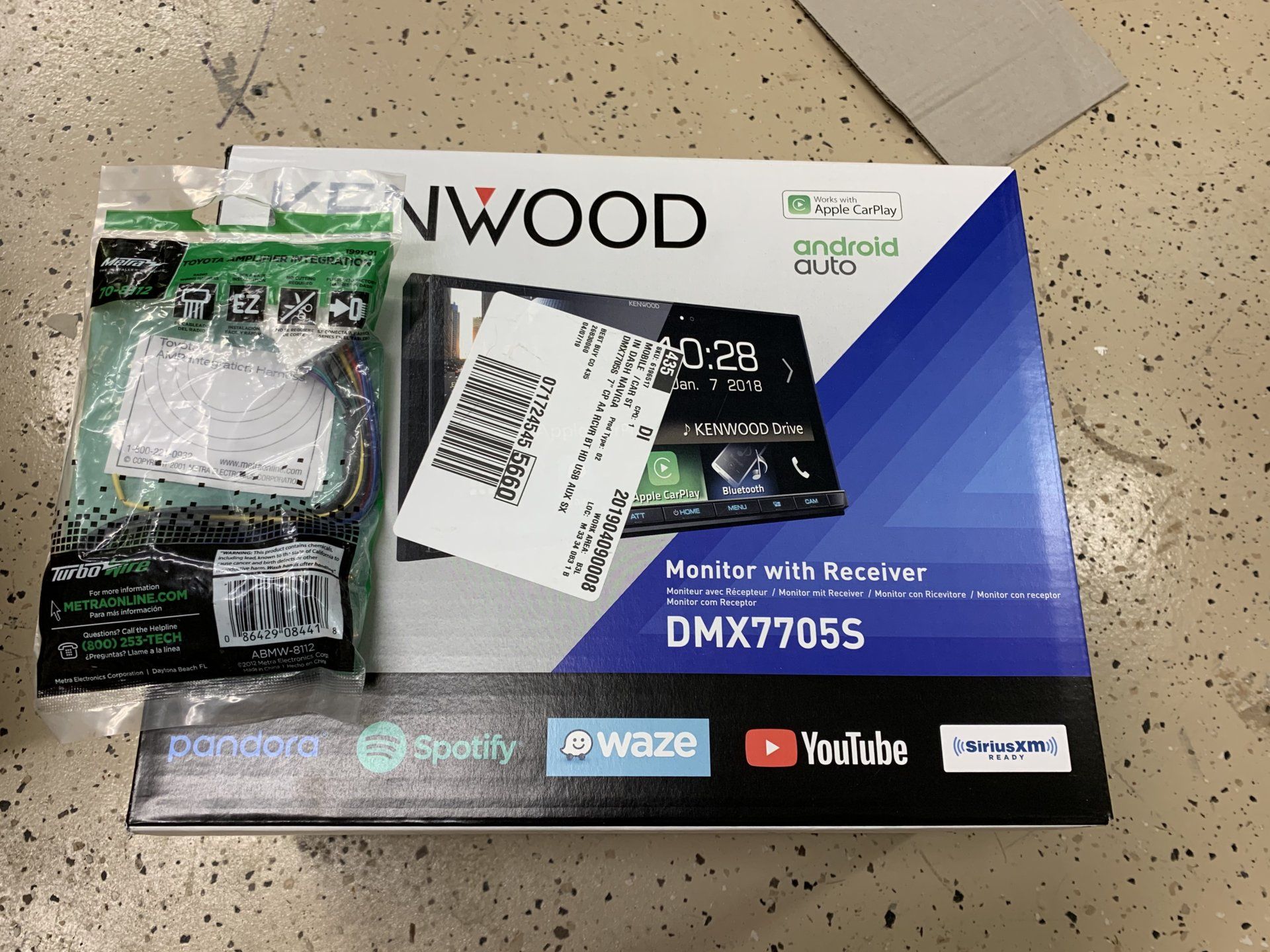

I took some time over the weekend and addressed the non-working radio. The truck still had the factory CD radio but it would not change channels. Basically, it would not do much of anything besides turn on. I had some Best Buy points so I scored a pretty sweet Kenwood unit. It was originally $499 and now discounted to $349.
The wiring was pretty straightforward. I decided not to wire up the power antenna because it’s not really working and I have plans to swap it out for a short antenna. Overall, very pleased with the unit. It has apple CarPlay along with the ability to incorporate front and rear cameras.

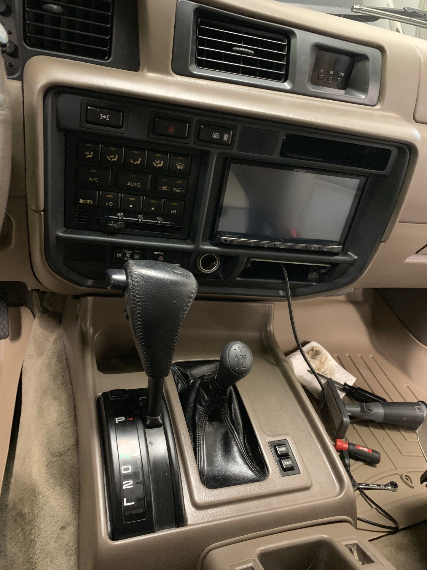

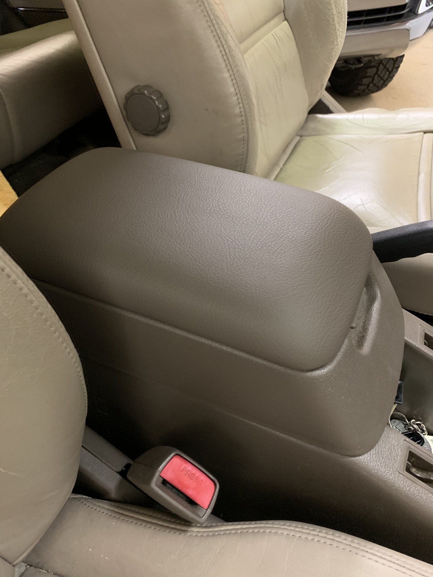

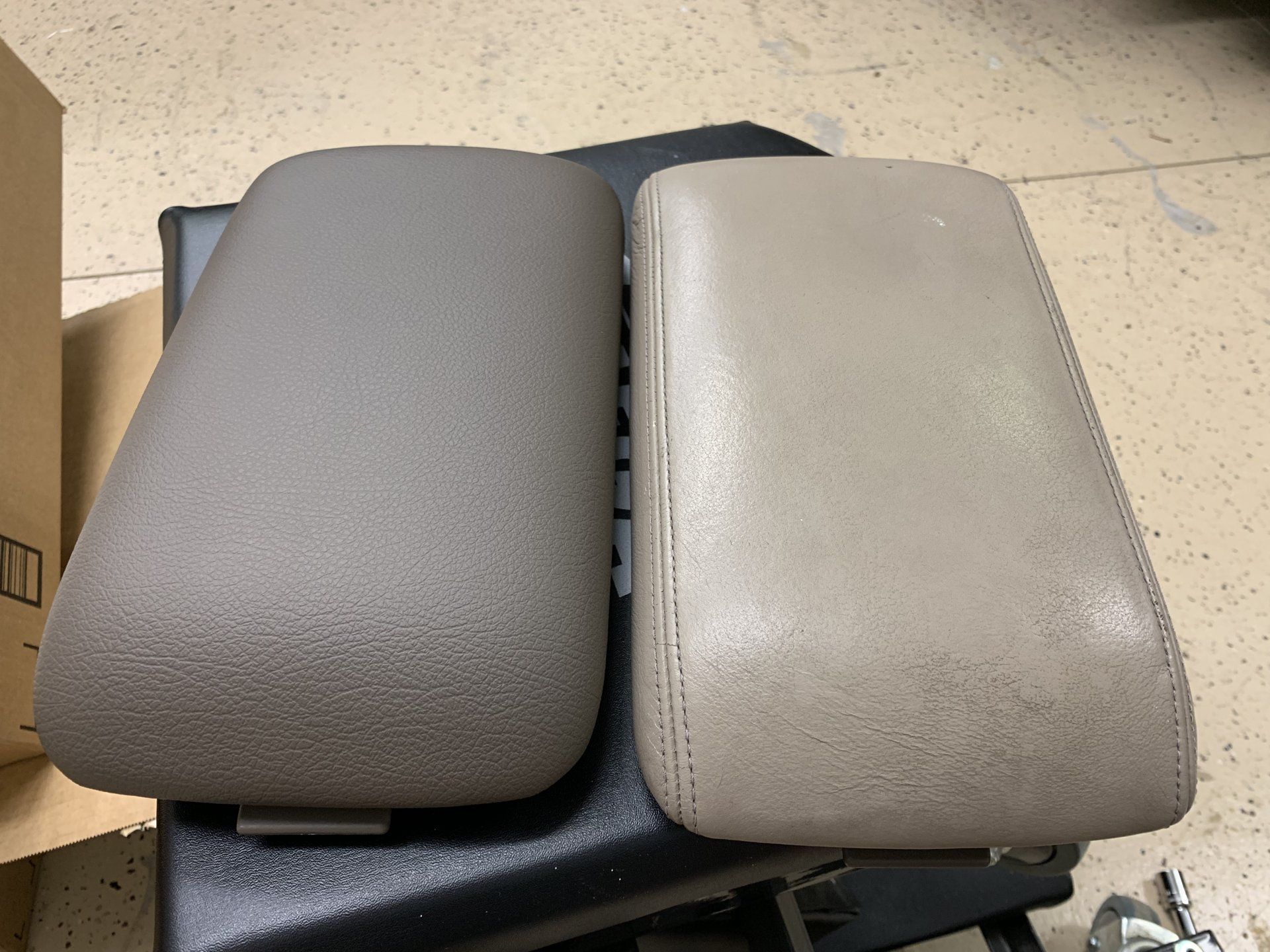

The last of the woodgrain was removed tonight. I found a nice shifter console that was woodgrain free. After a fair amount of cleaning, I think the final result is pretty sharp.
A few years back I bought several of these oak colored console lids. I’m not sure they are even available anymore and this was my last one. I am a big fan of the color as it will match the inbound ScheelMann seats much better than the lighter tan leather.

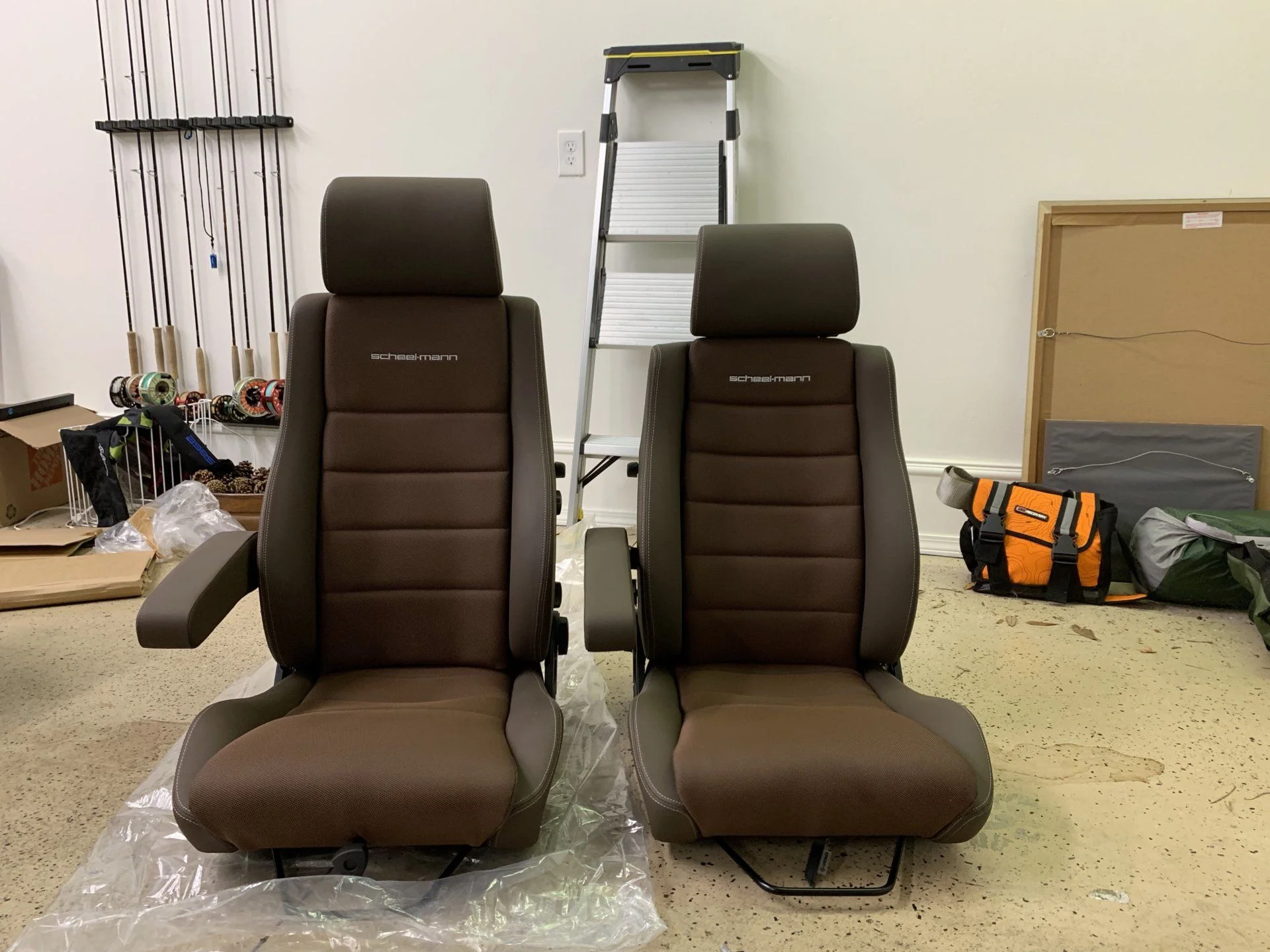

Seats arrived! The only problem is that the Planted brackets did not arrive so will be a week or so before I actually get them installed.
In the meantime, I am going to work on having the rear seat recovered to match these seats. I ordered a supply of the brown leatherette and fabric material from ScheelMann when I ordered these seats. My upholstery shop is going to get started on that project pretty soon. Should be really cool.

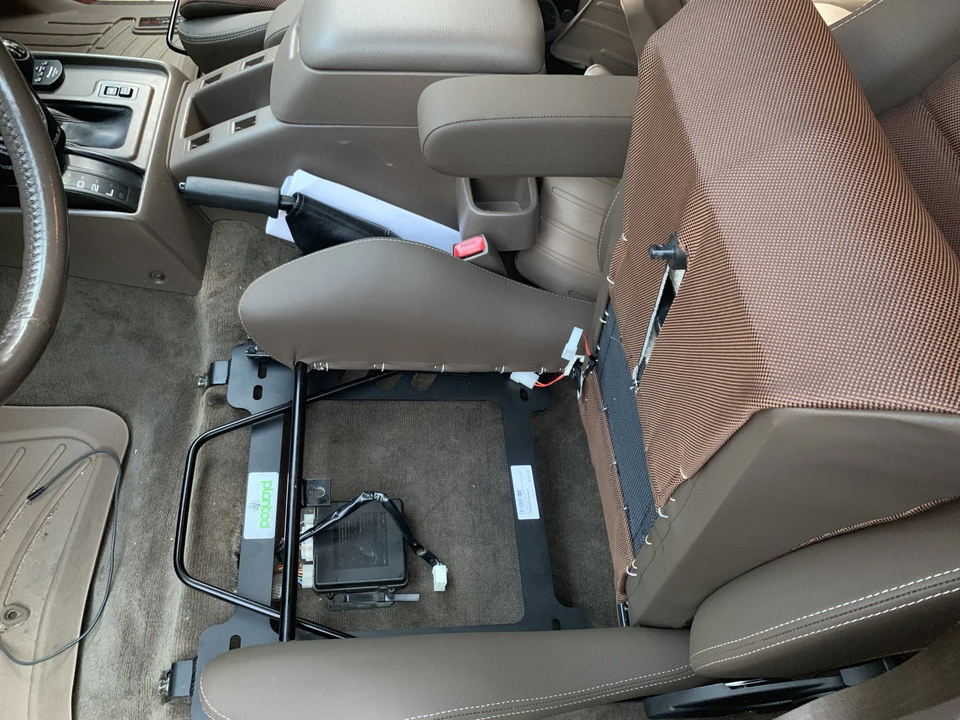

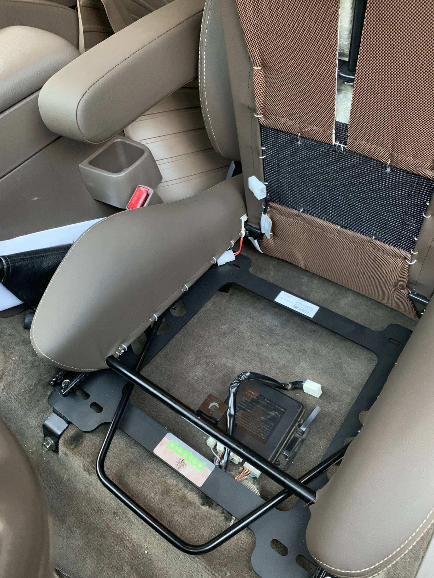

Well....I decided I could not really wait on the new brackets to get here. I pulled my red 80 series out and decided to swap some things over since I already had the Planted brackets in that truck.
I ordered the Traveler edition seats because I wanted to get the fold-up bottom section. There is a good amount of room under these seats and the fold-up seat bottom allows that storage to be properly utilized (no clue what I'm going to store yet). Here are a couple of photos of the seat bottoms.
These seats are also shorter than the set in the red 80 series. That truck has the Vario XXL seats and they are about 3 inches taller (compared to the Traveler LR) in the seat back position. I originally thought the Vario would be too tall for the 80 series. However, I'm not sure I prefer one option over the other at this point. I think each have their pros/cons. Here is one next to the other for comparison.

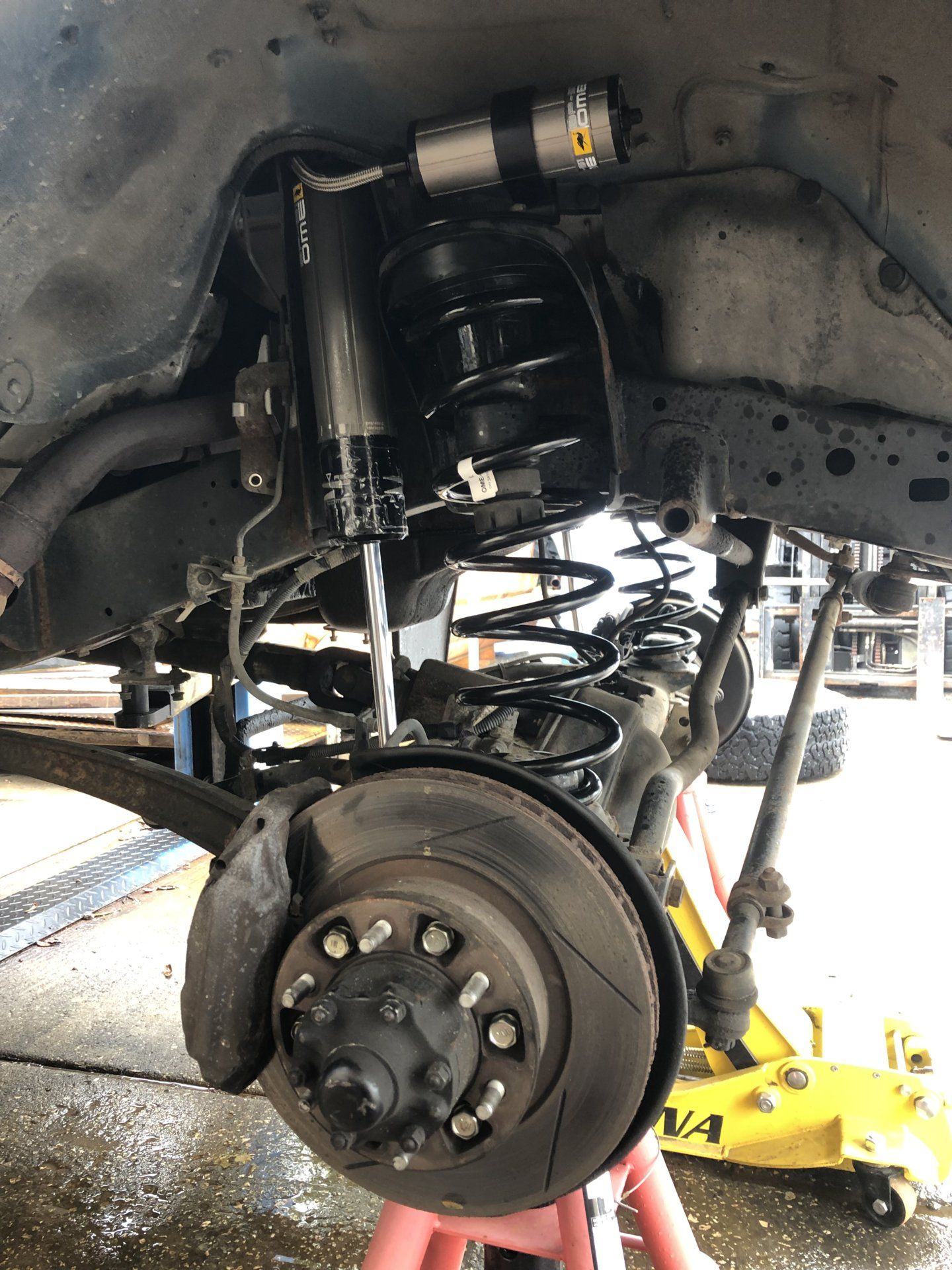

I have several cruiser builds ongoing and had to enlist the help of my buddy @ca18sean to assist with this one. The first project was finally getting the BP51 setup installed.
Huge improvement over the stock setup that was starting to show its age. I now have the OME BP51’s on three trucks and love it so far.
Everything looks so clean and high tech. Performance is nice too with a silky smooth ride. And the overall stance looks great.
