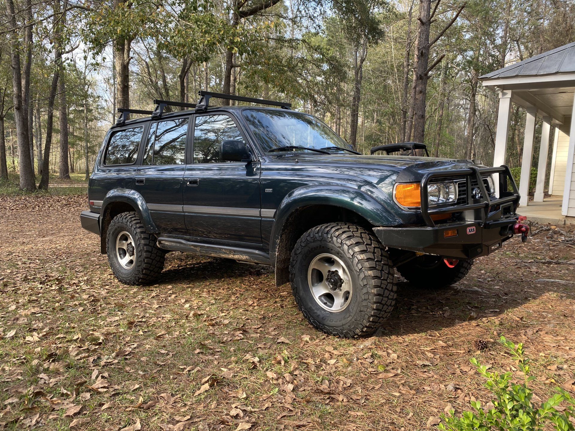

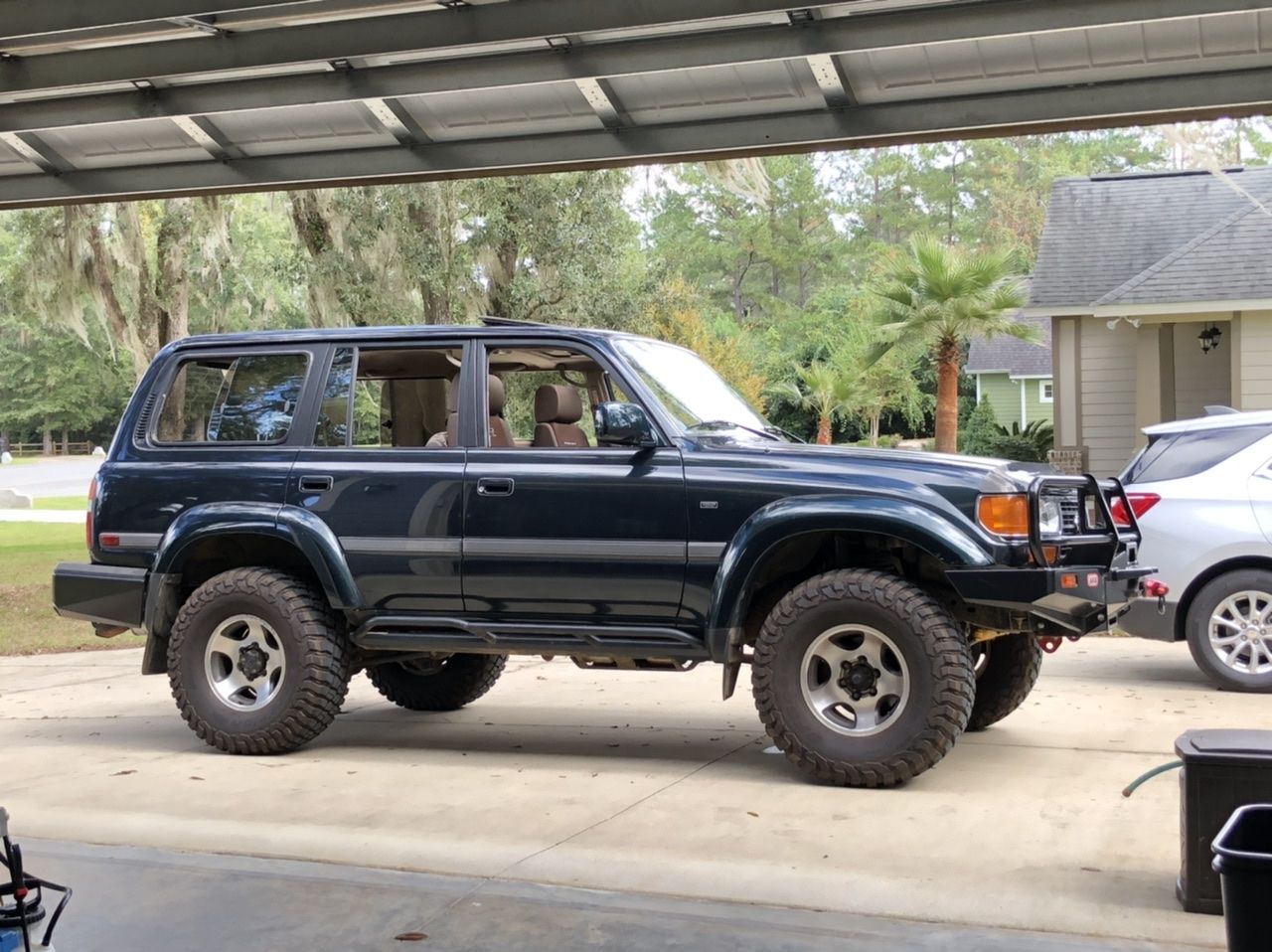

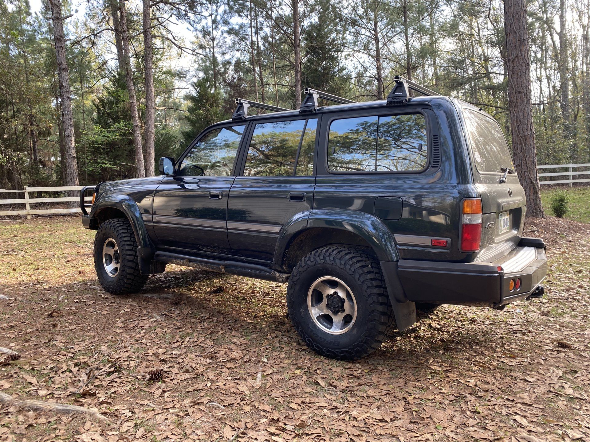

That's a really nice looking truck. I really like the green, but I'm partial to gray interiors. I haven't seen many green 80's with a gray interior - did they make m/any?
The roof line with no factory rack and no rear hatch wind deflector looks great. I think it looks a lot better than with a big rack, or even the factory rack. I have crossbars and on awning on mine full time, and I go back and forth about removing them. The awning is useful in the SoCal sun and desert, but I do think it detracts from the lines and look of the truck. The 80 lines are just so nice on their own, there isn't much that improves the stock look.
Nice truck, nice seats, nice Porsches! Carry on!
@bicycleagent003 I feel like the pre 95 green 80's often had the gray interior but the 95-97's seem to be in oak. But that is just my un-scientific opinion. I do agree on the roof rack comment. I bought a Rhino Rack to put on this truck but never did the install. I may put it on during the summer for hauling canoes but will probably take it right back off when it cools down. Thanks for the compliments!

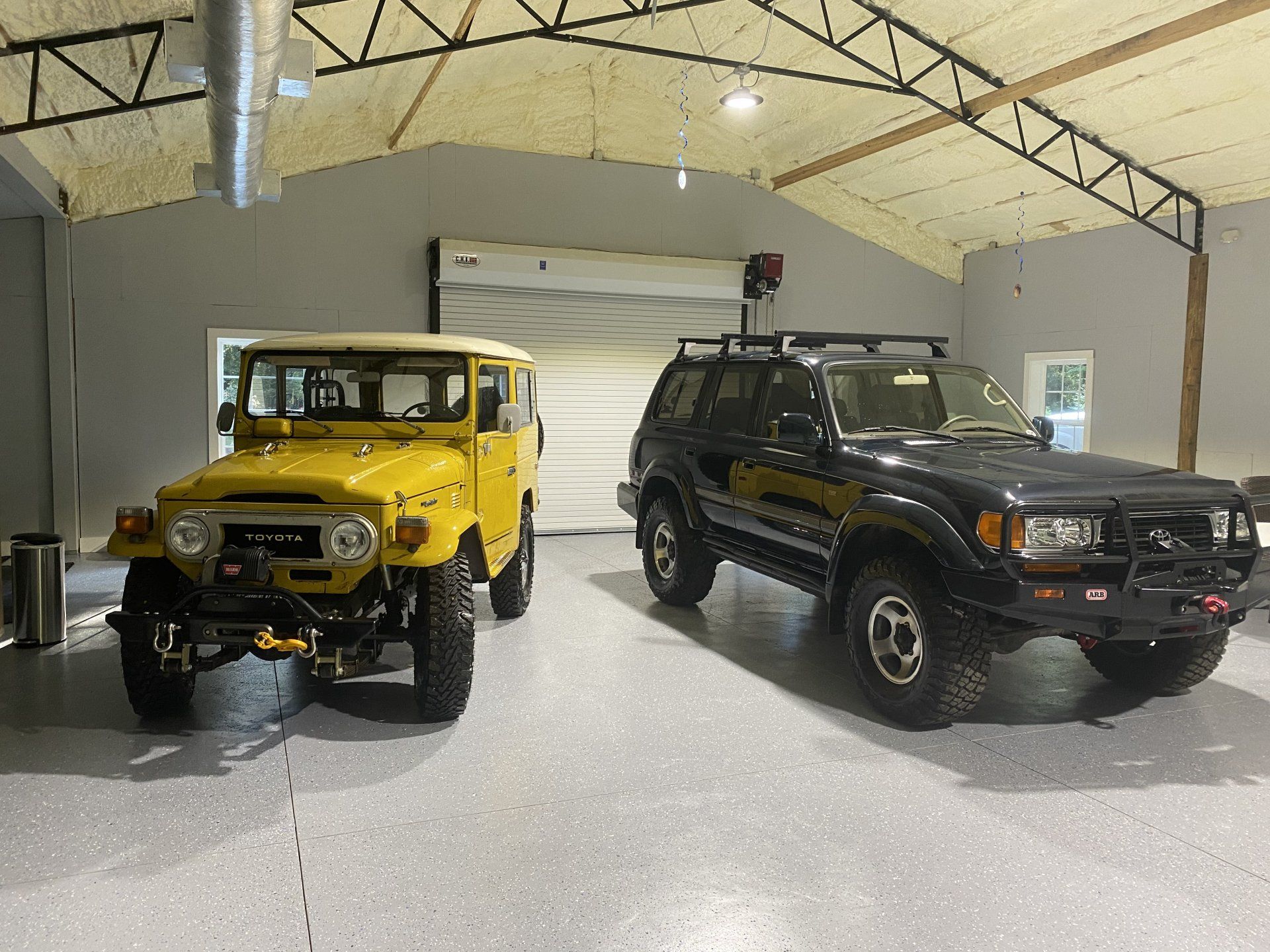

It’s been a long, slow journey to get this barn built. My epoxy floors finally hit their cure date and I washed up a couple of cruisers to finally get them back home. I had a couple here and a couple there. The green 80 really looks good inside though. I know there are some haters for the 6M1 but I think the color change from green to black and some blue look really good under the lights. Only downside is the green 80’s life in this spot is short lived. I can probably stack 8 cruisers in this space but really only 5-6 comfortably. Unfortunately, it’s not gonna make the cut. I’ll need to clean it up a bit before I try to find a new home for her but she looks pretty good right now.

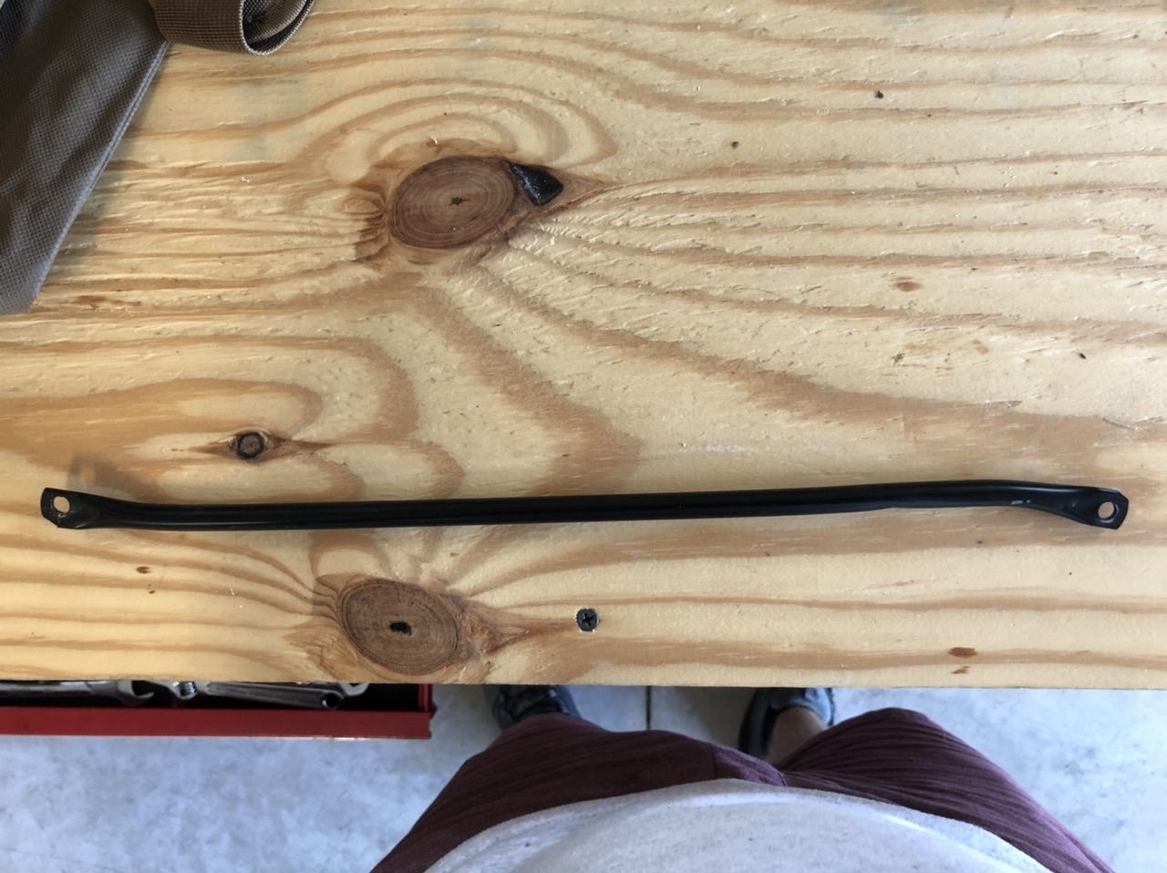

Rear driver side seat just would not latch to the floor. Spent probably 30 minutes tinkering with the latch and disassembled the seat making adjustments with no luck. I looked a little closer at the rod that raises and lowers the latch when folding the rear seats (a really cool and simple design that I got sucked into after seeing how it works) and found a small dent. It looks like when the seat was being slammed back down into place, the rod probably smacked a rock and bent the rod out of shape. This shortened the lever throw which wouldn’t let the latch extend fully for a functioning grab. Popped it out and straightened on my vise. Good as new!

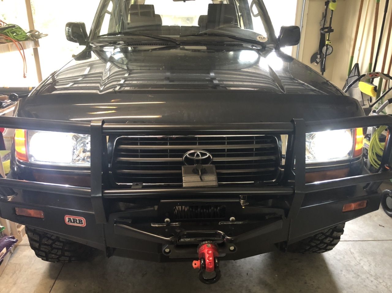

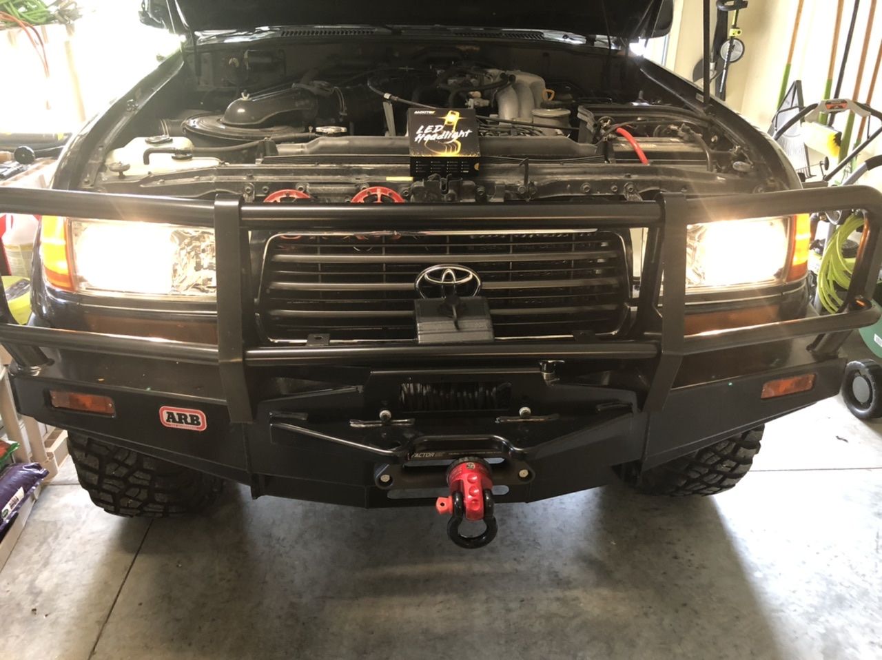

Changed out low beams for LEDs today. While I certainly like the light output, I’m still undecided if I like the color temperature. Seems a bit too removed from OEM, but I feel they are pretty white and not blue at least.
Silverstars then both then LEDs
