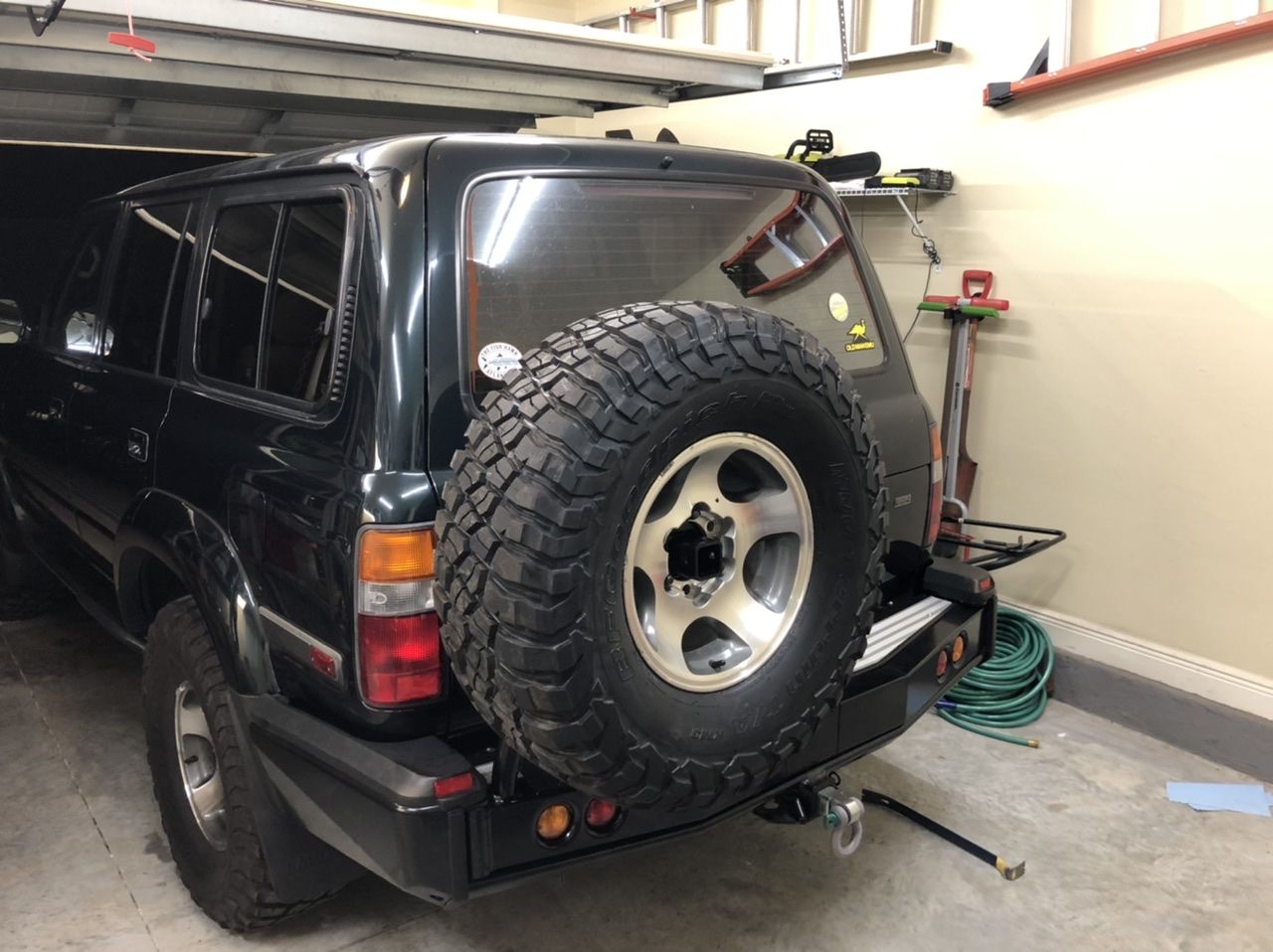

Changed front/rear diffs and transfer case over to Redline. Also changed out 24mm fill/drain plugs with magnetic 10mm hex plus with steel/aluminum washers as necessary. Will be running new breather lines for diffs/transfer case/transmission soon. Have a temporary solution, but waiting on a pretty central manifold to be created.
Came up with a way to lug my bike to local trails, but need to go back to the drawing board for a 90* turn to suck it in for travel. Will create some mounting points for lift and such while I’m at it.

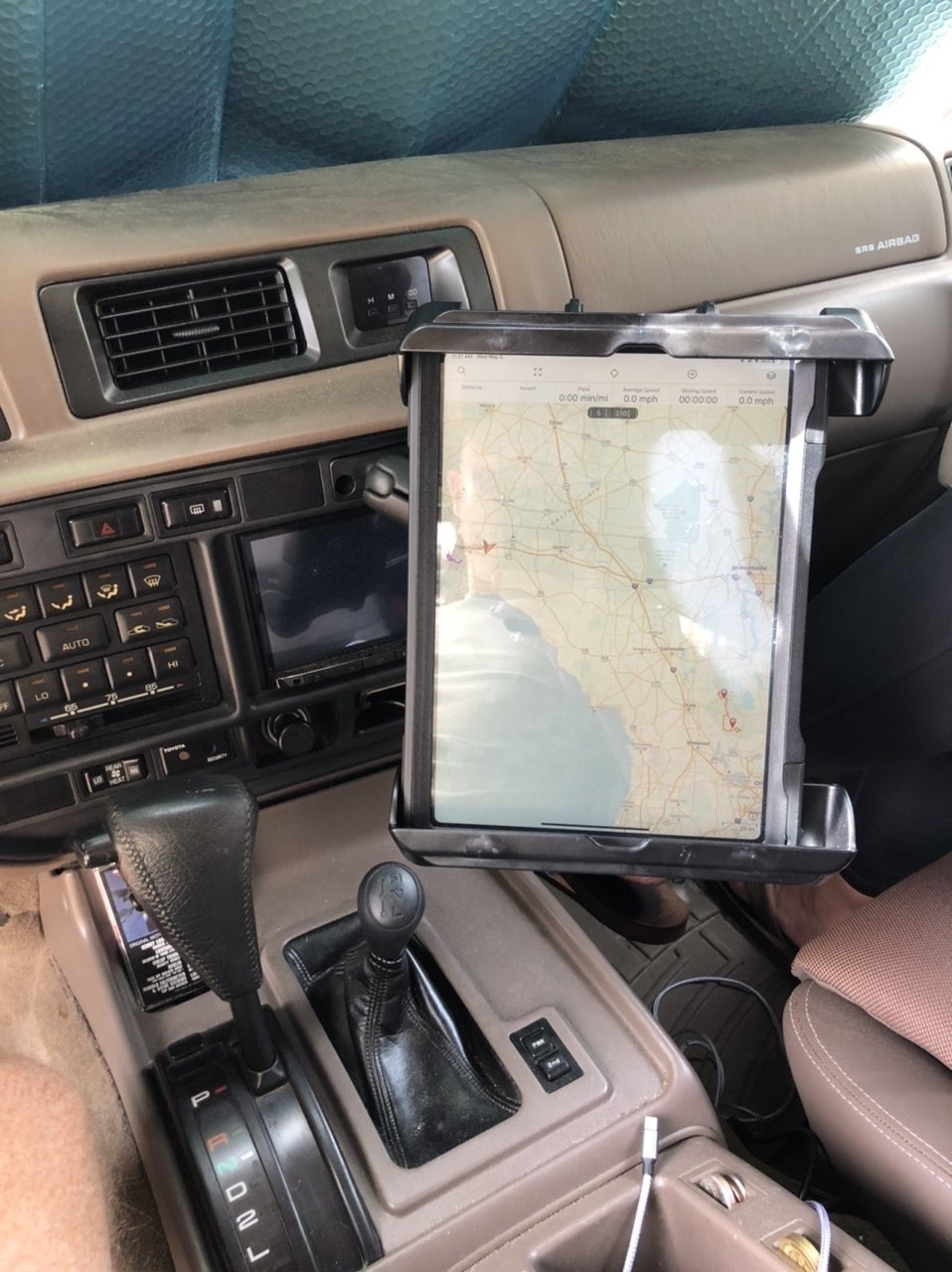

Grabbed @NLXTACY Useless Cubby Insert with some RAM parts for my iPad. Works well and doesn’t seem to interfere with my wife or any other controls. Will eventually do some wire cleanup to run through the dash, but this works for now.

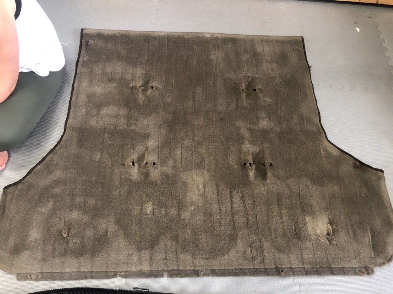

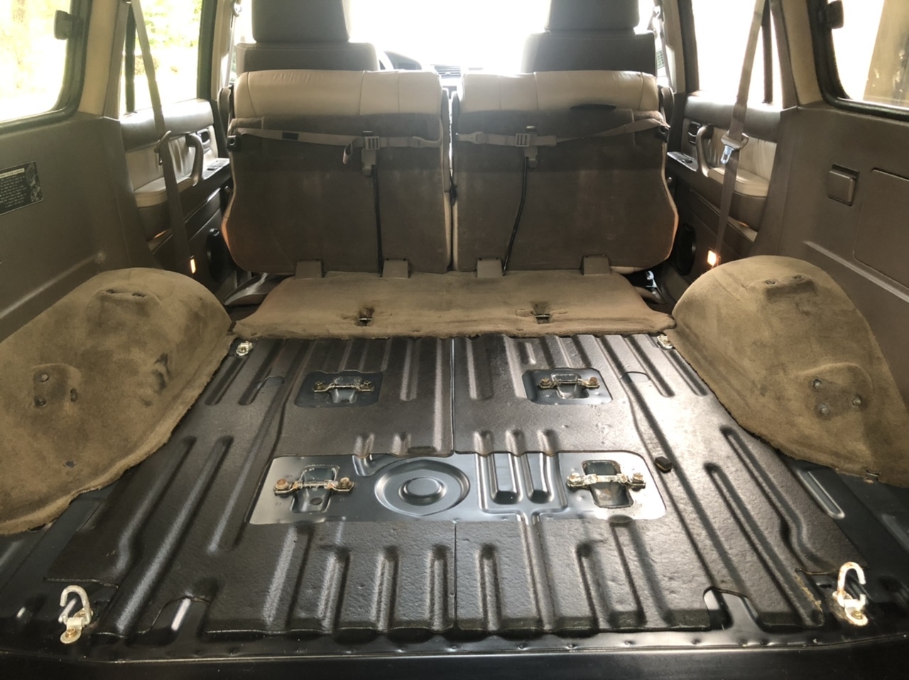

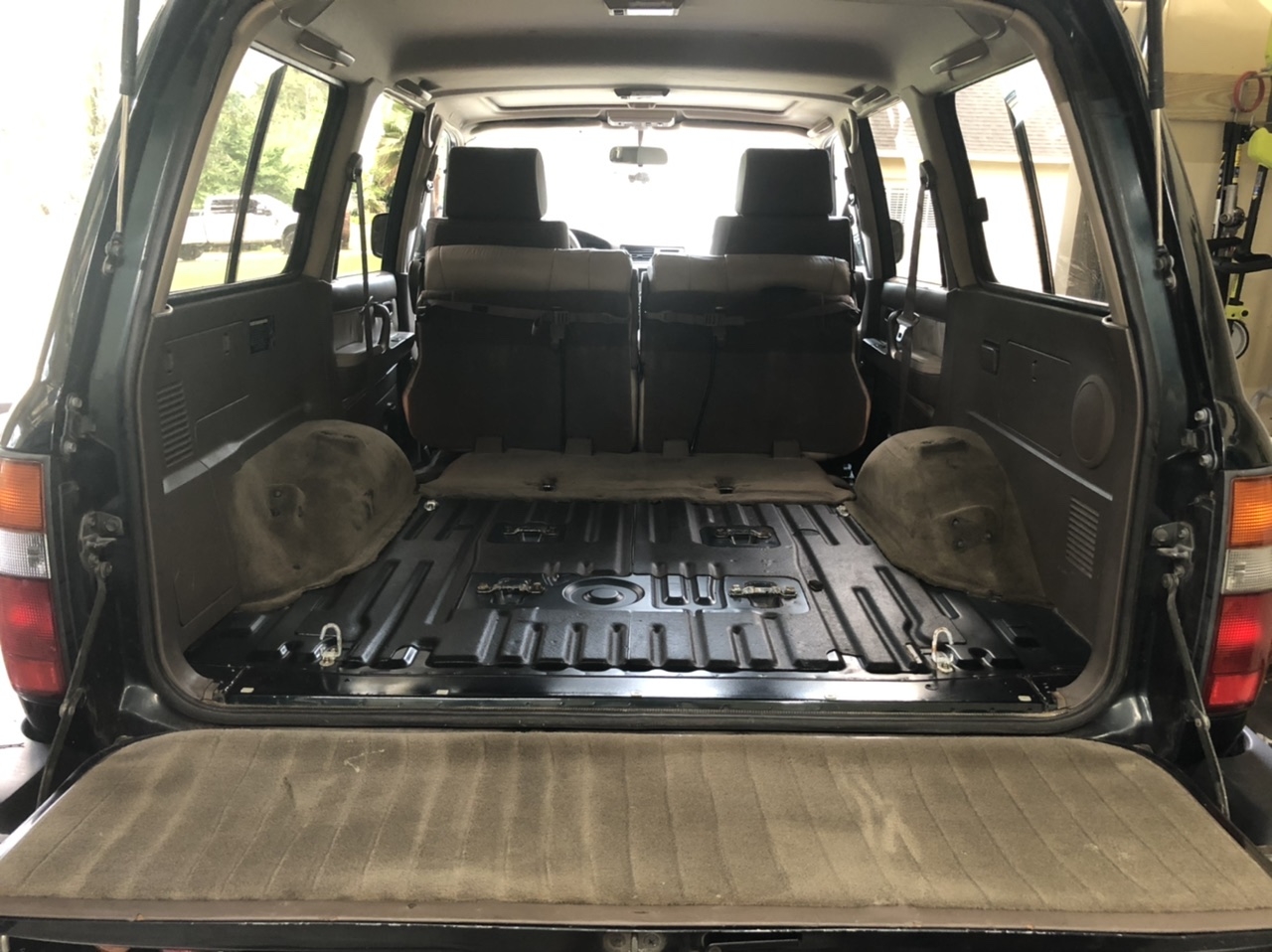

Did you rent a steam cleaner?
I’ve got a carpet brush attachment for my drill. Does a mega deep scrub with a diluted carpet cleaning solvent. I vacuumed the carpet out prior and the drill brought out so much more along with getting stains out. Used my shop vac to get it finished up. Can’t source the back carpet set, so gotta take care!
Just elbow grease and a decent amount of time for the tub. Will do the same for the front half when I swap out the carpet.
Thx!

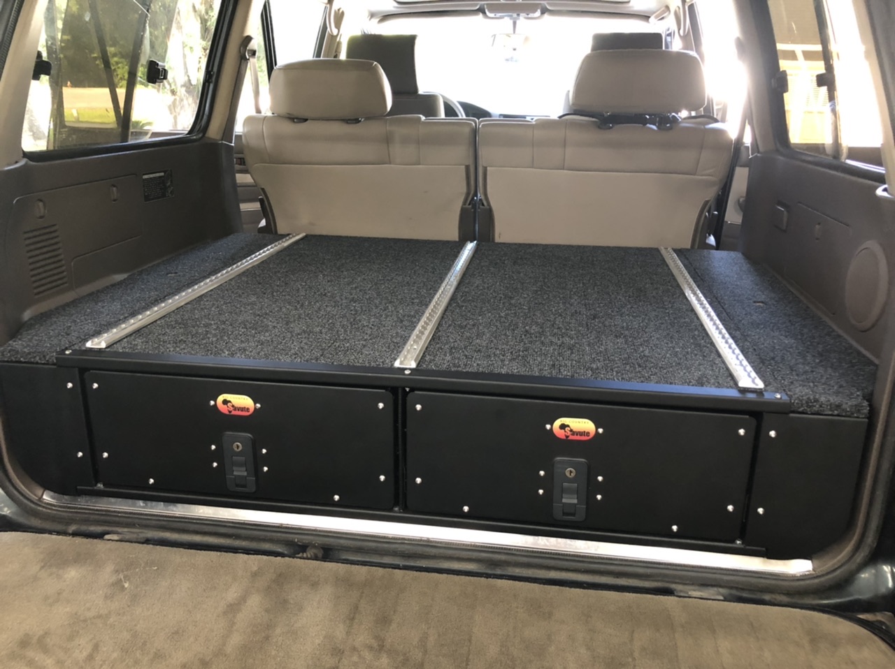

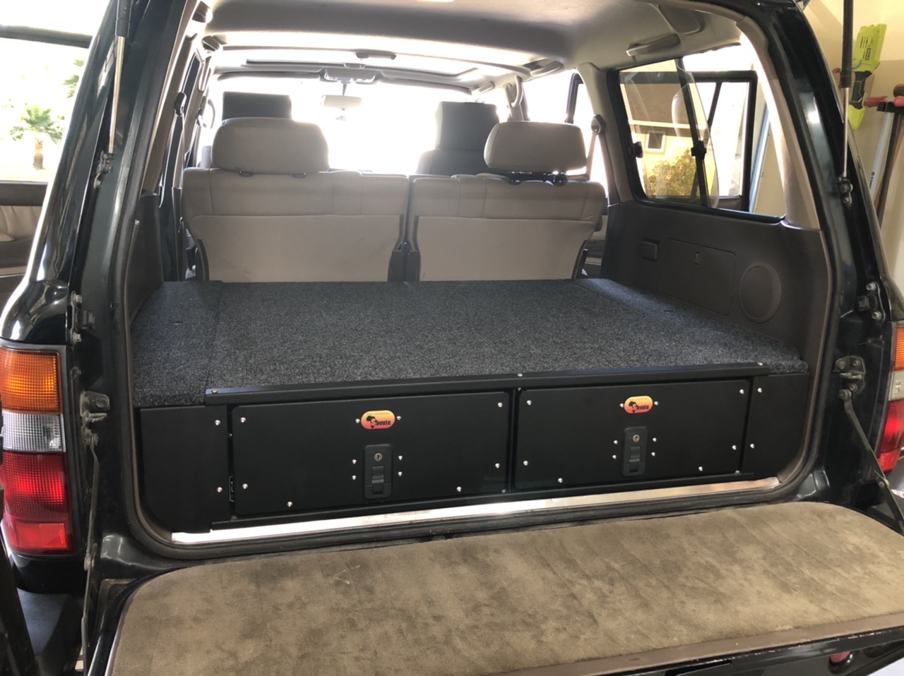

Finally got around to installing these from @RuggedBound
Turned out better than I had expected even! Pretty straight forward install and a righteous fit. Excited to start organizing. Fender measurements show I lost about 1/4” in height, so may need to tweak rear coils depending how it goes once loaded out. BP-51s will be up to the task.
Up next is getting L-track in place, but holding off as I decide for a “fridge” slide out. I’ve got a large RTIC 65, but it’s just outside of typical fridge dimensions, so time to get creative. L-track mock-up for now...
Also waiting on the fancy seat leveling blocks from @Outsane so I can get a mattress in for camp. Looks like it’s coming together...
