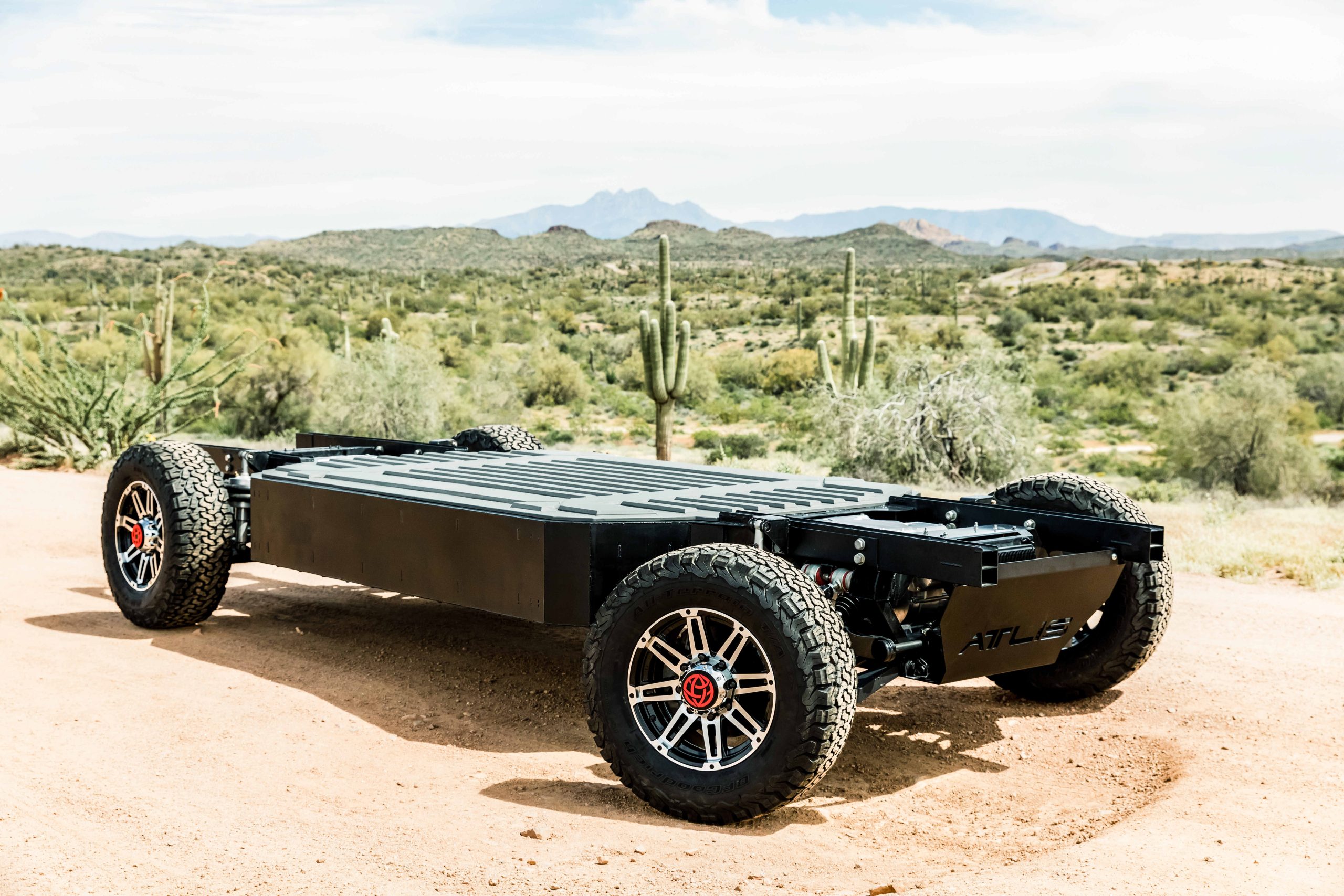

This concept might be of interest to those following this thread, a $27k+ modular electric chassis/platform:
You'd want a hell of a skid plate under it though!
