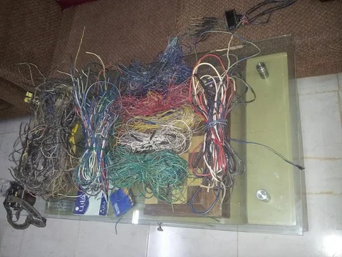

sorted out the wires....various colours and sizes....with the far left being the 'rest of the bunch'.......
will be using
-blue and green for lights
-red and yellow for combination meter and dash switches
-white for earth
the wires on the left between junk and colours will be used for relays, the ones on the right (heaviest) will provide power.
besides the ones i bought the other day.
driver side will carry lights n stuff....passenger side for audio
will try to organize all wires to engine bay from driver side....trying to avoid the multi entry to compartment shaped harness...for the engine sensors, A/C and Alternator, will drive them to the firewall and to the wire combo (driver side)
each bunch will have its own hose which, which then all combine to connectors before going into a larger hose to the inside of the cruiser.
sounds reasonable?
Sounds like a plan. Whatever you do, you'll be in better shape than you were when you started. Just take your time and it'll be great.
It definitely is better than before. ..but did mr Toyota design the harness their way for technical or plain manufacturing reasons

On the wiring, use as large of wires as you can for the wiring harness, particularly for the power wires. In DC voltage, the amperages are high which increases the heat due to current flow. If you go with a larger wire, the current loss (through heat) is reduced and the system works better. If in doubt, use larger wire. Mr. T used the wires he did to A) reduce cost, B) reduce weight. I think those two items are the least of your worries.

Thank you very much...very informative...especially the wiring...i did have concerns that things will melt AGAIN...u helpfully cleared that up for me.
