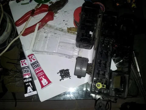

after doing a few tests on how much wire i need for each part of the LC....and modding my new (second hand) relay box RB2....started to install, solder and tape the wires to terminals and clips for ease of removal/revision whenever required...
the relay before..
the operating theater
and the final product

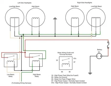

disregard the previous image i did for the hi/lo beam connection....i got the idea to provide a separate relay for each...word is, it gives much better light on the same bulbs....http://www.danielsternlighting.com/ ...worth reading
the idea to connect them etc was from the circuit of wired wagon....a beautiful product that, unfortunately, i cannot get my hands on here :frown:

circuits used...or source of insperation
cant remember where i got it from.....but, works for me...plus i added an extra relay and fuse for the off road lights on the brush guard

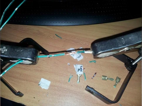

Home made soldering lab
after looking through maybe about 30 vidz on youtube on how to solder properly...i decided ...i need one of those gizmos that clamp the wires for me while i solder....was previously using 2 pliers...one to hole the wire down, the other to weight the other end down....
so....i got the clamps (not the disease, the handles :D ) from an old Need for Speed game steering wheel...yes im a computer geek in my not so muddy life.
Used epoxy mix glue (guess u have JB weld)
and voila.....my own "high tech' soldering, static, non moving robotic arms.
first test....
VERY happy with the result.:bounce:..this was the first time i ever saw soldering flux in real life.....it literally make soldering a piece of cake....

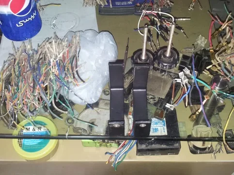

as u see in the previous post....i took out all the terminals from nearly all the plugs....been sorting them out to male/female and then by thickness (or guage).
did a breakdown of what i want connected, through where and how many wires come together at a certain place. this allowed me to decide what connector plug to use and what wire guages to use.
mainly:
- 1 x 9 wires at each door (2 audio, 2 door lock, 3 window and 2 the new courtesy lights) the window motor i intend to ground locally instead of going all the way back .
- 1 x 20 pin for the rear (to include rear hatch wiper, rear speakers, hatch lock, hatch light and tail lights + an additional 6 pins in case i want to add something later on.
- 2x 10 pins for the power sources and in engine relay switches.
- 1x 13 pin for engine sensors, fuel solenoid and reverse switch.
and so on.....still sorting out how i want to connect the dash wires and center console wiring.
any help/advice is more than welcome

I have concerns about your plan to not ground the windows except locally. I may be way off here, but Toyota didnt ground anything to the door and there might be a good reason for that. Maybe its the possible moisture (I know youre in the Sudan) or maybe the door isnt a safe or effective place to ground, but I just thought I would raise my hand, so to speak.

i totally agree....i re-thought the idea of grounding them on the door and the issues of future diagnoses if ever needed....i might go for grounding them with the seat belt bolts outside the pillars, but not all the way back to the main switch like previously.
