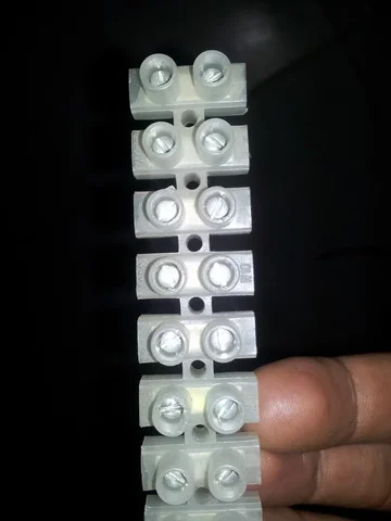

Would this work ...
Im trying to get the wiring sorted out... and found plenty of links in the EWD get the same power source from either FL Main...AM1....or from the ign switch...im not a keen fan of splicing power lines....would adding this electrical connection thing i got from a shop work...
it sort of compensates the lack of having a power outlet box...

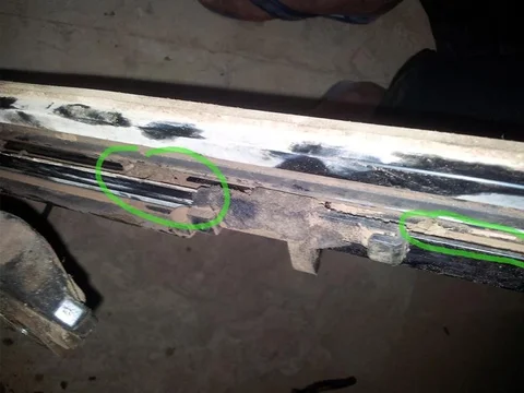

thought to start with the sunroof....bit of cleaning and get it back in....but guess what....the rails are so dirty they are STUCK shut....guess when it started to leak the PO left it 'leaking' for sometime from the sights of the headliner....the water must have crept into the rails and just filled up the rails and tubes with all the dirt it could carry...
applied penetrating oil (yes it does sound dirty but its actually called that)..will leave it till after work tomorrow....no power wash tomorrow :bang:
The rail...look at that dirt...had to remove it with a screwdriver...yes, the same one that stabbed me....
the wire that moves the sun roof....not clear in the pic, but that thing is brown in colour....i mean so dirty the tubes dont budge a mm......lightly tapped the tube with pliers and it started moving....
will need to clean and lube the whole thing.....
