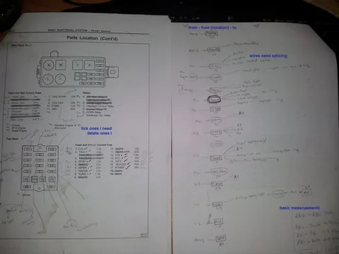

The Plan....so far
well....here is the layout...very draft....to what i need in terms of fuses, relays, wires and splices.

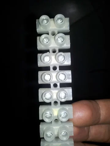

could any of u advice me if these would work for connecting for example the FL main to a number of fuses/relays....or would i be better off with a thicker wire and splice into it for each connection to fuse/relay box?
