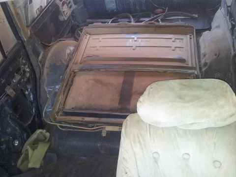

next up...remove the whole moon roof enclosure.....first i have to remove all the silicone the PO sealed it with

Moon roof done
18 bolts...one silicon removal....and its out....removed the glass first....then lowered the rest of the enclosure down....was so full of dirt it actually didnt move ... i thought i forgot to untie something.....few taps here and there....and i needed another shower
