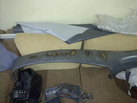

and dashboard
as u can see the door panels are soggy, cracked and have no way of being held on except by screw..the dashboard is cracked on top, but still in one piece...

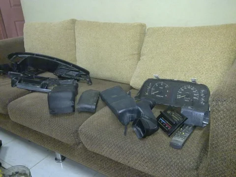

other parts
various...
the compass/altimeter and pilot lights console

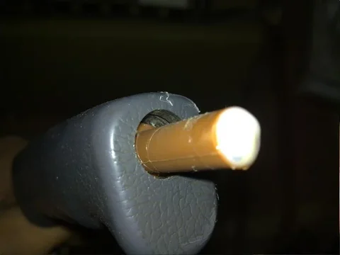

and INTRODUCING....custom made hand break release button... cut and filled with epoxy resin....left to harden.

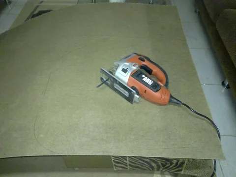

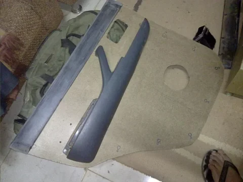

Back from work....i decided to pick up some whats its name wood....did a quick draw around the current door panel to see how it fits...remember how tight my garage is...so this is just a "rough sketch" kind of thing to decide what and where to install 'gadgets' on my doors.
Stripped the leather on the top part that sits on the window opening to also redo, was too dry, and in some parts, torn or cracked.

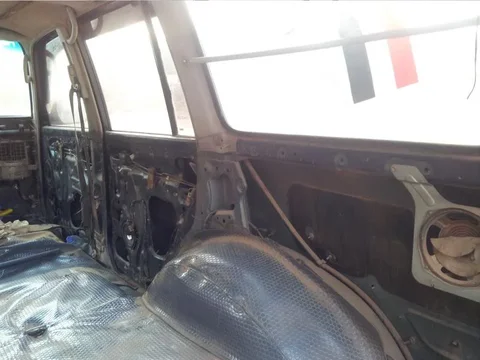

I will probably move the cruiser out of the garage so i can remove the seats and take proper measurements.....
would anyone advice me on the headliner please....mine is VERY dirty and im sure i will also find burnt wires etc.... the moon/sunroof is sealed up with silicon ...guess the PO just didnt care....but having kids, you KNOW that it has to function....its one of those things my kids love....they actually measure how beautiful a car is by just having a moon/sunroof....
