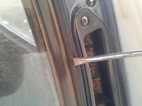

Remove all garnish, screws, handles, tweeters, weather strips....the lot...
done
be very gentle...this is 20 year old plastic...insert a long screwdriver and gently pry out the retainer clip...located closer to the window then the rear hatch. Support the trim with your other hand and watch that the screwdriver doesnt start poking the plastic....it will definitely break

turns out the rear quarter window isnt sealed with any glue...just a weather strip....thats what u get for working without a proper FSM.:doh:
u have to first run a screwdriver around the outside to loosen it from the body
do the same inside

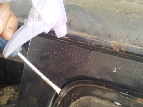

The removal toolset - screwdriver- water and dish washing liquid soap....just depends on your preference...i use fairy liquid in lemon scent...they say its good on the hands.....:D
With the screwdriver..pry the weatherstrip slightly (but enough to see the grove that sets the window in)....and spray as much as u can....moving bit by bit....for ease of accessibility, i started from the top...that way gravity too can help move the liquid around the window.
Then start bending the weatherstrip from the inside so that it is sort of flexed...makes it easier when ur moving the window outwards...i started from the top rear corner...with the screwdriver anchored to the window opening between the metal and the strip....i pushed out with my hand...NOT the screwdriver or u may damage the glass.
voila.....done....just shows how good a hand job can be....:censor:
i was literally shaking, afraid it would pop out or something...finding a spare here is possible...but its not what i would like doing. Turns out it is very light and because of all the dirt inside mine...it literally waited for me to lift it off...

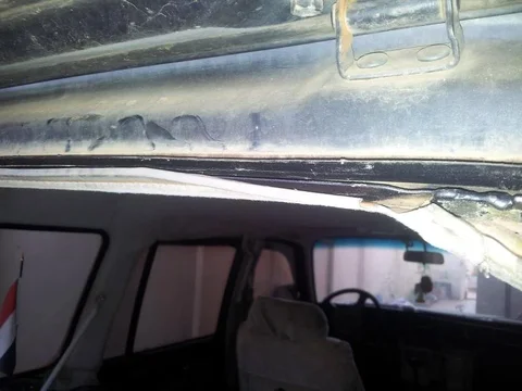

moving on to the driver's rear door..... slowly removed the adhesive prying slowly just underneath it....then with both hands, slowly peel the headliner wrapped around the door opening.
then you find these.....i guess the are found wherever a handle is attached to the headliner.....simply its like adhesive duct tape kinda fabric.....hold onside with each hand and peel slowly....u may need it again if ur returning the headliner.
keep in mind while removing the headliner, there are plenty of those small metal clips i showed earlier....
once u remove the adhesive fabric thingy....MOVE back...i got an eye full from the amount of dust/dirt.....

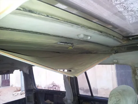

as u see from the image....wherever the headliner is sewn, it means its attached to these metal rods that are hooked on the roof.... will probably have to move the car out of my super tight garage to work comfortably on the other window and these rods.
94 vx Headliner removal...part6
Continued to remove the other rear window, door side headliner wrap and the moon/sunroof trim and plastics etc.
down came that part....only remaining parts are those well rusted in rods and the windshield part ....the later one i will just cut with a blade for now, as i dont intend to reuse it and will remove the windshield once i go for paint
