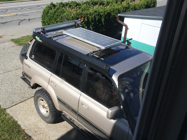

Photos of your setup? :)

It's really basic. Panel bolted to a couple Yakima cross bars:

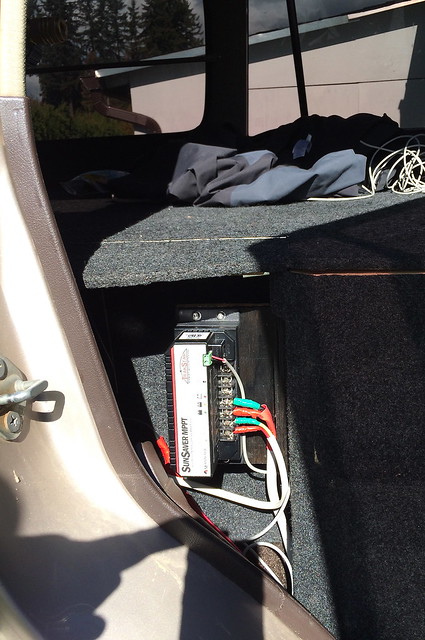

Marine wire into the truck feeds the CC:
And more marine wire along the rocker channels through the firewall to the batteries.
I still need to rig up a wind deflector of some sort, it does make a bit of noise... though the 81 is a lot quieter than the 74 so it's not a huge deal.

Sorry to thread jack but in this picture you have 2 each, 2-wire cables coming into your bus bar. I guess one comes from the panel? How would you run this for 24 volt? (Your 80 may be 24 volt, I'm not sure.) Thanks
That's the charge controller. The 2 bottom 2 wires are the input from the panel, the top pair are the charging output to the batteries.
The HDJ81 is 12V (with the exception of momentary 24V for starting). For the 74, I have a pair of 12V 50W panels that I'll run in series for 24V, through the Victron charge controller which works for 12V or 24V, to my 24V battery array. Easy peasy.
