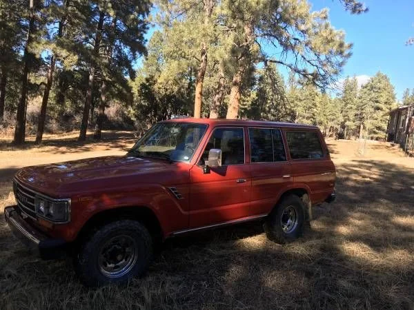

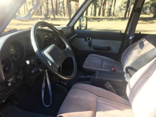

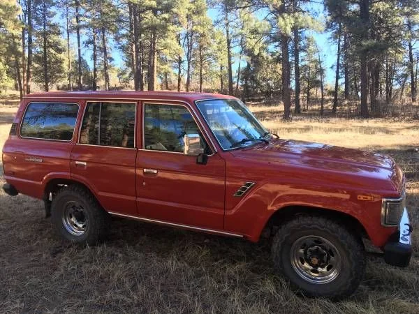

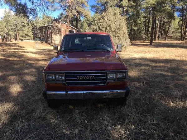

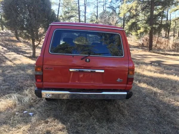

Thanks for the reply! The mechanic we talked to said the job would cost $1500-$2000. He said that the valves were clogged causing two of the engine's cylinders to stop combusting, so right now the car is still drivable but is lacking any power since it is only running off 4 cylinders. As for pictures, this is what I have.
The body is in pristine condition with no rust, the car is completely stock, and the owner is asking $6,000. The interior looks brand new and all of the electronics still work.
Looks like a really nice rig. If the mechanic literally said the valves were “clogged causing 2 cylinders to stop combusting” you should seriously seek out a 2nd opinion, and probably not go back there... Have you looked for a local cruiser shop?
