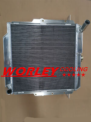

look at ebay. There are a number that are sitting in US warehouses - that are really inexpensive. I assume someone imported only to realize there are no 70 series rigs in US. Not sure if they are diesel or not.
I just got this one for $140 shipped. 3 row. Using for my LS swap.
The outlets are wrong on at least that listing. I have looked before at the ebay aluminum radiators, but I haven't heard the best track record for them. Mainly, mounting points breaking off/cracking. It appears all of the BJ74 radiators on ebay are from the same chinese factory and sitting around $300.
