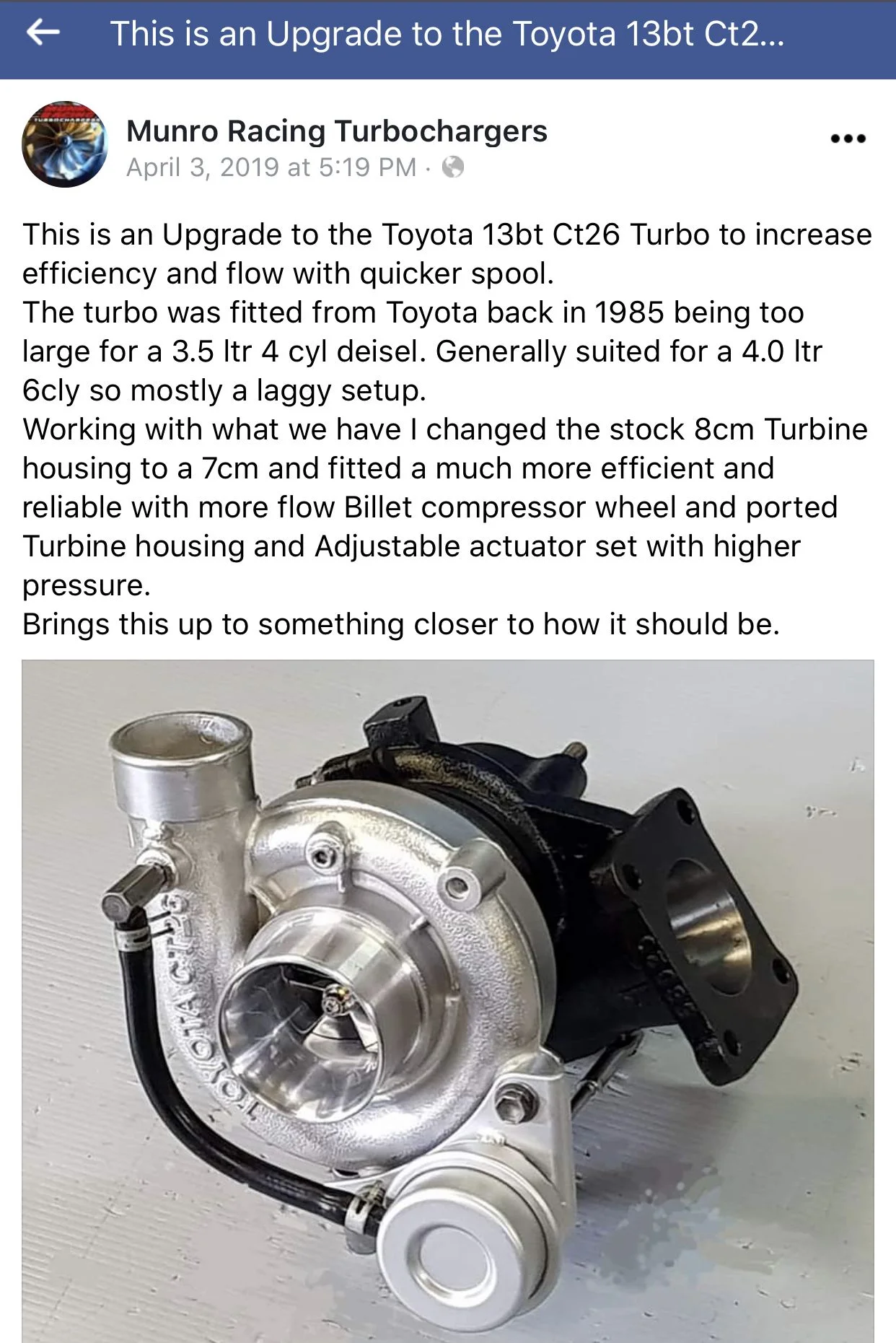

Better Turbo - Looking at changing to something better sized for the 3.4L as the OEM sized 8cm CT26 is too big. I have some messages out to people about the best route to go here. had I known better, I would have done this when I got my CT26 rebuilt to begin with. On one hand I like staying with a Toyota turbo as thats just cool, but I know it's a dated design.

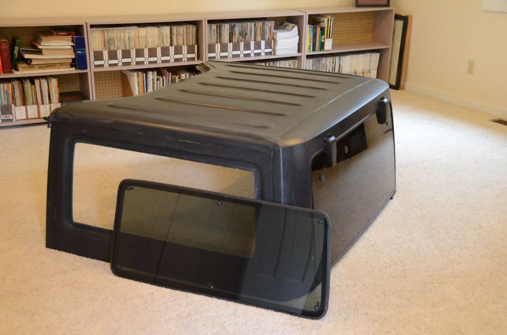

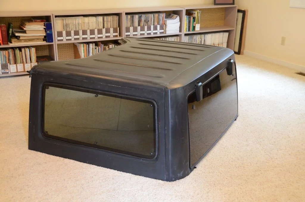

My first thought was to make a modular hard top. You can take the sides off for a safari top option, pull sides and top. Would make the whole thing easier to deal with removing/storing. However you still have those dumb doors to deal with, and a chunk of fabrication on an old top, thats pretty much impossible to replace. It is however repairable being fiberglass so thats a plus.
I also thought about finding a spare hard top and hacking/mod it. I might, but again they are hard to find.
So I found some threads about gull windows on 80 series, troopies etc which are pretty great, but not 100% useful if you have passengers in a BJ74. I believe some of the Euro rigs had FRP with solid windows for tax purposes. Having dog windows open, or kid windows is good air flow. Getting closer. I decided with RV windows they are replaceable so I could fit some sort of removable window or soft window to get almost a safari top type of setup. Those side windows are big on the 73/74.
Low and behold, I found a guy thats really good with fiberglass, hacking up jeep tops, modding them pretty much all what I had in my head so most of the thinking/design has been done and tested. Here is a good thread, albeit Jeep, about this guys hard top modding, and how he engineers it for other companies and such: Converting a factory JK/JKU hardtop to modular
The idea, pull the sliding windows out.
Repair/restore them.

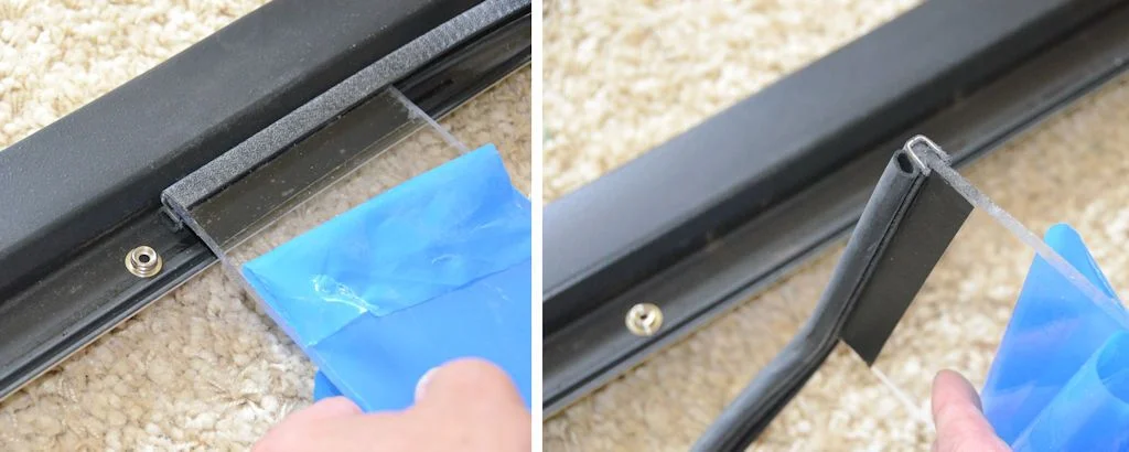

Get a piece of Lexan, shape to the window size. Put a sealing trim on it, and "lock" it in place with clips or something on the inside. Lots of options.
Pull these out for more of a safari top with hard top feel. Easily put back on in a storm and you are only out $60ish buck for lexan if you break it. You could use wood, aluminum whatever, gull wing, soft window (to roll up and store easier)
Window installed in top:
Taken out: you can see the clips on the inside. Lots of options here for latching.
Lexan piece and trim: The snaps he was using for a soft roll up window insert, which he said works fine with the hard lexan/trim setup.

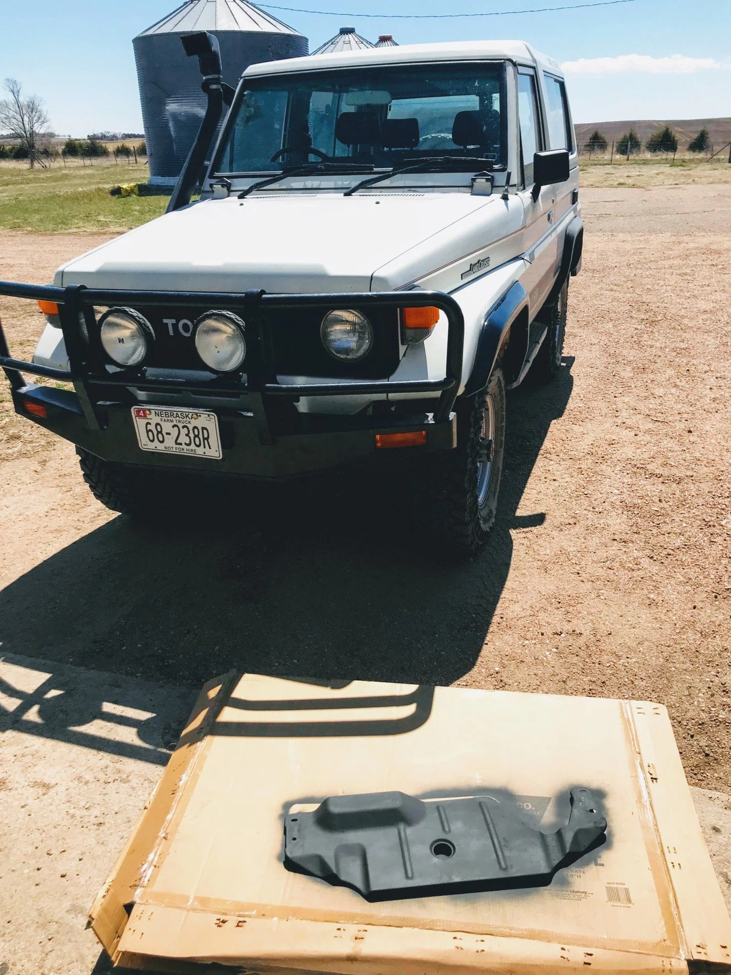

Also, in between the long list of outdoor spring cleanup, I painted the front skid plate. It was 72 degrees on saturday.

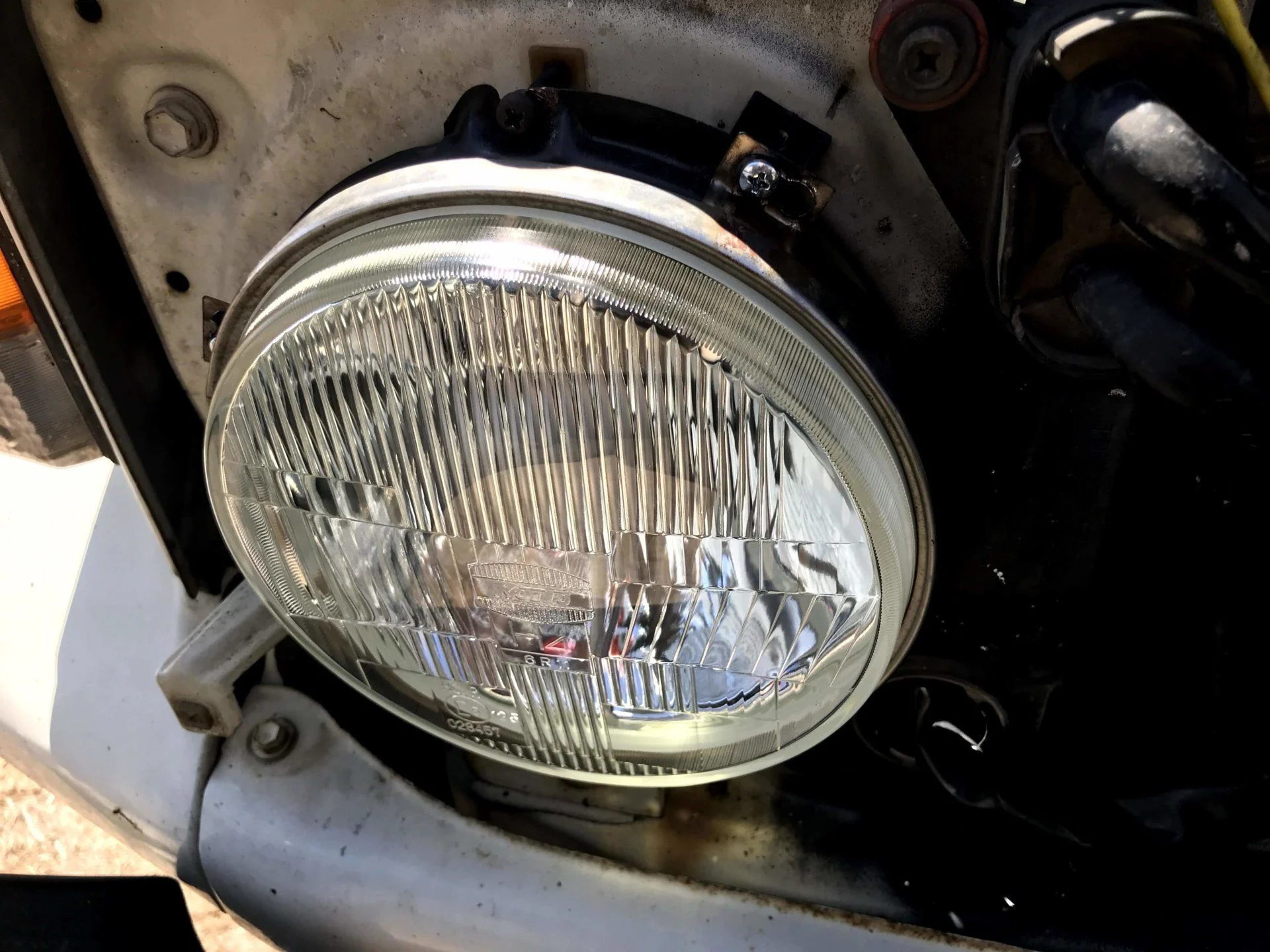

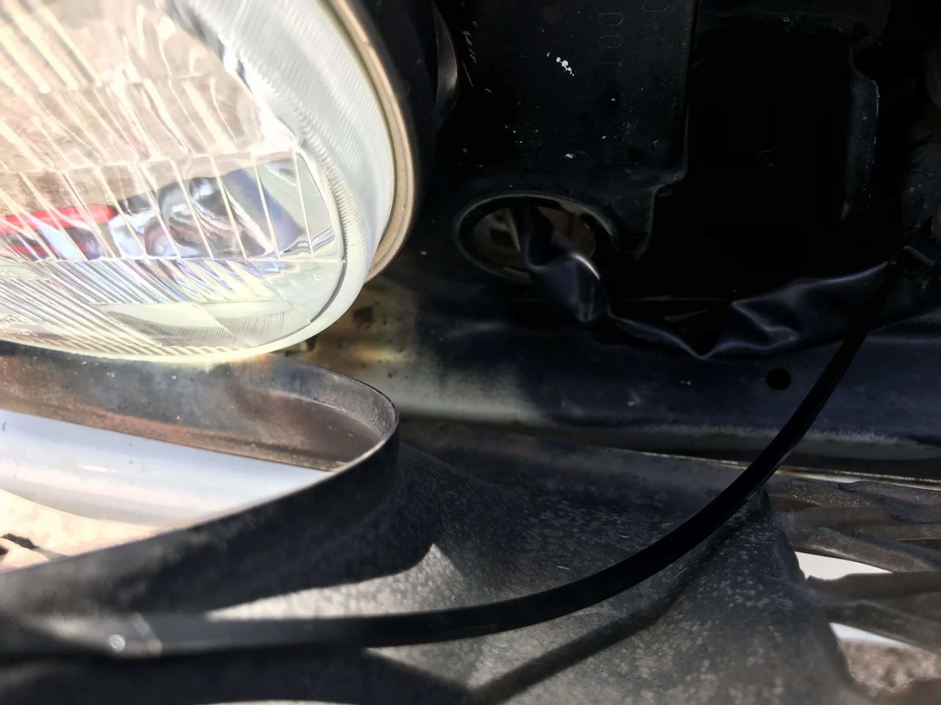

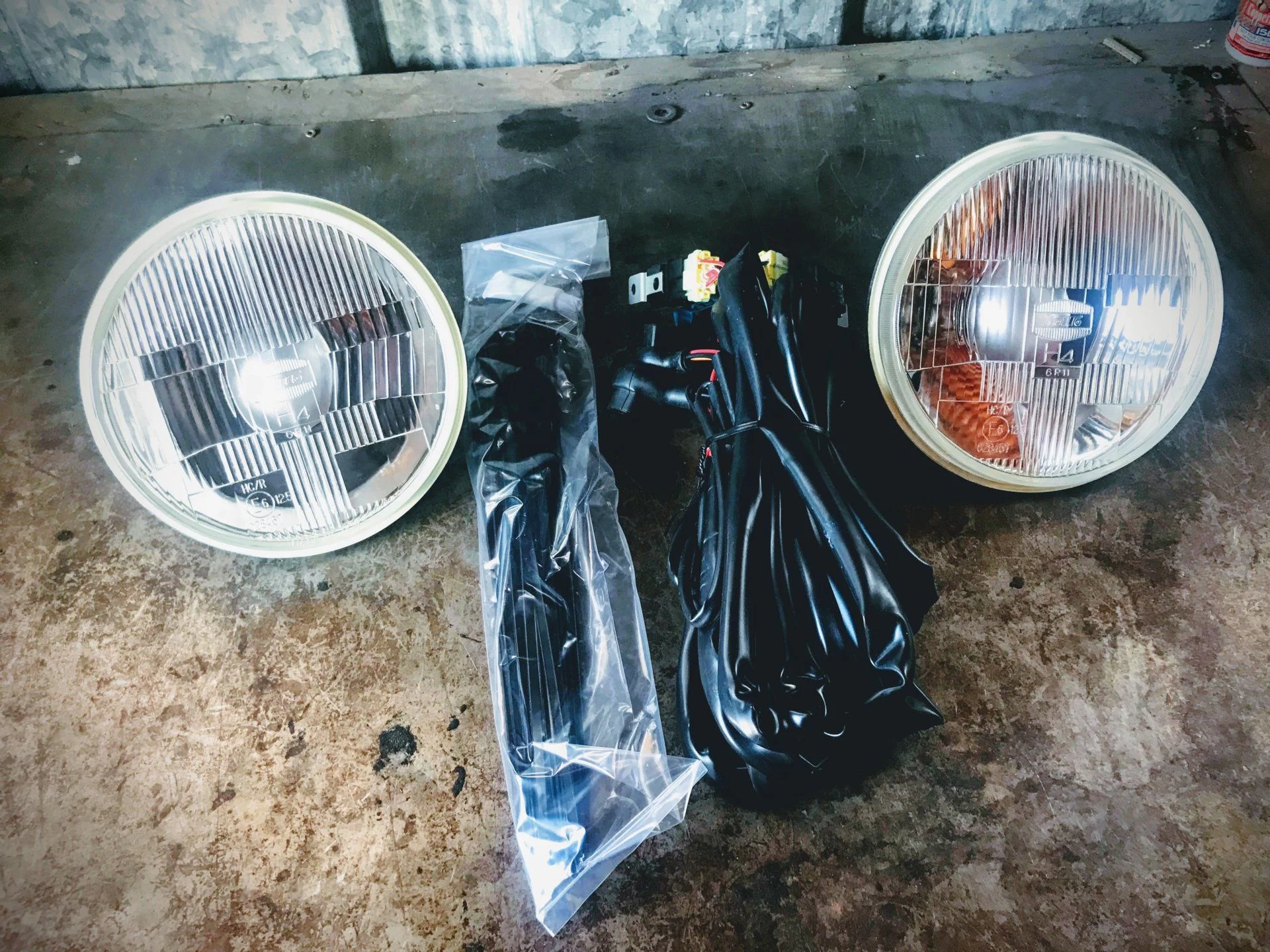

Upgrade time. headlights are weak on these for sure. These are OEM Koito headlights, possibly original, and they are tired.
I went with possibly the best, cheapest OEM Purchase you can make.
Toyota 81110-60P70
For those that don't know, its an OEM H4 upgrade for 7" round headlights for stupid cheap. I ordered from Bommarito Toyota in Missouri as they had the best price $56.62 shipped. I ordered on a wednesday, recieved it early friday morning.
The kit includes:
H4 housings
Phillips H4 bulbs
Wiring harness
Relays
Zip Ties
Dialectric Grease
1 banana job right? :rofl: We are working on old land cruisers.

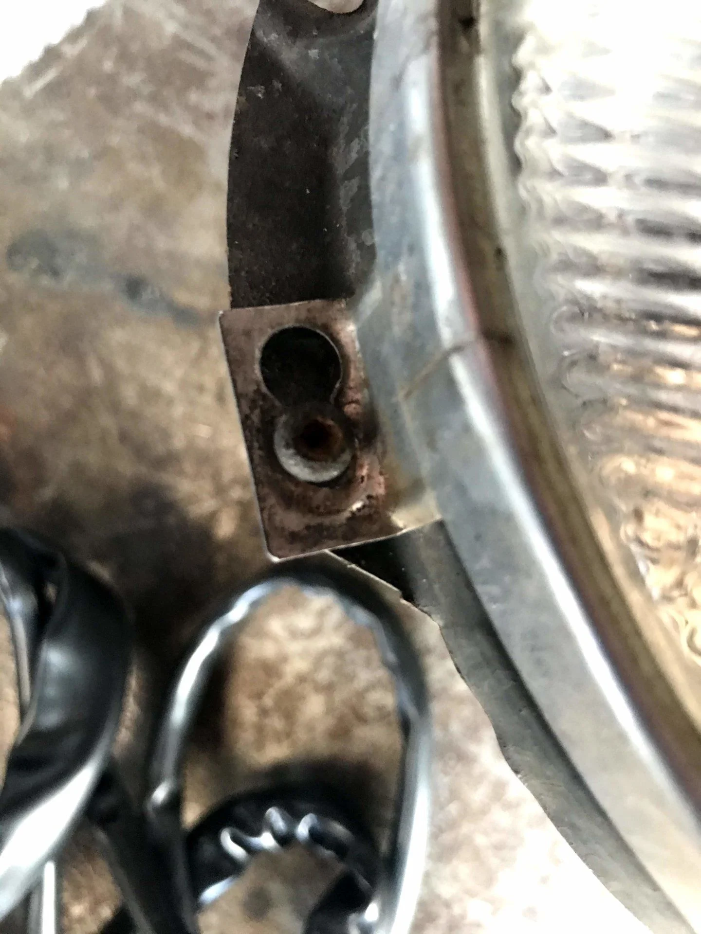

Pull the 3 screws that hold chrome ring that holds the light to the headlight bucket. Stripped out rusted screws, of course.
I ended up pulling the whole bucket out. Thankfully I could use pliers/vice grips/liquid wrench and they came out. Unfortunately I had to use cheap hardware as the store didn't have OEM Gold Plated JIS screws forged from the sweat and tears of Mr. Toyota himself.
On the list to order...someday.

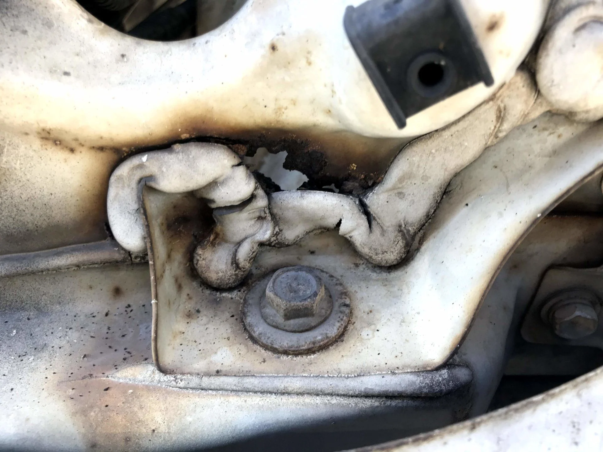

Oh yeah, this little gem was hanging out. :mad: Only on this side, and the only spot in the whole engine bay. I just put some paint/rust cover on it for now. Add it to the list.
Shiny new headlight bling that doesn't look like some terrible ebay chinese LED light.
Yes I do need to clean behind my grill. Watching any @c2dfj45 threads make me feel inadequate as a cruiser owner :D
There are rubber/plastic covers over these holes in the front of the 70 series. Not sure what they are for, but I pulled the plugs and ran the light housing through there. I will get a soft rubber plug to block off the hole all the way. I also ran the wires and tied them along the A/C line for the drier. I hope thats ok to do???

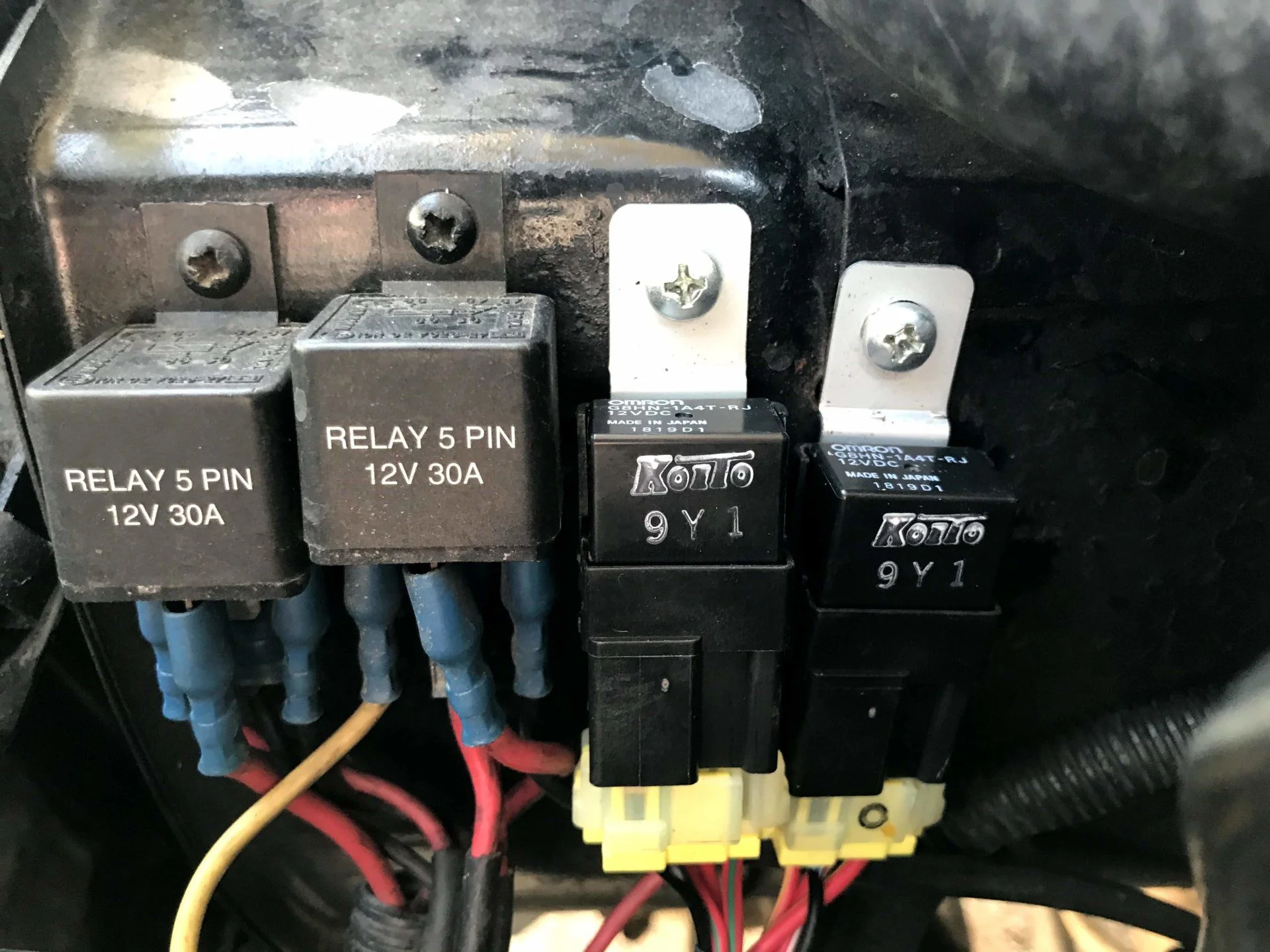

I put the relays right next to where they mounted the off-road light relays with self-tappers for the moment into the fan shroud. I will probably change this at some point. the engine bay on a 13BT is pretty packed. I should redo the relay wiring that the Aussies put there, but for the moment it works and is low priority.

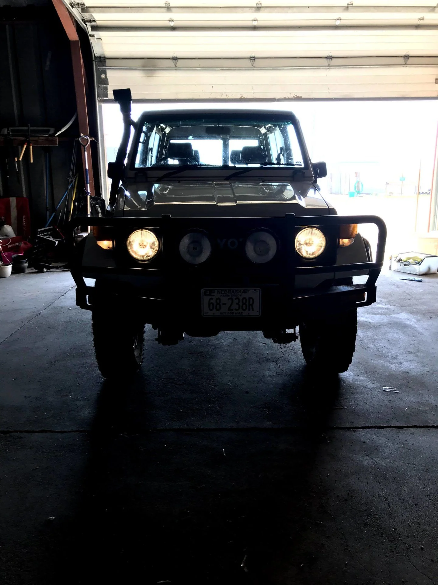

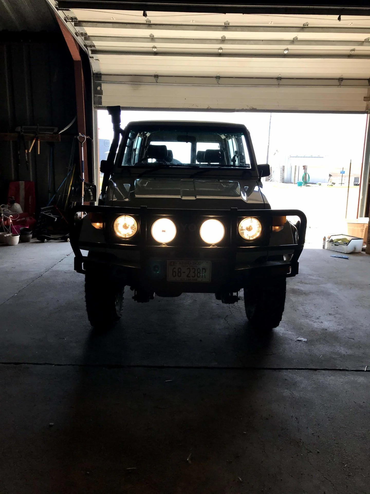

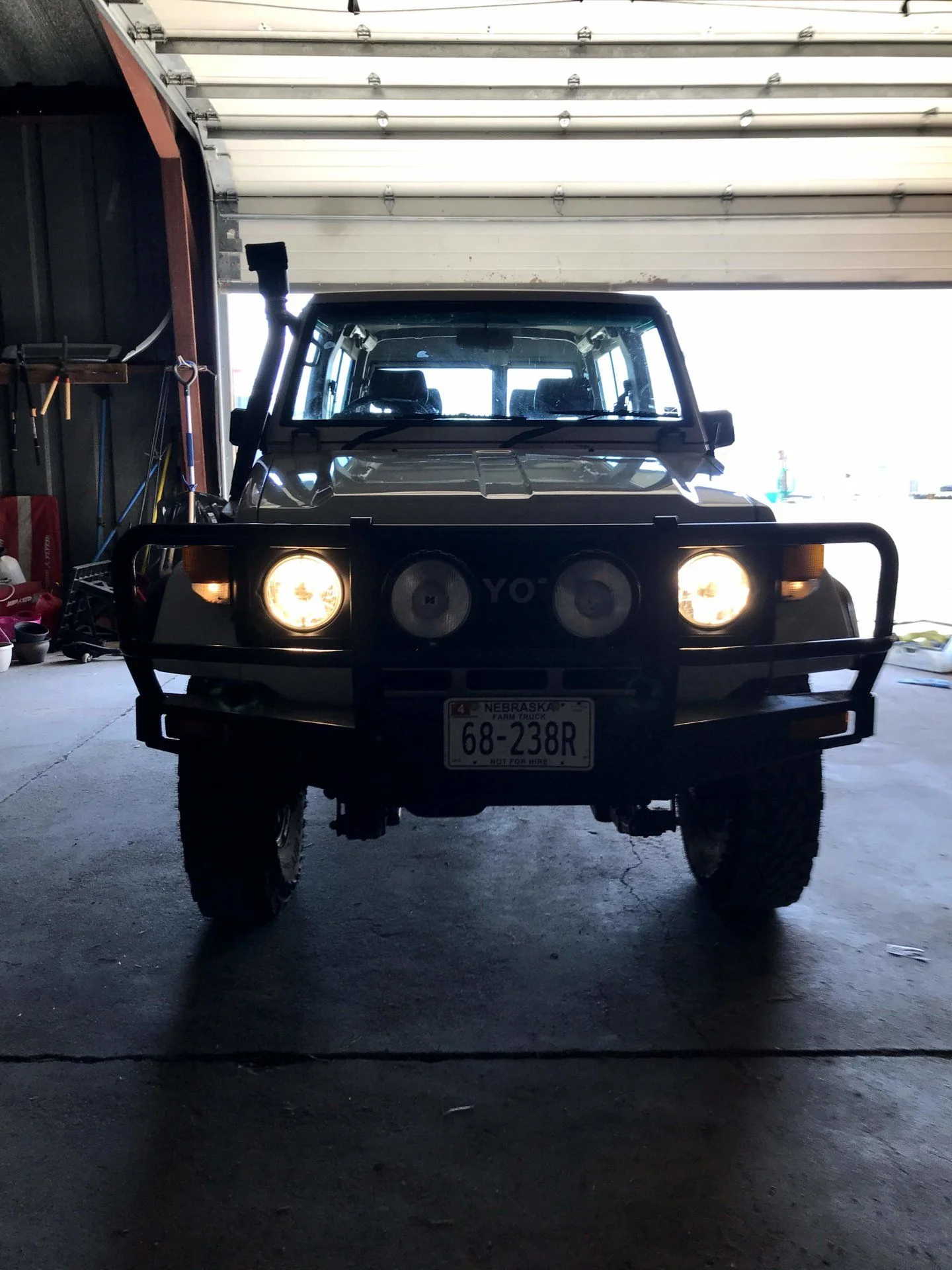

I need to aim them correctly and do the obligatory night shots so you can actually see them, but the difference is HUGE.
Low beams
High-beams
High Beams and AUX lights.
Overall one of the best/cheapest upgrades you can do. Ridiculous value in this kit, not too mention it's all OEM!
The only issue I have is that it doesn't register my "brights" on in the dash. I need to look up how to fix it, but it's because you don't plug in one side of the headlights the the resistance is difference not allowing that bright light indicator to come on.
