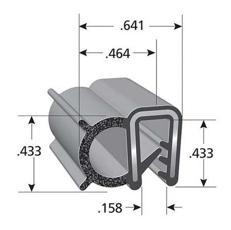

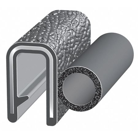

Trimlock:
It needs a way to seal and be weatherproof. It will probably only be on in the summer/fall but who knows.
This would go around the lexan. I'm not sure what style would be best:
or this
My gut feeling is the first one, called COEX, is more waterproof based on the inner nubs on the C-channel and 2 extrusions on the bulb. About $20ish more dollars, so not a big deal.
$62.00 for 25' for COEX, $35~$45 for the other for 25'
