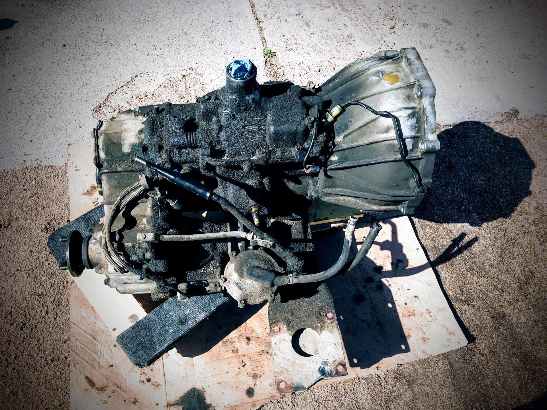

Transmission pulled, what a pain. It's leaking out of the input shaft. Cleaned the bell housing and tipped it slightly forward. Came back in an hour and gear oil was dripping out of the input shaft.
af5e5e23-e85b-43de-9599-0927fb499083-jpeg.1968578

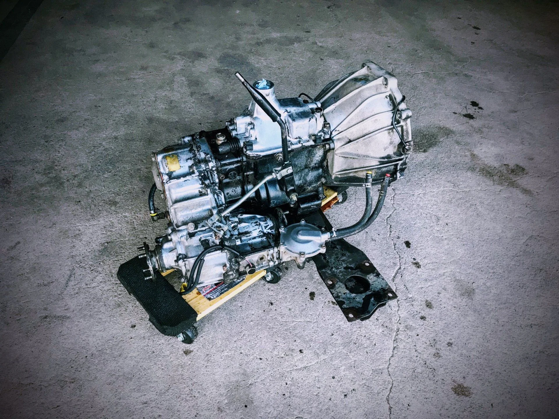

Cleaner
9b8a4c8d-3e0b-4822-bffb-b743d3c61e6f-jpeg.1968583
Hard to see the groove on the input shaft. Looking more and more like speedi-sleeve and stock seal as a bearing/seal shop in town couldn't find any double lip seal.
HOWEVER: I see that it requires 2 paper gaskets per parts diagrams. I only have 1 paper gasket on there. That might slightly move the seal off of the groove but I'm not sure if thats enough to stop the leak. I've also heard of people only using sealant on this spot.
thoughts?
