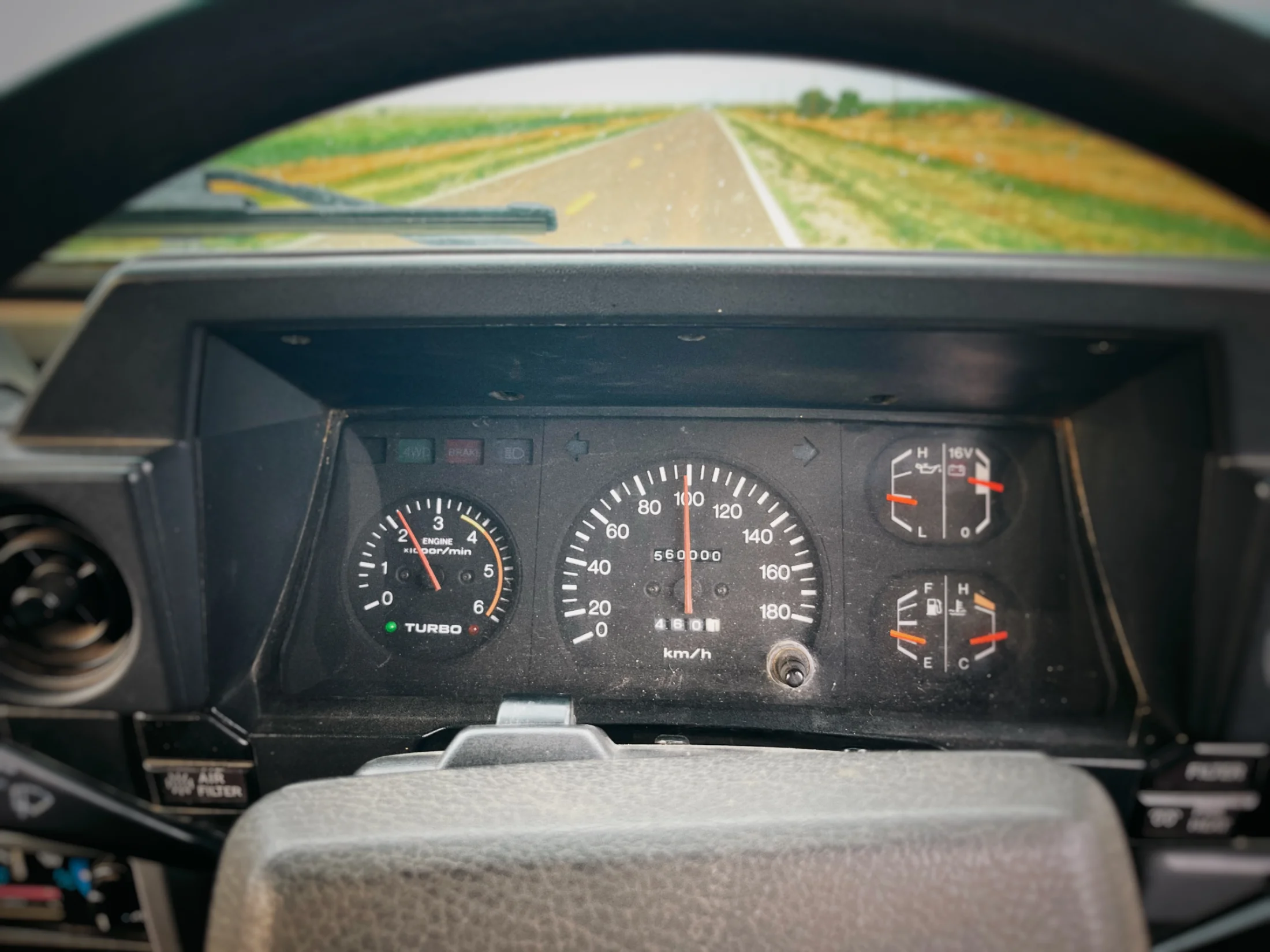

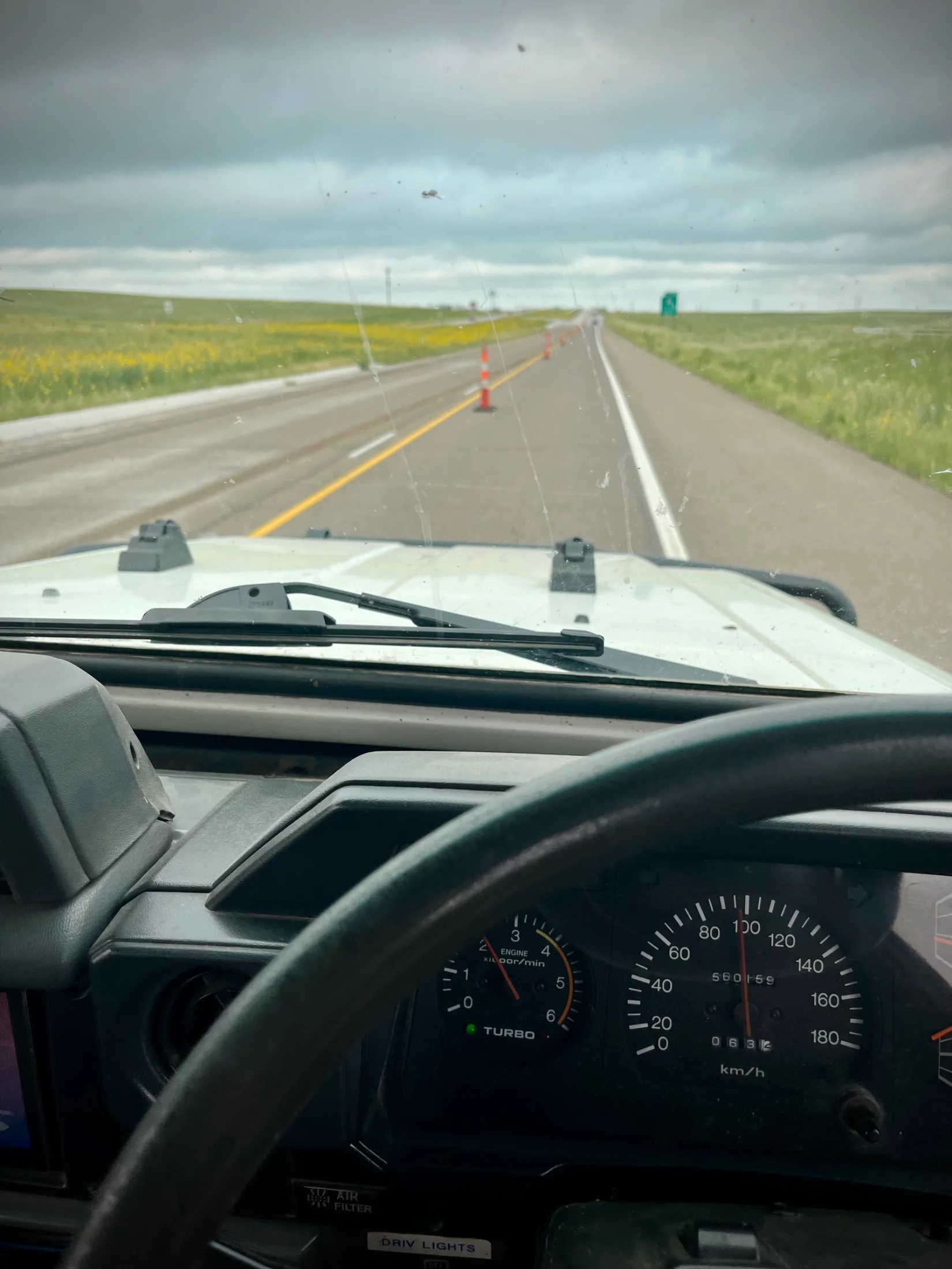

Took a small work trip, 1.5 hours down the interstate then backroads on the way home.
On the trip she rolled 560,000kms
As for the temps on the trips:
Interstate - 70mph, slight tailwind, 78F, 2400rpm
Water temp 187F
EGT - 800ish
Backroads - 65mph, headwind, 80F, 2300rpm
Water temp 185
EGT - 830F
So far it seems that it just sits at 185-188 at 65-70mph all the way into the 90s in temperature.

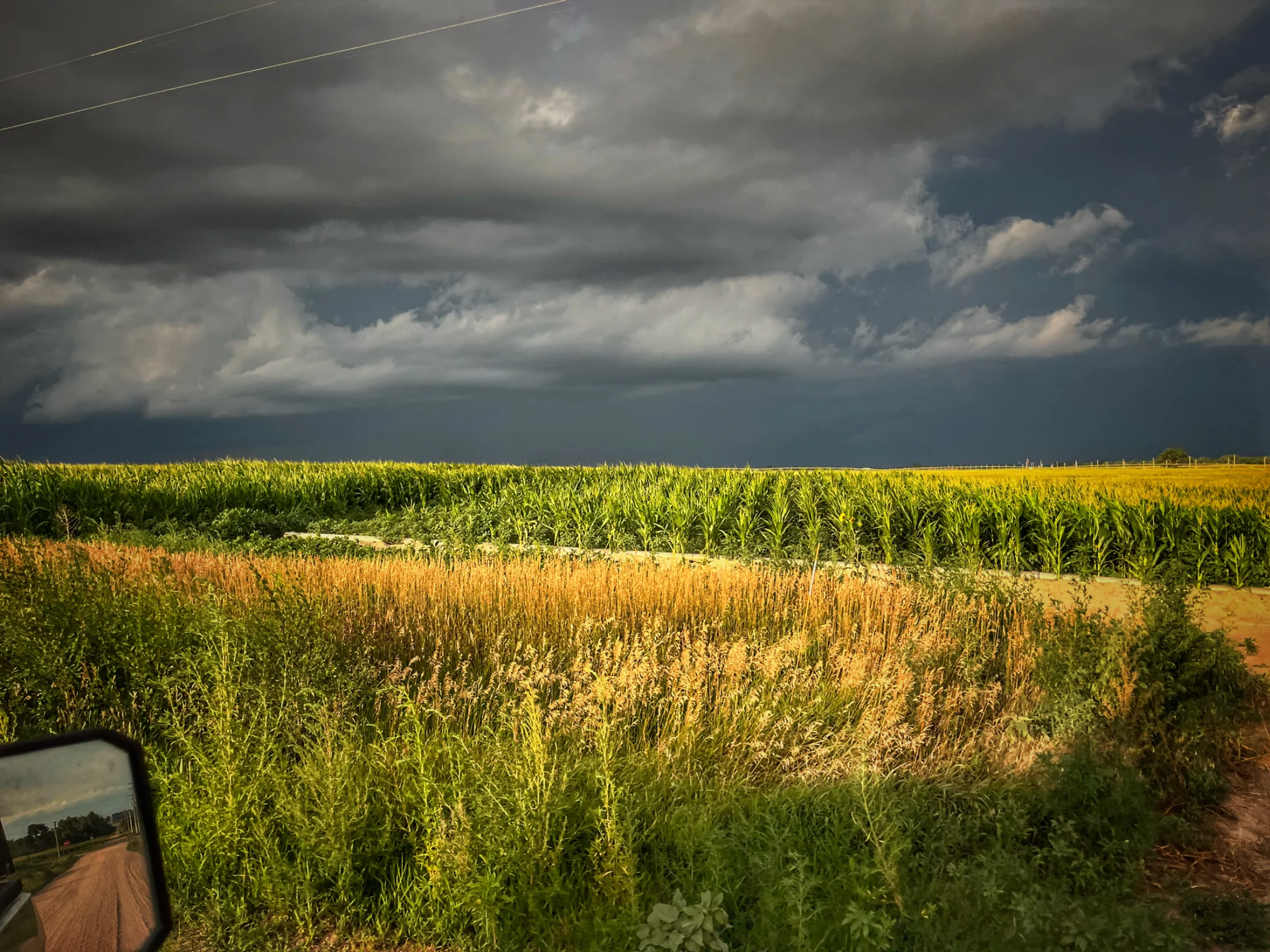

Big ol storm rolling in on the way home

Nice photos. I miss those western storms; they remind me of big squalls blowing up on the ocean and you never know which direction they are going.

Yeah we get some big ol storms that converge out here and just thunder and hammer like nobody’s business. I love a hit thunderstorm at night and we have had plenty this year.

Big ol storm rolling in on the way home View attachment 3960372
Interesting difference in growing seasons. A good percentage of our corn crop is either already in the bins or soon will be. 😊

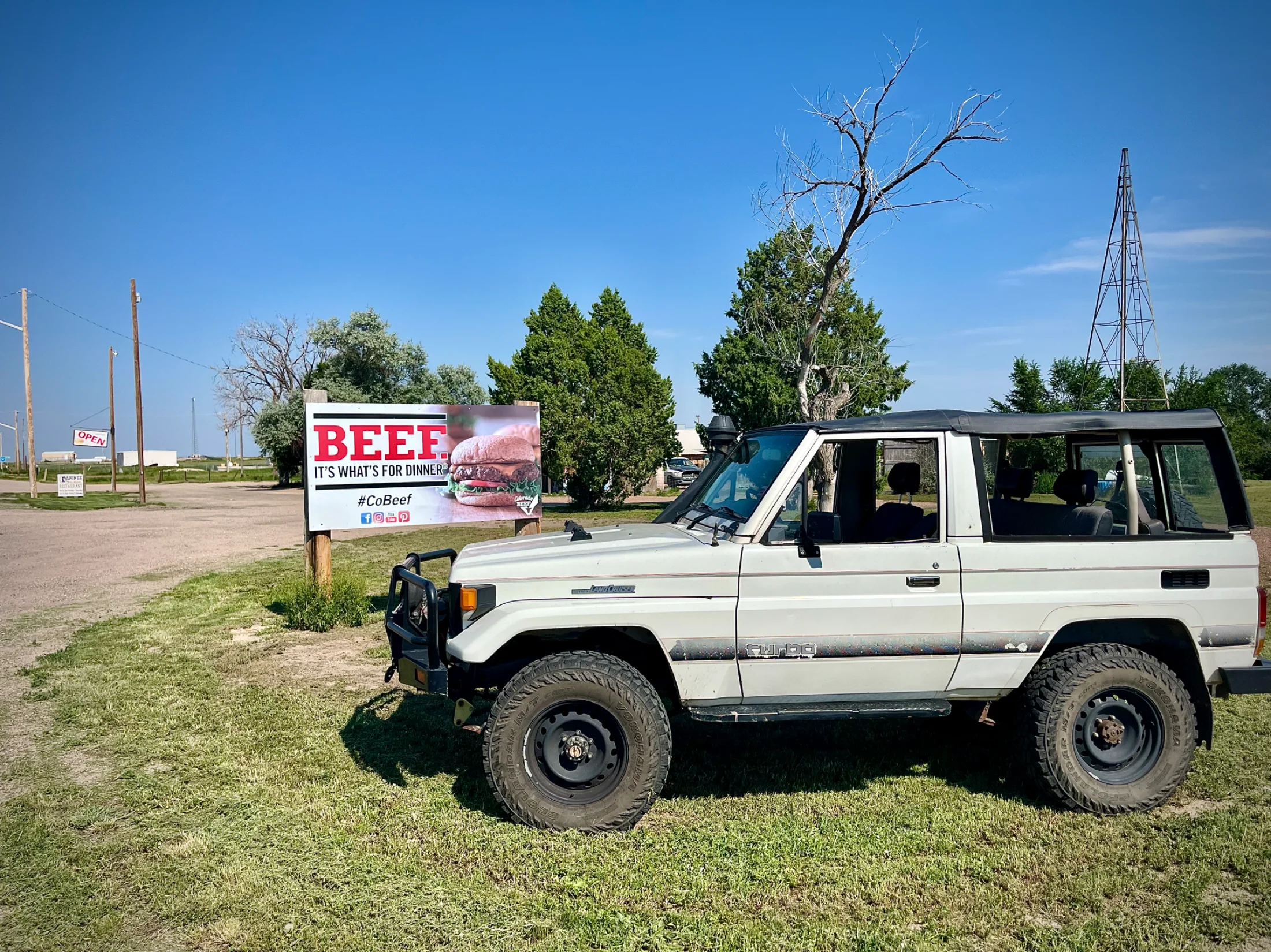

Oh Colorado and your Jeeps…. A quick stop at HTeaO…thankfully no ducks were placed on my cruiser.
Beef Country.

65mph, 97F, headwind and rolling hills. Most I saw was 196F for coolant.

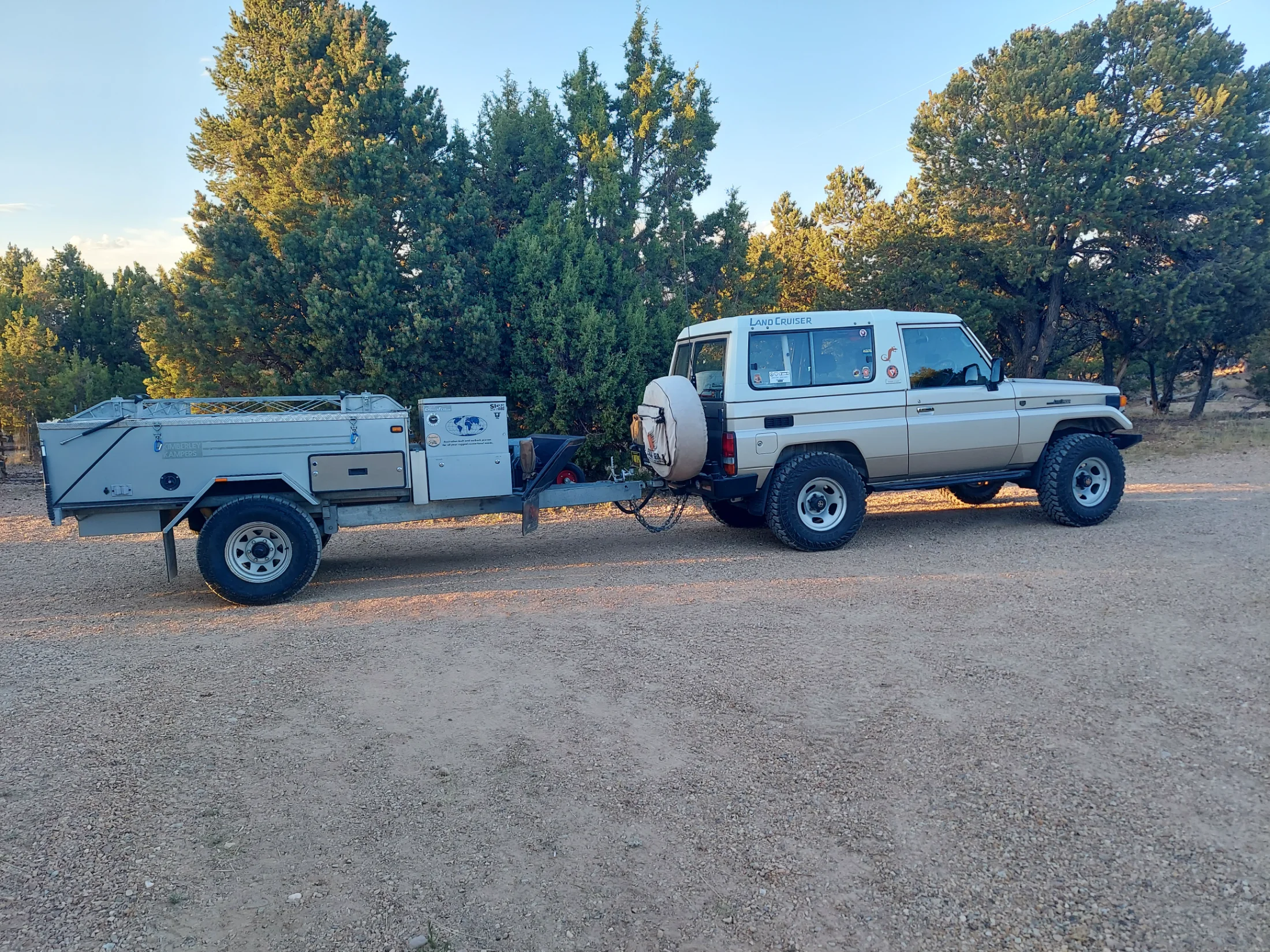

I just got back from the Solid Axle Summit in Ouray Colorado. I pulled this ~3,400 pound trailer through Utah and Colorado mountain passes for 640 round trip miles. I averaged 17.4 miles per gallon. Combined GVW for truck and trailer is ~9,000 pounds.
I climbed Davis Pass in low range 2nd and 3rd gear.
I climbed Davis Pass in low range 2nd and 3rd gear. View attachment 3967728
Awesome! I’m sure you could feel that trailer.
What was your highway speeds in it?
On flat ground and moderate inclines I could maintain posted speed limits. On steeper inclines I grabbed lower gears as my speed declined. In all but the steepest climbs I was able to crest in 3rd gear at around 45 miles per hour.
Sounds a lot like driving an unladen BJ70 :lol:

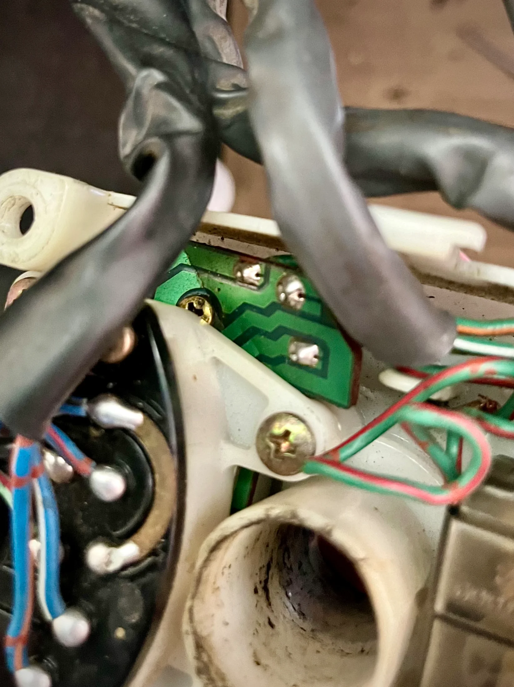

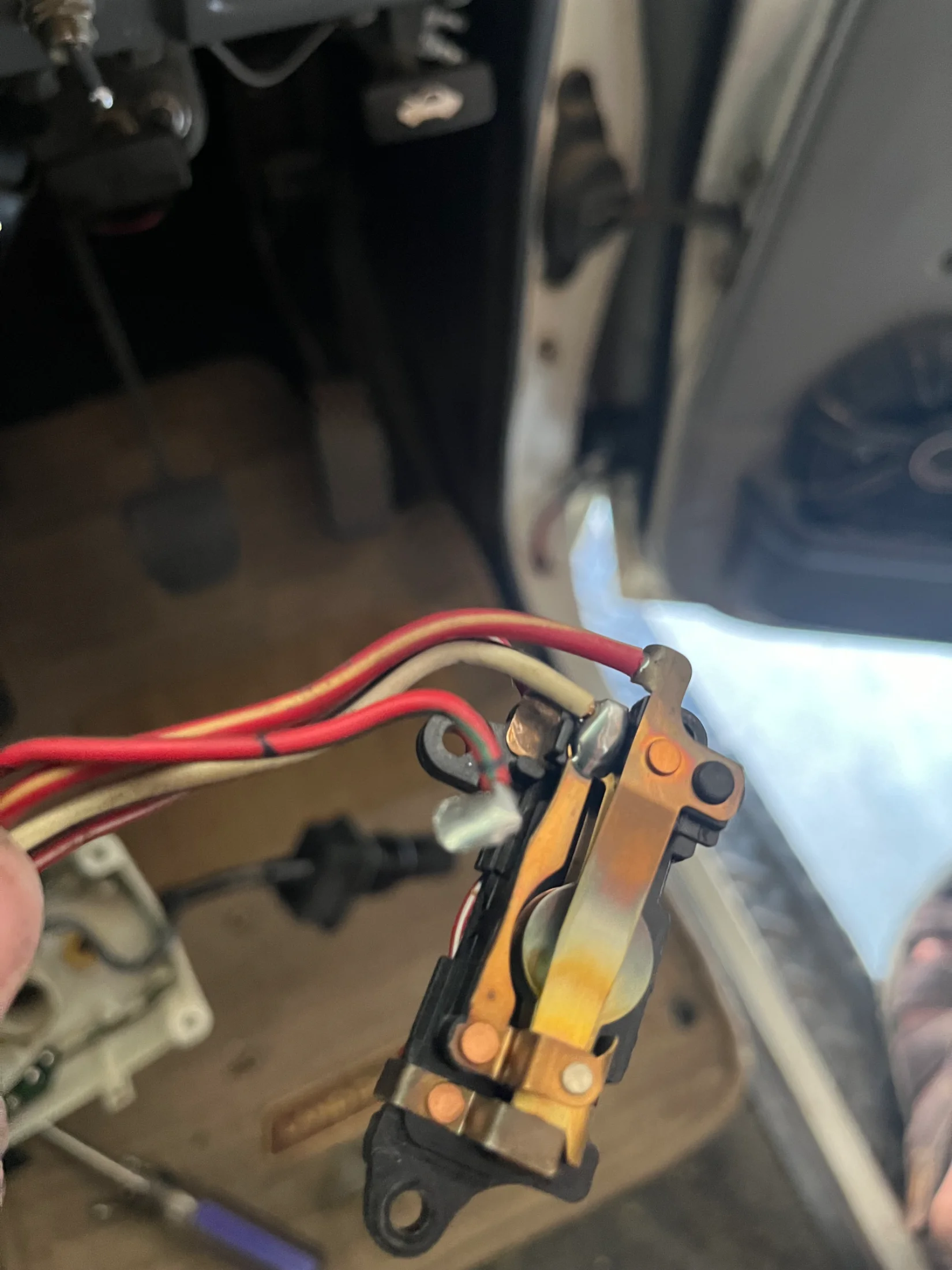

Oh the turn signals…
Opened up the steering column because it sure felt like a short. They would sometimes work, sometimes tilting column made them work.
Yep, that wire was disconnected. Soldered it on but no worky. I looked again and this board looks cracked.
So horn works, lights work, wipers work, no signals or hazards. The relay was working before fine, I suppose I need to pull and test, but I’m guessing the unit is just shot.
84310-60550 I believe is the part number…at $200 plus shipping 😳
Can you get the board out? What's on it?
Simple circuit boards like this can be recreated or even be repaired by removing the insulation laque, soldering in some bridges over the crack and insulated again.
Cheers Ralf
I believe I can get that out. Only problem is I suck at soldering. It might be worth a try I suppose.
