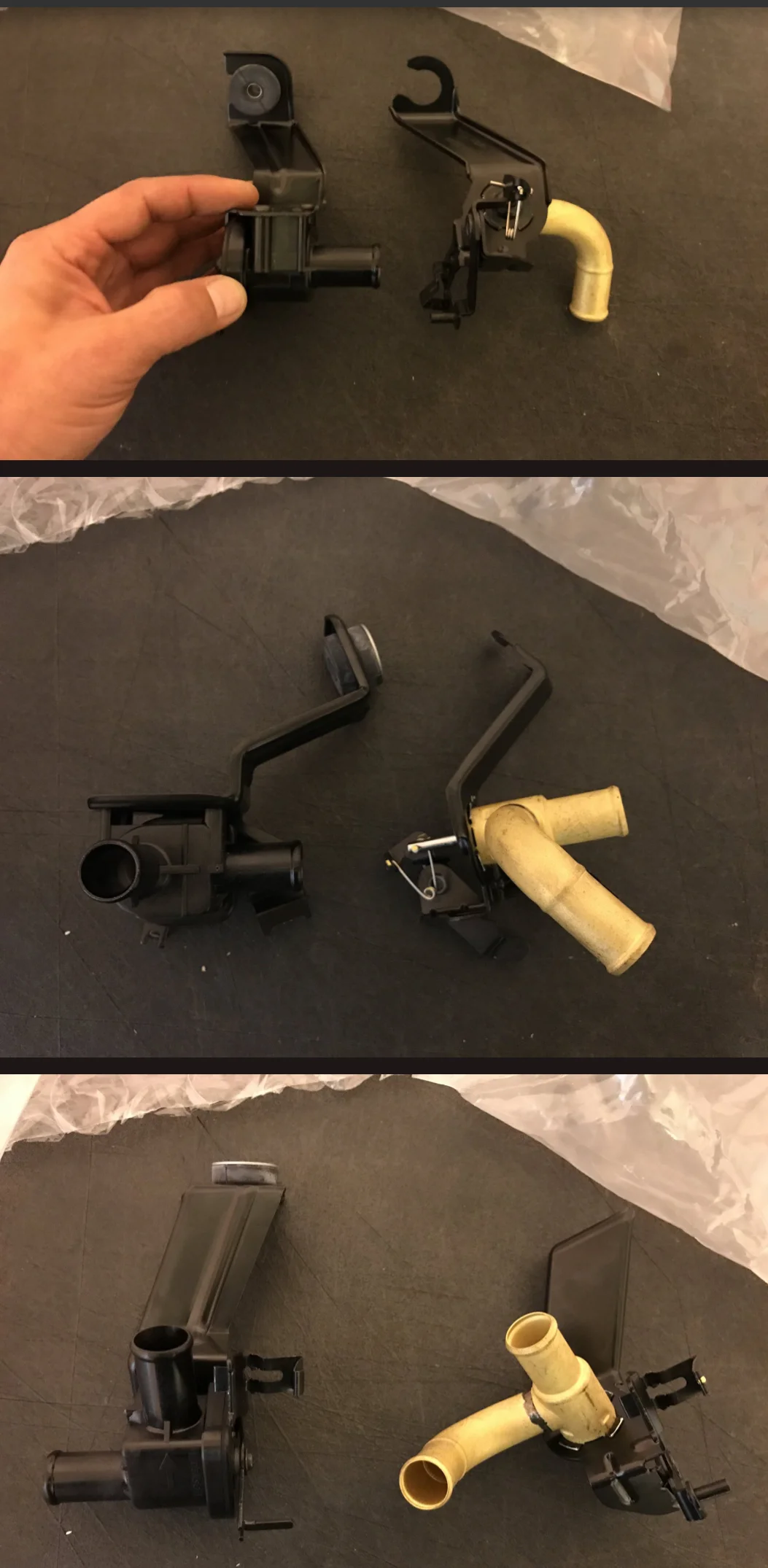

so my heater valve has been goofy for the last few weeks. So upon messing with it, appears that it’s stuck. I’ve unhooked the actual cable from controls and it only moves a little.
Always great to have the heater stuck on in 102F weather. The good news is I always have the top/sides off so it doesn’t really get hot. More worried about it leaking.
Partsouq shows 87240-90K01 which apparently is NLA.
However some searching found some posts of people using 87240-60110 which is slightly different.
Photos from @OGBeno
It should be the one on the right, but mine doesn’t have the extended pipe so maybe it’s an older or different version?
Other way it appears the newer version might work out alright. Are people using that one with success?

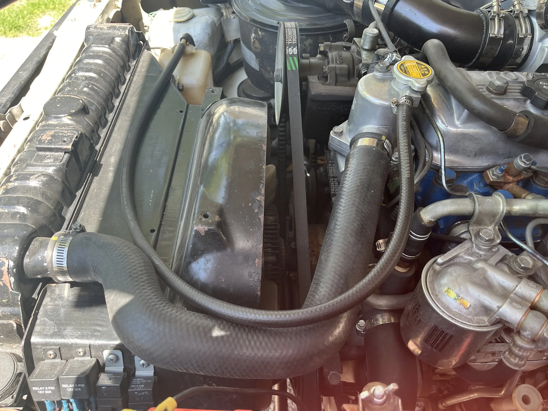

Still not overly happy about vague temps on the BJ74. Now I don’t have an overheating issue, but I would like to actually know what the engine is doing.

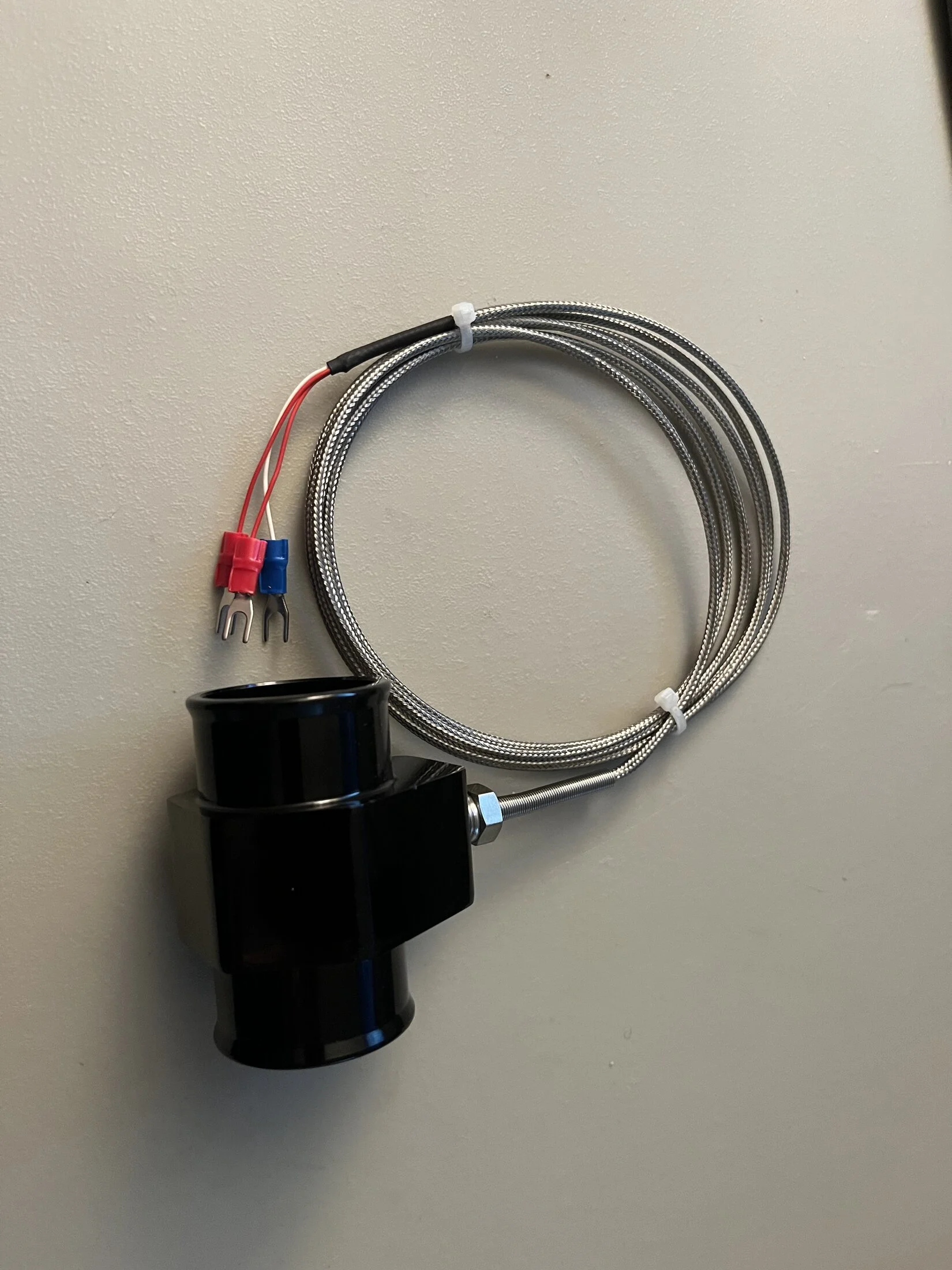

Not my favorite setup, but I got this to run in the radiator hose.
I’m thinking close as possible to the thermostat housing would read the hottest temps. Any thoughts on that?

On the rad hose temperature piece- I’ve used one for 3-4 years without any issues and it is nice to know what the temps actually are. Throw away the hose clamps that came with it and use good quality or OEM ones. Your location is a sound choice.

At least you have a nice straight section of hose to splice the adapter into.
Found that the temps (1HZ) are reading about 8-10* warmer for me now. I was running the sensor in the top hose (adapter like yours and Auber) vs now in the top tank of radiator (Terrain Tamer low coolant port and Auber).
Good information. I’ve seen a lot of people seem to recommend and use, but I’ve never heard the longtime report of them.
Those clamps do look pretty chintzy.
That’s interesting it would be 8-10 hotter. There is Probabaly a scientific explanation on why it would be warmer in the top radiator tank vs aluminum insert setup.
As long as it’s pretty close to accurate of the coolant temps, I’ll at least have some peace of mind.

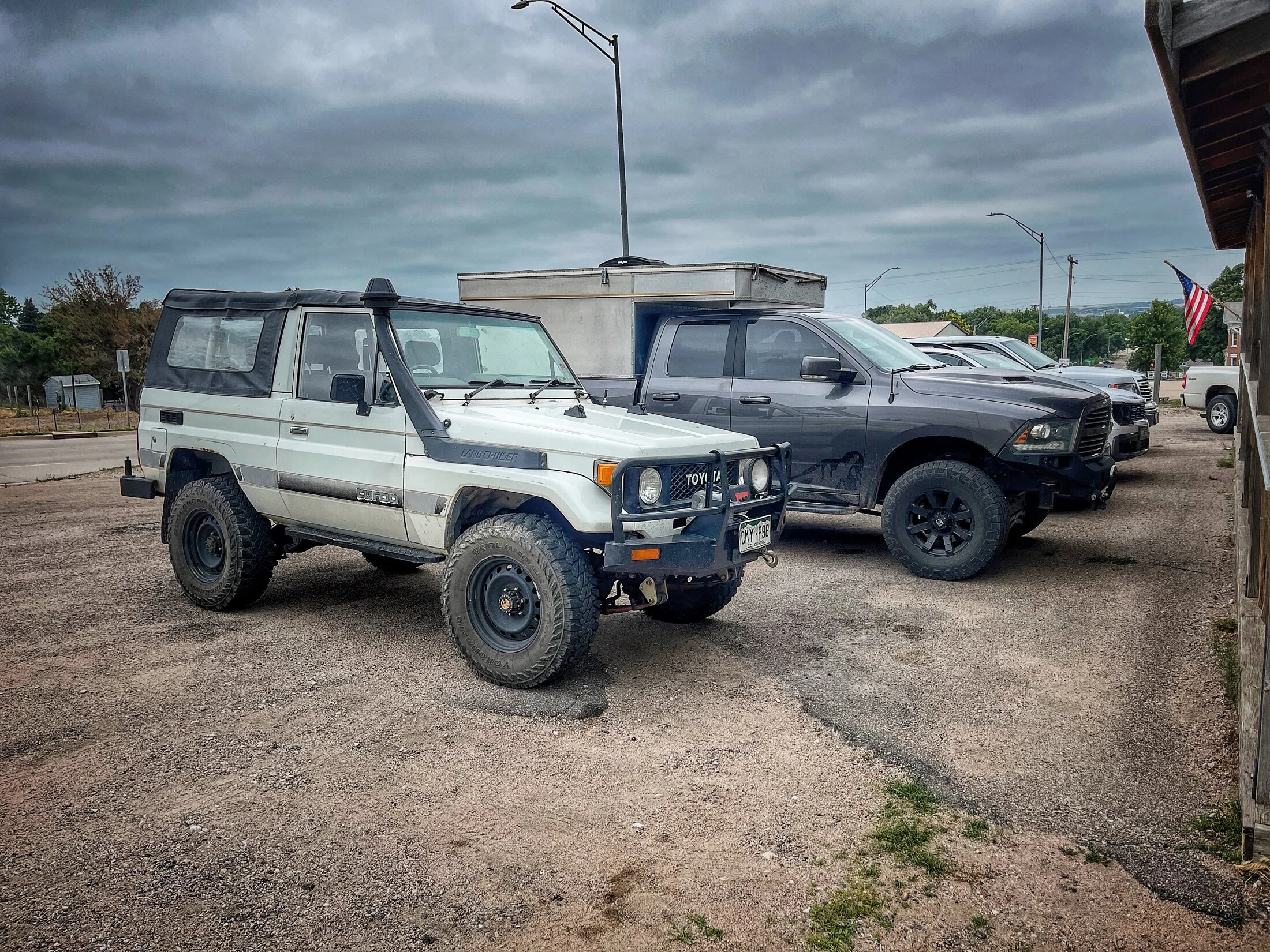

Lunch stop next to this rig:
It’s legit.
I will say curiosity got the best of me and I wanted to see the cost. They are all custom built per order and the cheapest plain version starts at $7,400….they pretty much just shells that pop up and have a pullout bed.
I bet they would make one for a 73/74 if one were so inclined.

Finally added in the temp sender in the radiator hose and went for a test. Only got about 45 drive in it so not a real big heat sink.
93F today, running down the interstate at 65mph.
2350rpms
EGT 769
12psi
188 degree water temp.
I still have the one on the thermostat bolt but it’s unhooked. I should be able to hook both up and see what the temp diff is in the coolant vs thermostat housing. I feel like it was about 8-10f off.

There’s a few ways to do that, this might be the easiest. Hook it up in the upper radiator hose with a sender and hook it up to my Auber gauge.
The good thing is I can actually run both temps at the same time to see what the difference is.
I hate cutting a radiator hose but a ton of people use these without issue.
