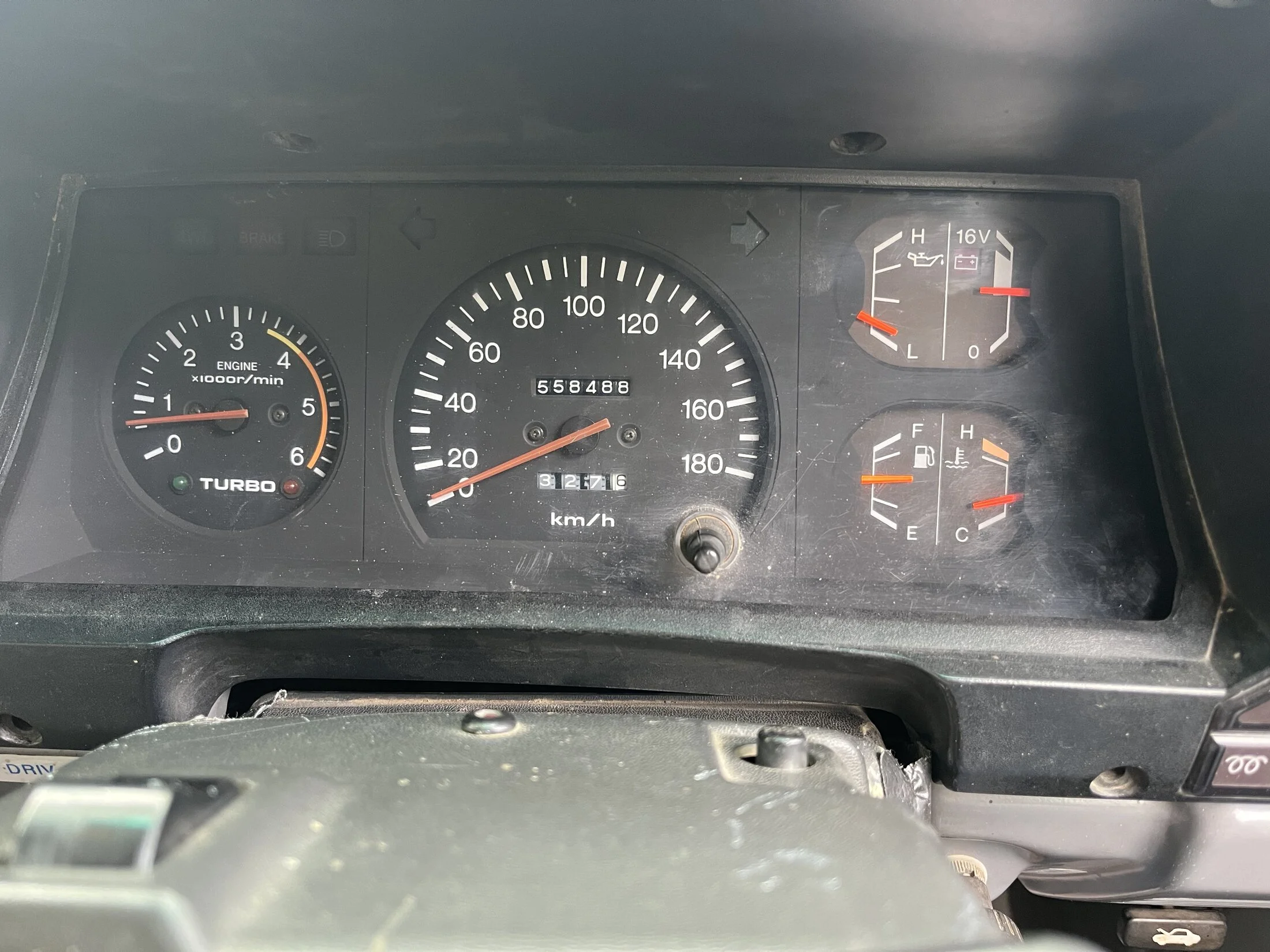

Did some testing.

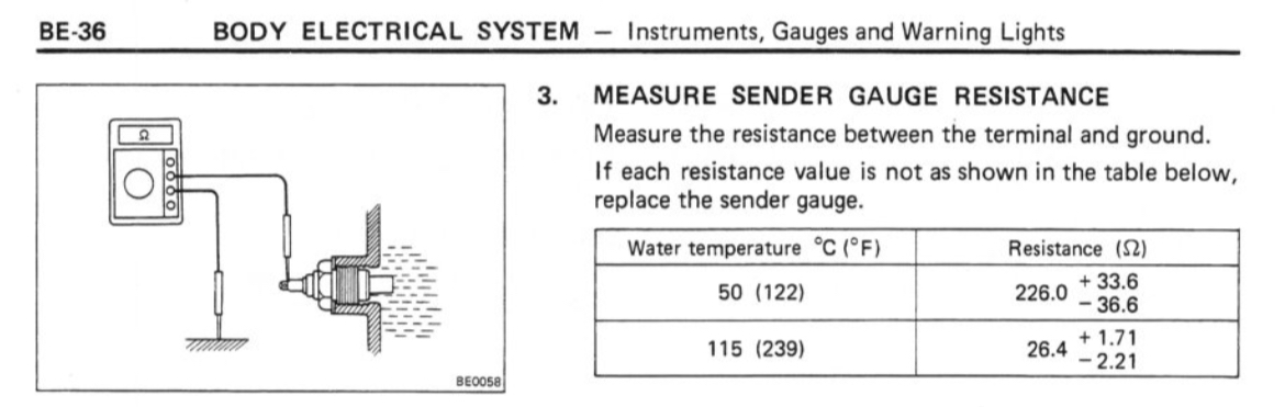

Warm engine, checking resistance on the sender according to the manual.
My cheapie multimeter showed 111ohms. Sender probably good.
The gauge was a little more vague.
I’m a bit tired but the first step is throwing me off on how to do this.

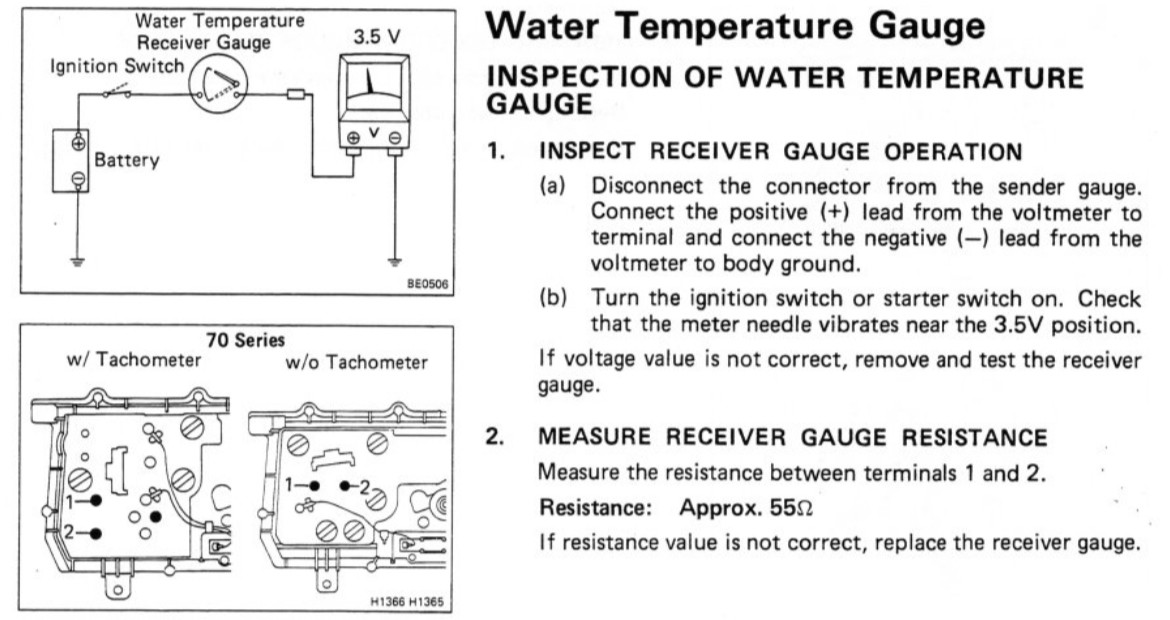

Measuring the gauge resistance, 18ohms which is definitely below the range. I’m not electronically smart enough to know if that would make the gauge work or not.
I’m not sure how to setup the the first test.
Also checked online for the gauge. Found a few part numbers but not sure on those. All of them showed up NLA on partsouq although that doesn’t mean that’s the case.
Not sure if the Bj74 is for a 24v or 12. The FJ73 I assume is 12v.

I think this 55ohms might be nonsense. I tested my 60's gauges, apparently the fuel, oil pressure and temperature gauges should all be 55ohms, yet they are all about 27. None show any signs of damage and I know the fuel gauge worked before I took it apart, can't remember the other two.
Could it be an erroneous spec for a 24V system? I'm not very experienced with electronics but I know that if a component flows the same current at 12V as it does at 24V, the resistance must be half, which is my 27 ohms. Not sure if there are different 24V oil pressure senders, coolant temp sensors and fuel level senders, but off the top of my head I would say no, as they are just passive resistances in a circuit.

If you run the test with the light bulb, the manual says that the bulb will flash after a few seconds.
So at this point the light is flashing and my gauge shows 27ohms. Looking like it’s just the sender.
That’s a great thought. I had wondered about the manual and 12v vs 24v, the but it wasn’t mentioned that I saw and I’m not smart enough with the electrical magic to know.

So I got the temp sensor in from cruiser outfitters but something kept nagging at me and I didn’t want to drop coolant to swap the sensor.
I ran through the tests again. I’m getting signal on the sender. Signal at connector in dash. Ohms across gauge. Doesn’t make sense.
I decide to pull the dash again. Triple check connectors. I decide to look at the gauge. Weird, the temp gauge looks like it’s touching the black background and none of the other gauges are?
So…when I put that little green turn signal light in, I must have somehow pushed the gauge needle into the background effectively wedging it into place. 😑. It wouldn’t spring back like the other gauges.
I took it all apart, gently pulled up on the pivot point of the needle and it popped right up. Then it would spring back if I lifted it up.

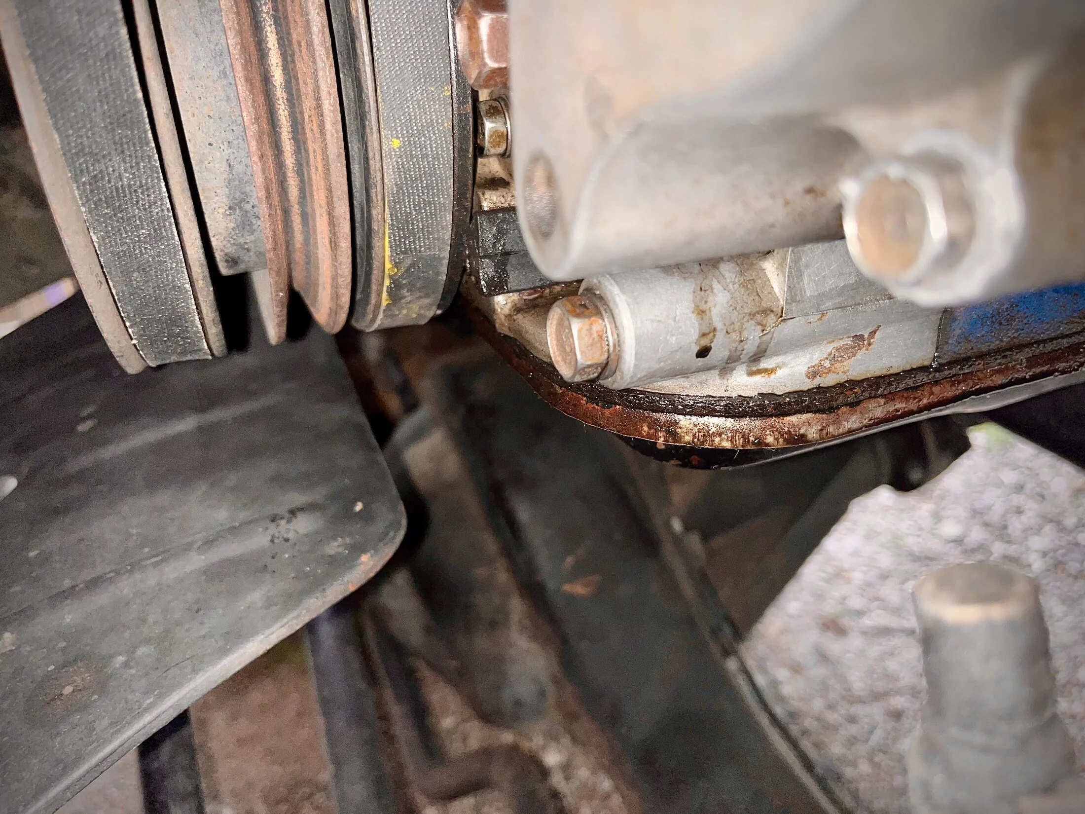

It appears the leak on the one side stopped but another has popped up. Should have used FIPG and gasket I suppose. I guess I’ll try the bandaid spray until I I can pull it all apart again. I’ve got 2 timing belts on 2UZs to do first.
