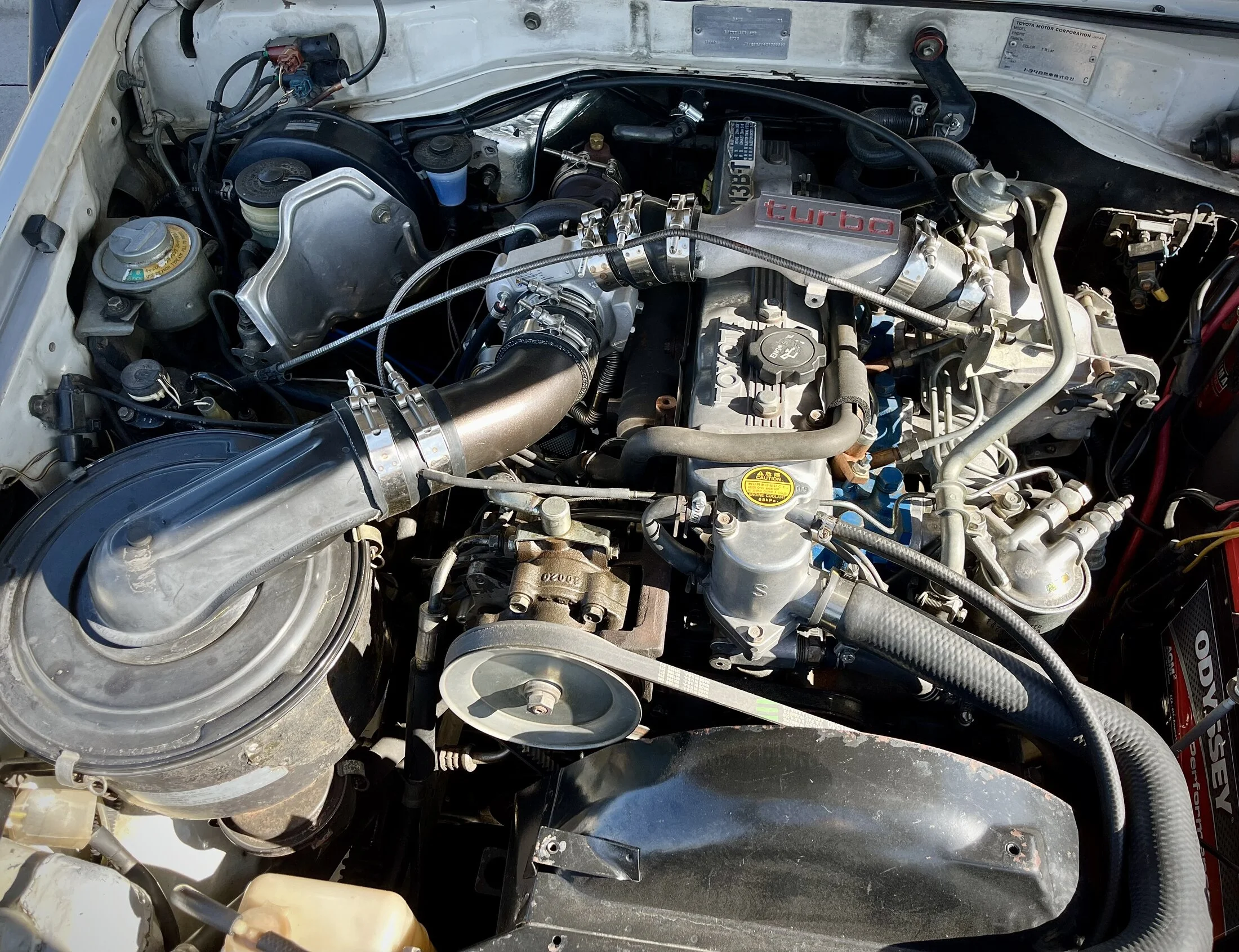

Here’s under the hood. Packed
This thought keeps bumping around in my
Head. Now it’s less protected for tough rock crawling and road debris, but I honestly don’t know how much of that rock crawling I’ll be doing in this 😂
Place it here, downwardish facing. Possibly that shield spaced down or some protection under there. I might not be able to find a decent size to fit there.
It’s possible you guys might react like this:
The time you need a intercooler most is at highway speeds, hot weather, and a loaded engine. If you can remember to wash the dirt and mud out of the IC after off road and before the hwy trip home it might work down there........I put a small radiator under my roof rack and ran 1/2" copper lines tucked along my snorkel, through the hood gap afforded by 1" spacers on top of my rear hood hinges. Unusual but it worked...........also tried pre turbo water injection from a window washer pump activated by egt gauge alarm relay, that worked quite well accept for the small tank.

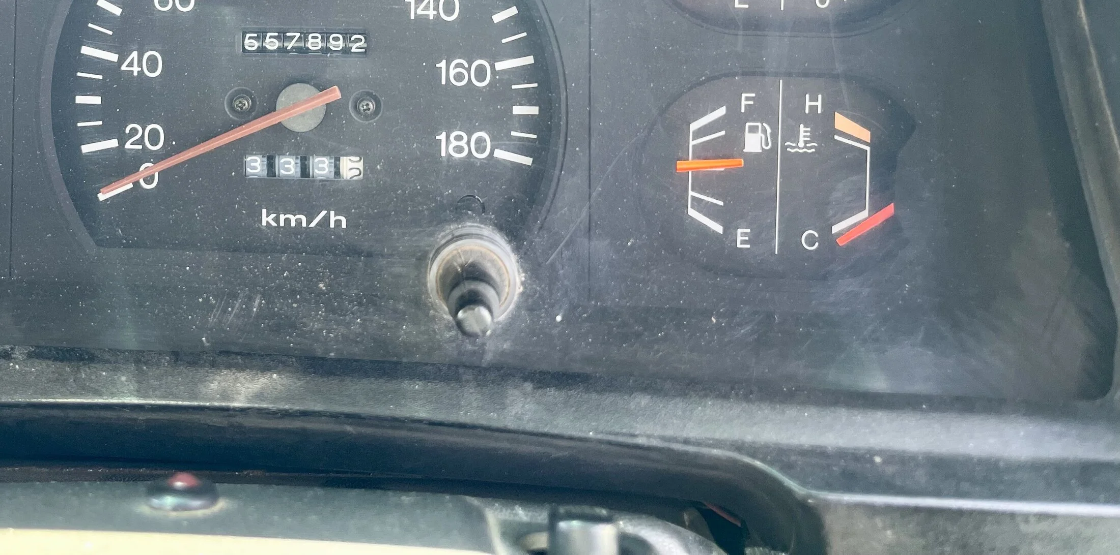

Water temp and oil pressure are the first gauges I replace on all Land Cruisers. 😁
Did some testing.
Warm engine, checking resistance on the sender according to the manual.
My cheapie multimeter showed 111ohms. Sender probably good.
The gauge was a little more vague.
I’m a bit tired but the first step is throwing me off on how to do this.
Measuring the gauge resistance, 18ohms which is definitely below the range. I’m not electronically smart enough to know if that would make the gauge work or not.
I’m not sure how to setup the the first test.
Also checked online for the gauge. Found a few part numbers but not sure on those. All of them showed up NLA on partsouq although that doesn’t mean that’s the case.
Not sure if the Bj74 is for a 24v or 12. The FJ73 I assume is 12v.
8324390K00 BJ74​
8324390K02 FJ73​
If your truck is Australian, it should be 12 volt.
JDMs were the 24 volt trucks
the manual is saying disconnect the sender. I assume it is just one wire, the +.
Connect your meter to that wire and ground the negative. Essentially, your voltmeter is taking the place of the sender.
You are testing to see if the gauge is sending the right voltage and, with ohms, making sure the gauge's resistance is right.
If the resistance is truly that far off the norm of 55, something bad might have happened to the sender.
You should call on @Engineer8000 for better info.
That makes sense I think. The sender appears to be in the right ohm range. The gauge is the one out of the norm.
Im not sure it’s available anymore.
I’m looking at a different all in one gauge again and get real coolant temp.
It appears when I put my multimeter positive into the sender wire, and ground the other, the volts jump from 0 - 8volts. Manual says hover around 3.5v. Seems close but again I don’t know with digital gauges and it’s jumping around.
sender is showing 170ohms warmed up which according to the chart means it’s bad. So I guess it’s off to find a sender.
If this is accurate I can get that from tons of places and rigs.

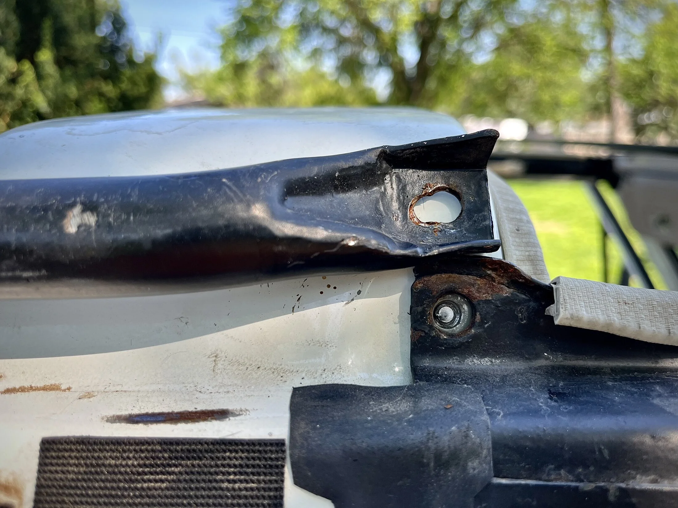

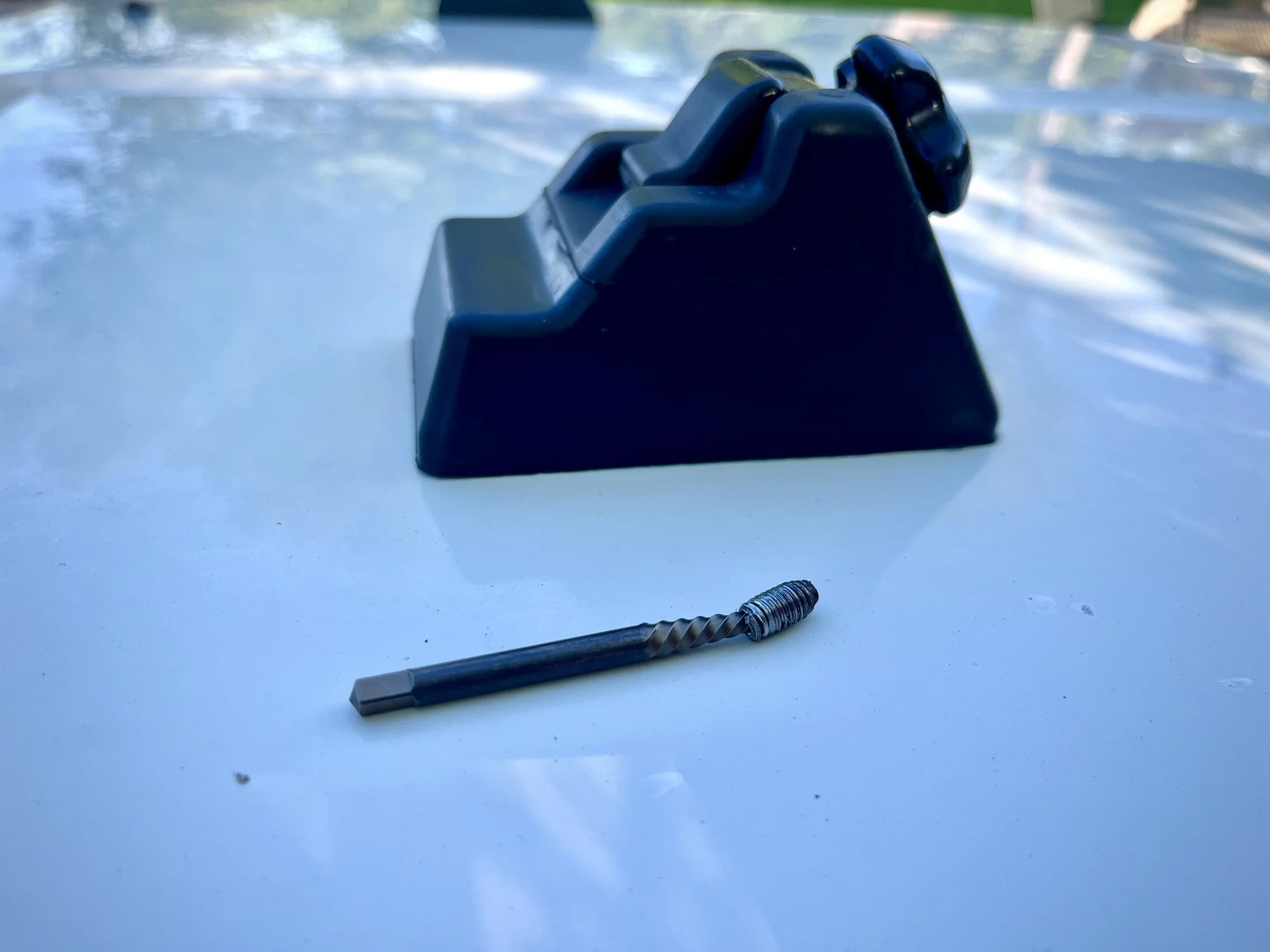

So I’ve had enough. Time to put the soft top on and enjoy summer. By far the latest I’ve put it on.
I need to get this put on fast!
This year I’m using power tools. Grab my Milwaukee power ratchet to blow through things like mudfluencer fashionista @wngrog does on all his builds. I can do this.
I’m tackling all these bolts like:
1 more bolt them I’m jumping railroad tracks.
Then SNAP!
No trunk wizard here so I’m off to the store for an EZ Out. I’ve never had good luck with those but It actually worked….
Lesson learned: Leave power tools to the fashionistas.
Success. Take a little test celebratory ride.
