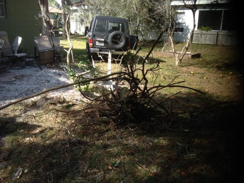

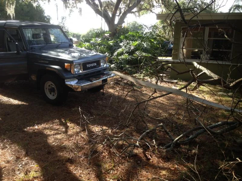

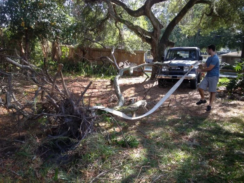

Finally put the Cruiser to work today. Friend of mine needed a dead orange tree pulled out. The goal was to use the pto on it to make sure it was working, but ran into a few problems. There was no tension on the line and had it properly engaged, although I kept thinking it wasn't....had my buddy get in and I looked underneath to see if the shaft was at least spinning. The sheer pin had shattered into a bunch of pieces before there was any tension...but it was spinning and engaged, so I know it works...just need a new/bigger pin.
We ended up pulling it out the old fashioned way and the cruiser did great. The root structure doesn't look big, but it took a lot of brute force and hard pulling both ways...lockers would have been nice.
I have the Cooper st maxx tires and the grip they have is very impressive. I was digging holes like nothing with them.

nice , good to see it getting a work out. Would love to see a video and hear that turbo !
You sure that is a tree?
Looks like a large bush to me. :D
we shot a bit of video but the muffler was on the other side, not sure if you can hear it spool..it's on my buddies camera...he is on shift tomorrow so may be able to send it to me so I can see/listen.
tree'ish :)
thanks a lot crzr45...I think I have that size laying around. Would that possibly work as a beefier permanent fix?
According to Wayne you can drill out the sheer pin hole to accommodate a larger pin and that will increase the capacity of your PTO winch.
I will have to "Google" treeish. : )
There is very little material in the yoke where the hole is drilled. It would need to be reinforced in some manner. I remember seeing something where a Nissan yoke was used for this modification.

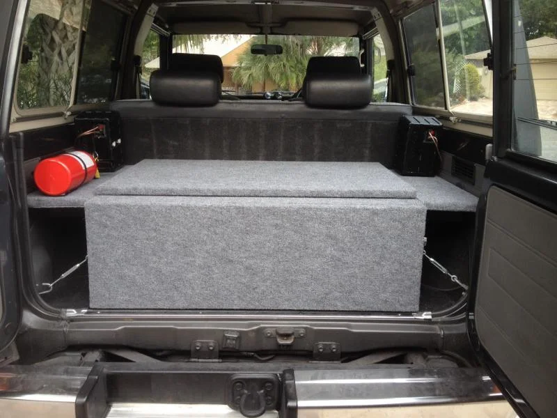

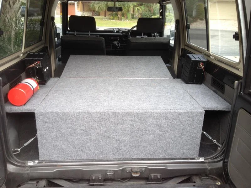

Where did you get the carpet material to cover it? Still need to find a good option to cover my box in my 80.
