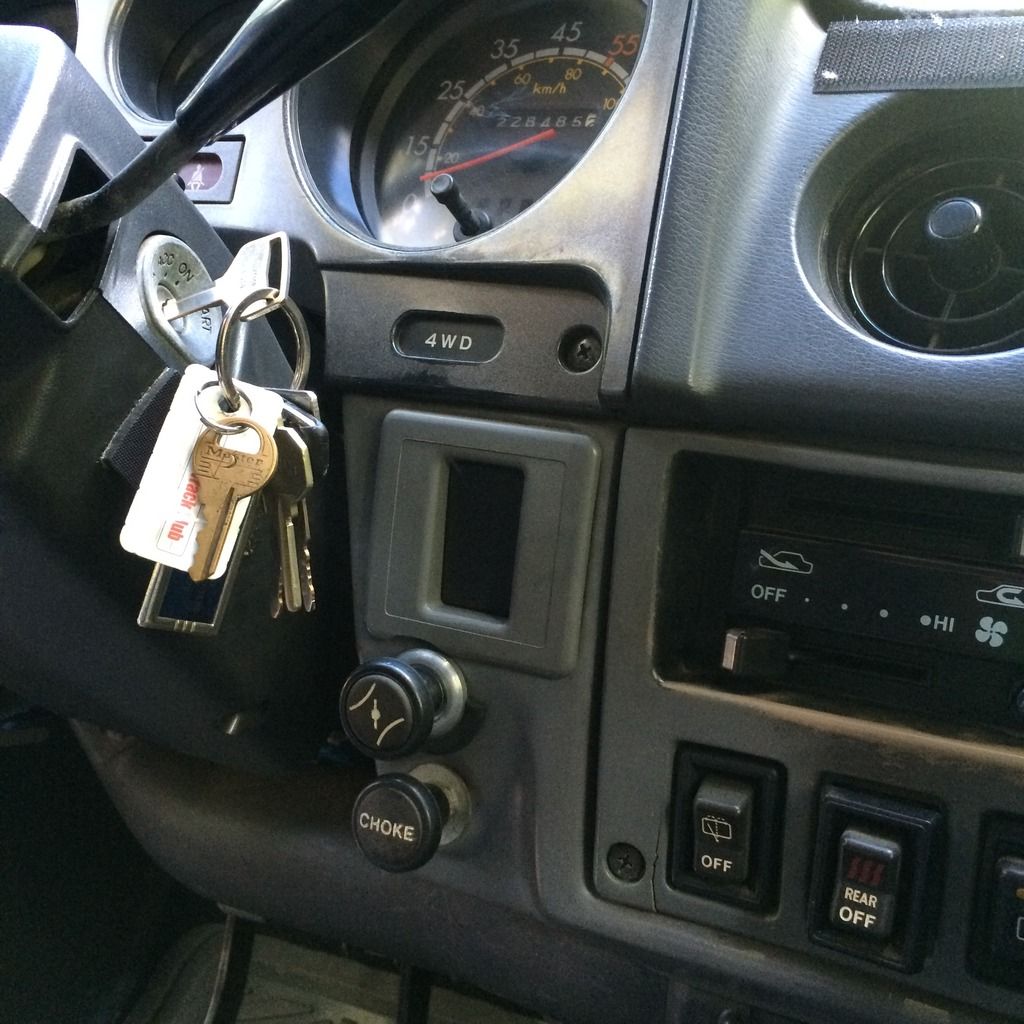

When I park it, I just pull it out a click to kill the engine, then leave it out. That way, anyone who breaks in, tries to start the truck, or tries to pop the clutch, will be met with a fuel shutoff. If they try to give it the choke..... they only "choke" the engine out!!!
Anyway. Pretty slick setup in my opinion. I love it. Huge thanks to my friend Chris who worked with me until 12:00 at night in the dark, outside, on the curb. What a guy. Thanks Chris!!!
Doing the exact same thing on two diesels I have. The little very crude motor that runs the shut off on the IP are always toast (Nissan motor not Toyota) and are expensive to replace. Why spend $500 on something that will eventually fail when it can be done for super cheap!?

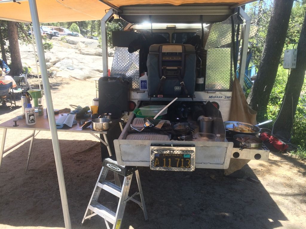

Went to Rubithon. Got to ride with Gary (Mudrak), in his 45. It was awesome. Here are a couple pictures of camp. and the rigs.

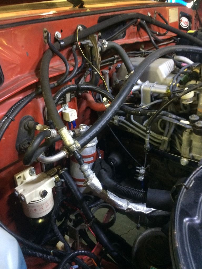

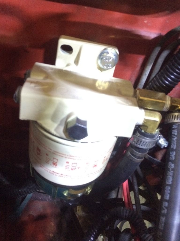

I also installed a Racor fuel-water separator. Its the Racor 120A model

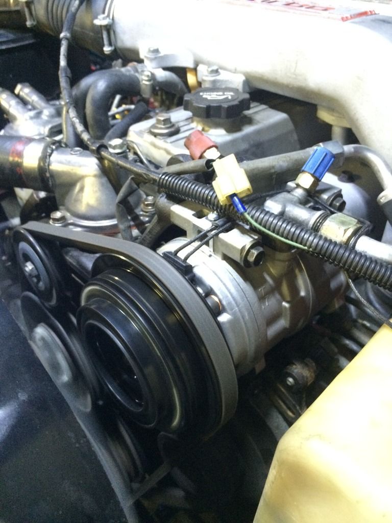

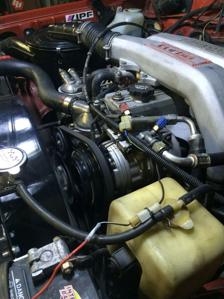

I also put in a new AC compressor. Somehow the compressor is identical to some new 4runner compressor? It was incredibly convenient. The AC is blowing cold again and holds pressure.

Installed a hand throttle. It automatically locks when pulled, and retracts when twisted counter clockwise. Very slick setup in my opinion. I just find a throttle position I like with my foot, then set the hand throttle and cruise.
I mounted it just above my kill "choke" knob. I might re-locate it, but the cable is so short that options are VERY limited.

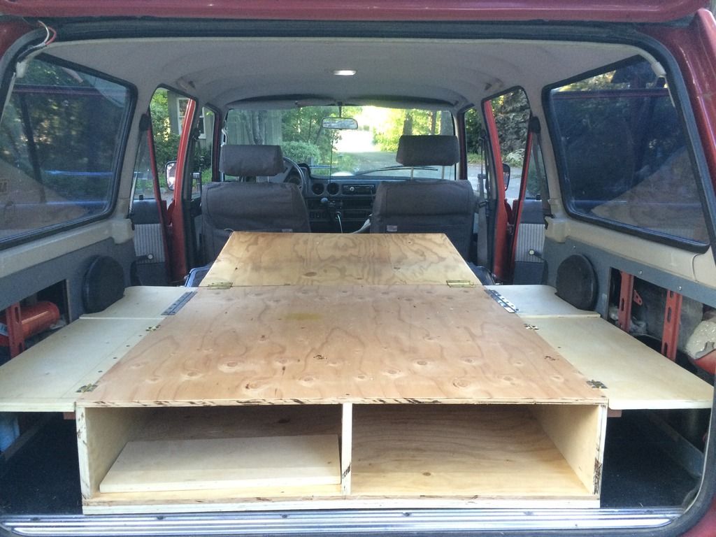

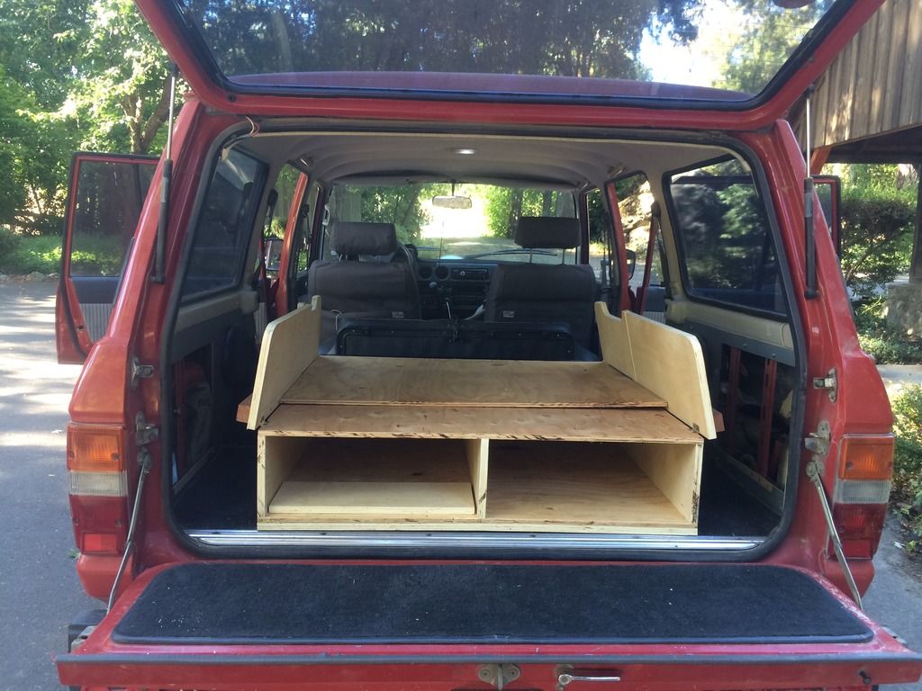

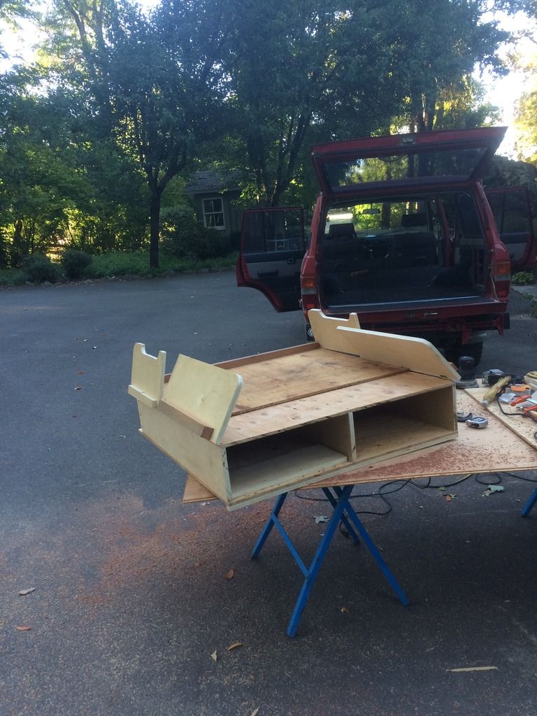

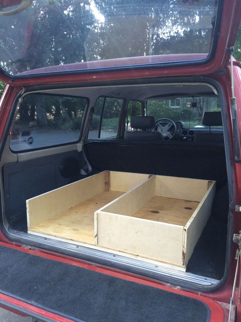

The more exciting update: DRAWERS

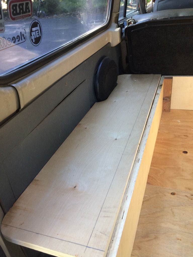

So I built the system so that It can stay in the car with the seats up, or take advantage of the extra space when the seats go down.
I also made it easily removable. I havent made the actual drawers yet because the slides dont come until the 15th.

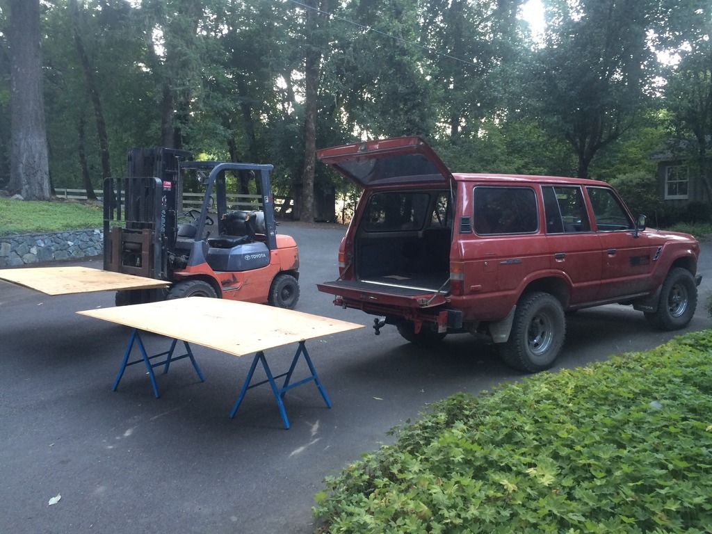

most of the system is made from 3/4in indoor plywood, and the top and bottom pieces are 1/2 inch. Its unbelievably sturdy. Its all held together with two inch screws, and 1.5x1.5inch redwood reinforcements.
Here you can see the system fully folded up for removal.
And here it is fully removed for storage etc.

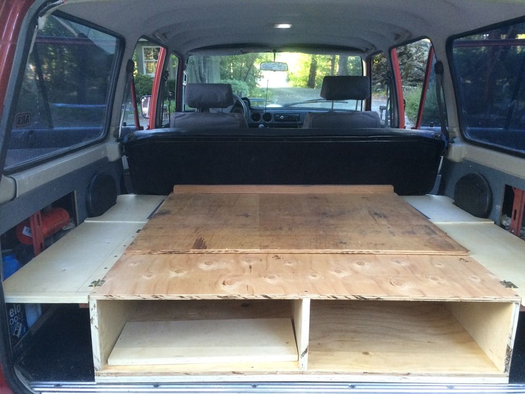

Here it is in "daily use" (seats up) mode, with sleeping deck folded up.
Finally, here it is in its full extension mode.

What is the part number on your compressor? I got a reman one and it works but is noisy..
