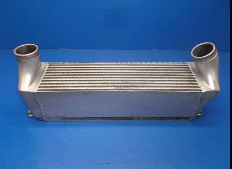

The Intercooler is from a Porshe 944.

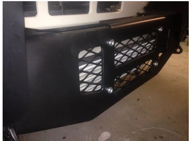

The Intercooler mounted in the ARB Brushbar. It sets back approximately 1" from the opening which will allow it to be cleaned if necessary. There will be a skid plate under the Intercooler (not completed at the time of the photo) and a removable "tight mesh" screen cover to keep debris out of the Intercooler when playing in the bushes.*

View attachment 1037052 The Intercooler mounted in the ARB Brushbar. It sets back approximately 1" from the opening which will allow it to be cleaned if necessary. There will be a skid plate under the Intercooler (not completed at the time of the photo) and a removable "tight mesh" screen cover to keep debris out of the Intercooler when off-roading.
Nicely executed!

View attachment 1037052 The Intercooler mounted in the ARB Brushbar. It sets back approximately 1" from the opening which will allow it to be cleaned if necessary. There will be a skid plate under the Intercooler (not completed at the time of the photo) and a removable "tight mesh" screen cover to keep debris out of the Intercooler when playing in the bushes.*

View attachment 1037052 There will be a skid plate under the Intercooler (not completed at the time of the photo) and a removable "tight mesh" screen cover to keep debris out of the Intercooler when playing in the bushes.*
