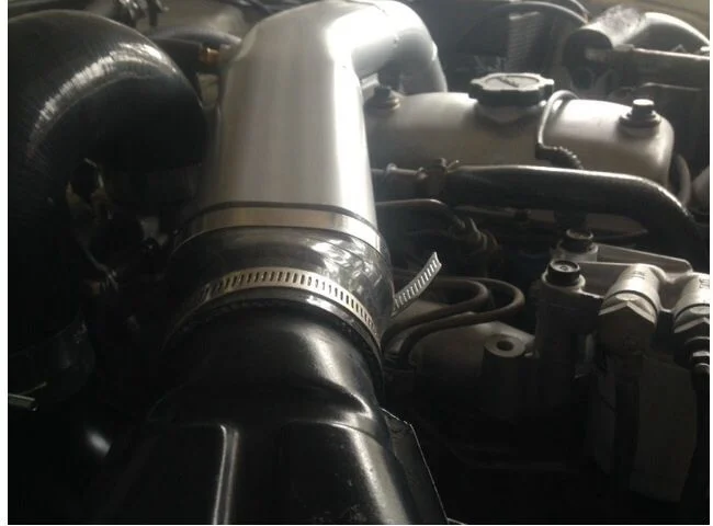

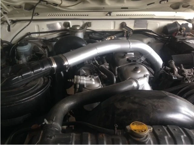

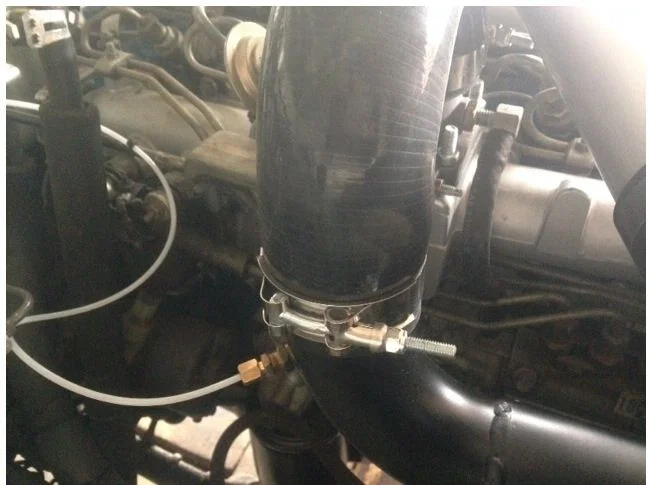

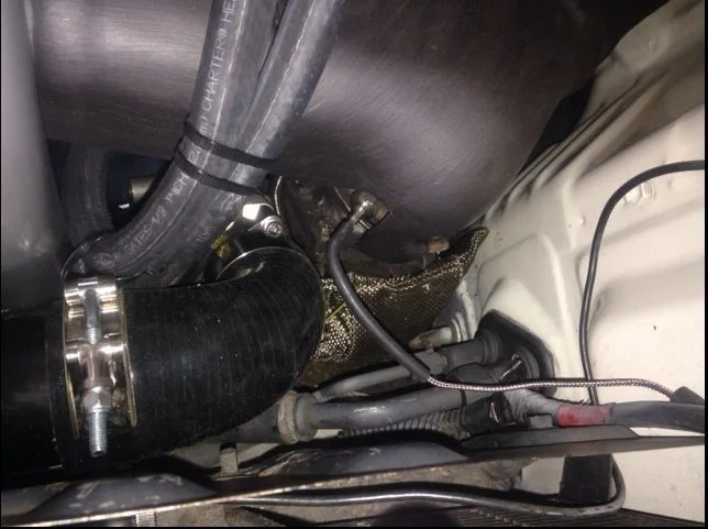

A few more photos with my crappy IPhone. Unfortunately the turbo is almost completely hid from the topside. ( the heat blanket is somewhat visible)
I will need to slide under the truck to get a better photo of the turbo.
The crossover pipe minus the Garrett decal.

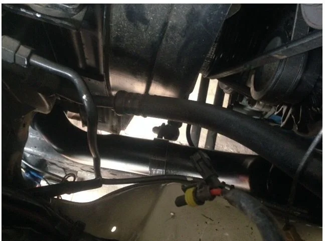

Headed to the Intercooler. (A very tight fit under the radiator)

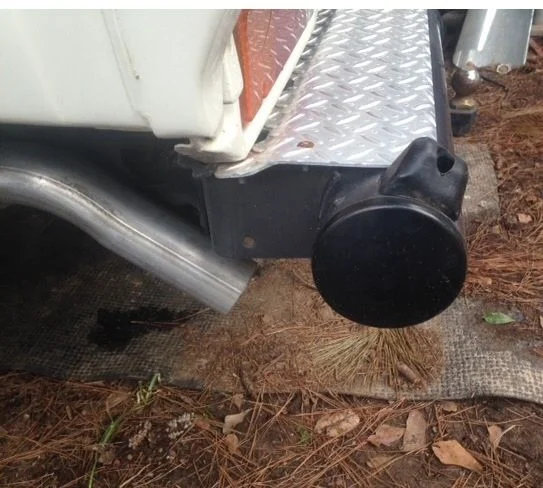

New 2-1/2" exhaust. A tad long so approximately 2"-3" will be cut off and angled.

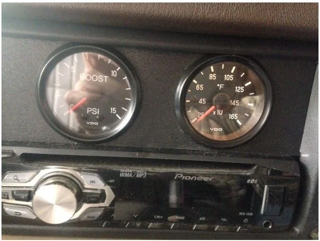

Moved the radio down to make room for the pyrometer and boost gauge.
