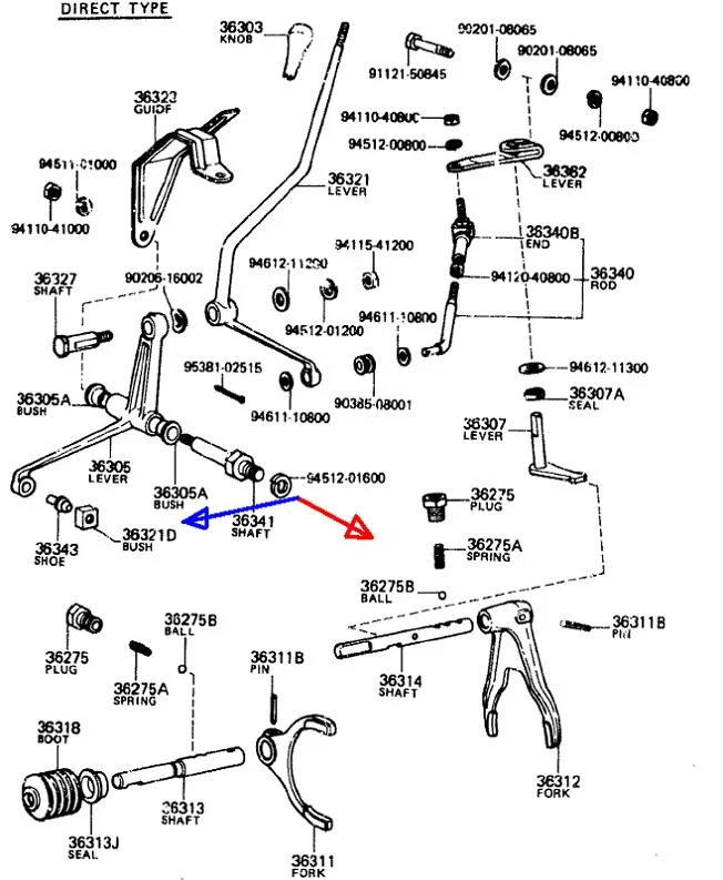

Engine being in place I’m now working on reconnecting everything, starting with the transfer case/ everything underneath the truck. Transfer case linkage was rebuilt using OEM components. Diagram stolen from elsewhere on here.
Engine being in place I’m now working on reconnecting everything, starting with the transfer case/ everything underneath the truck. Transfer case linkage was rebuilt using OEM components. Diagram stolen from elsewhere on here.View attachment 3357837
Good on you.
I abandoned all of that linkage. It all seized - and went with the factory twin stick.

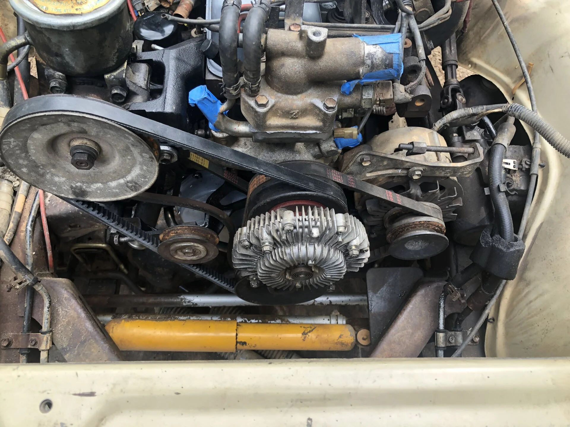

With the smog pump gone a lot of room is freed up above the alternator, and it removed a failure point.

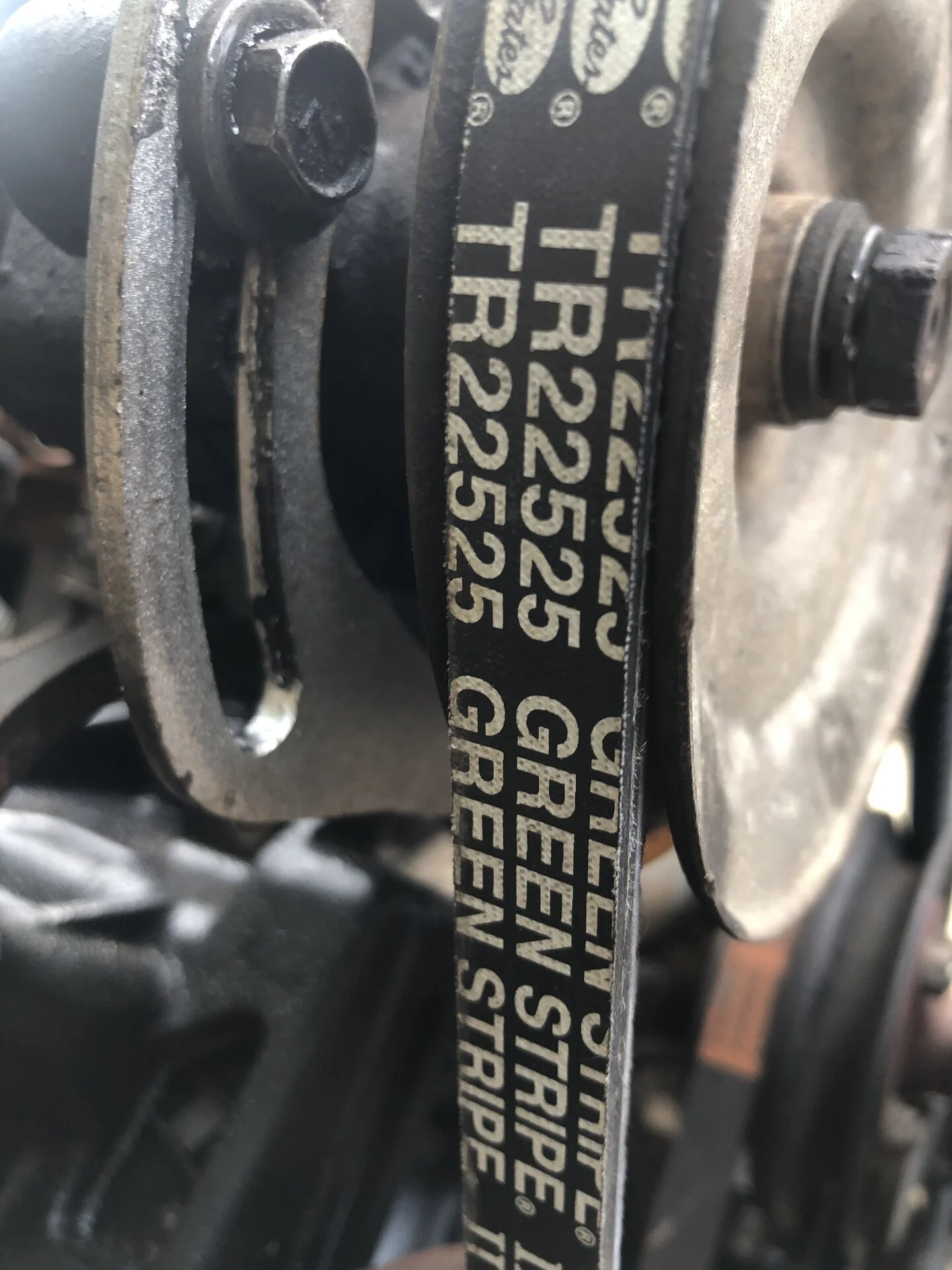

I used a Gates Green Stripe TR22525 as the desmog belt, a Dayco 22528 also works according to the desmog threads.
I believe an OE PS belt from a non-US 3F would work as well but I have not been able to find a PN for it that’s available from US Toyota dealers, only through Partsouq and Amayama I believe.

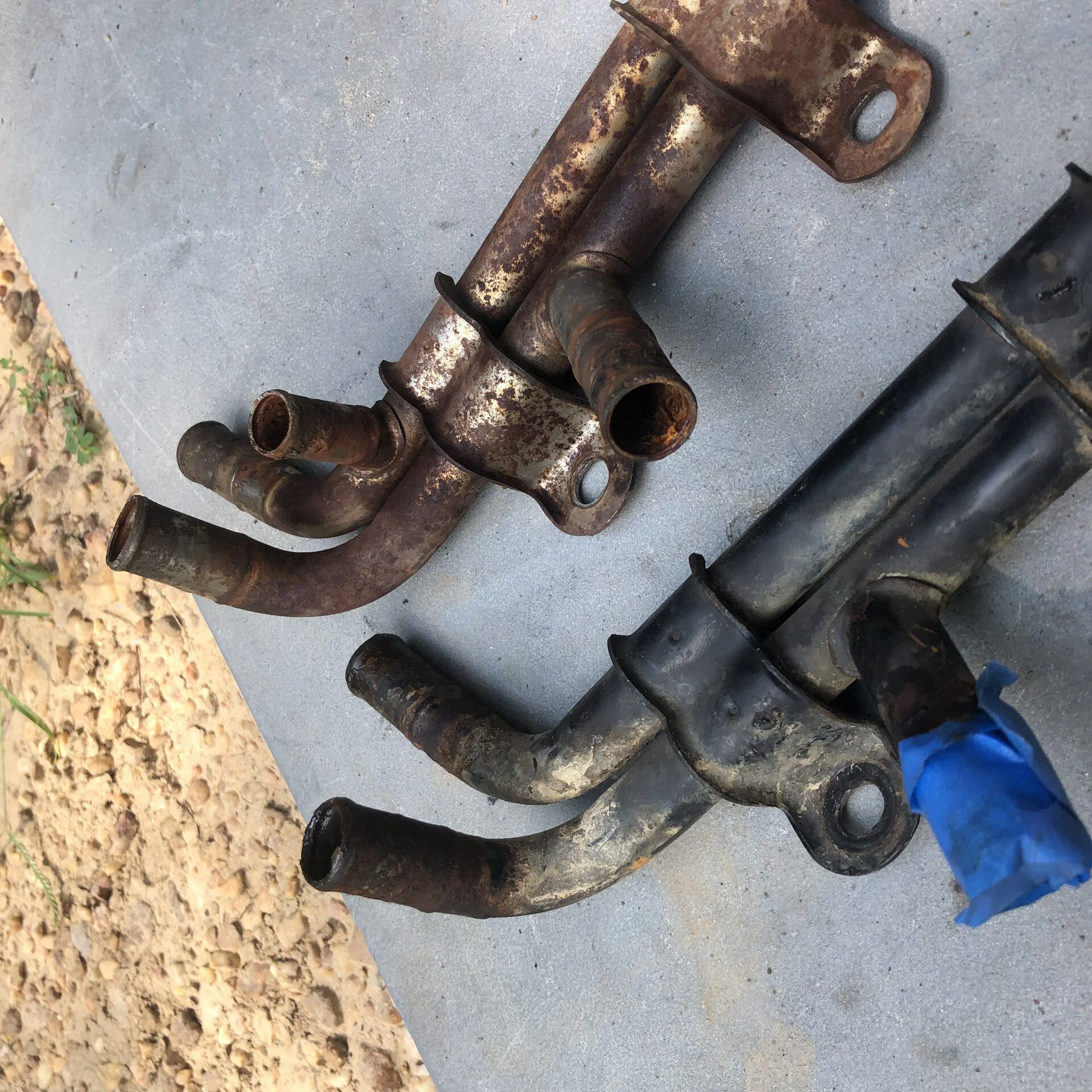

Buttoned up the cooling system today. I had put a heater pipe on off a 3FE from an FJ80 only to find out that it’s different from an FJ62 heater pipe. Took it back off and put the correct one on.

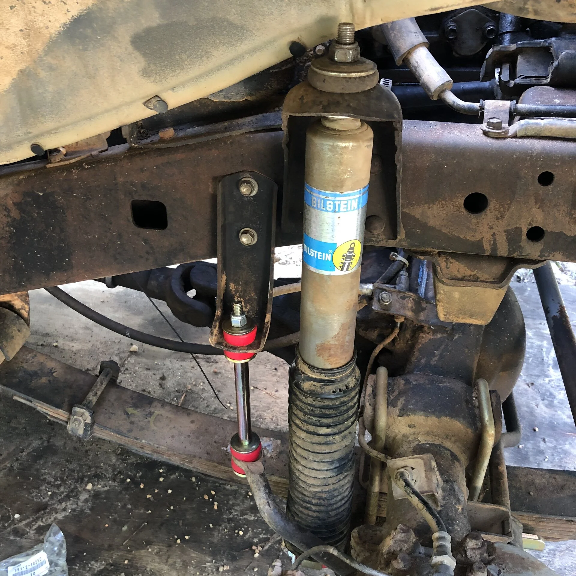

I installed a new Aisin 4Runner master cylinder, installed Bilsteins on the rear, and finally installed an 80 series steering box.

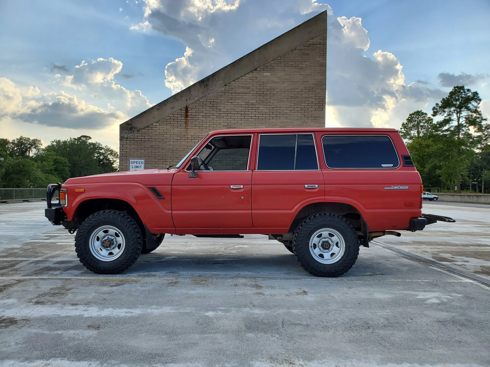

Lastly (but lets be real, most importantly :rofl:) I think the side profile of the 235 is about as perfect as possible with this truck - looks a lot better than the 31/10.50/15 I had for the last 5 years. Not gonna clog your thread w a pic of my truck with 235's, but it's >here<.
Please feel free to clog it away, I’d love to see more pictures of Clark.
