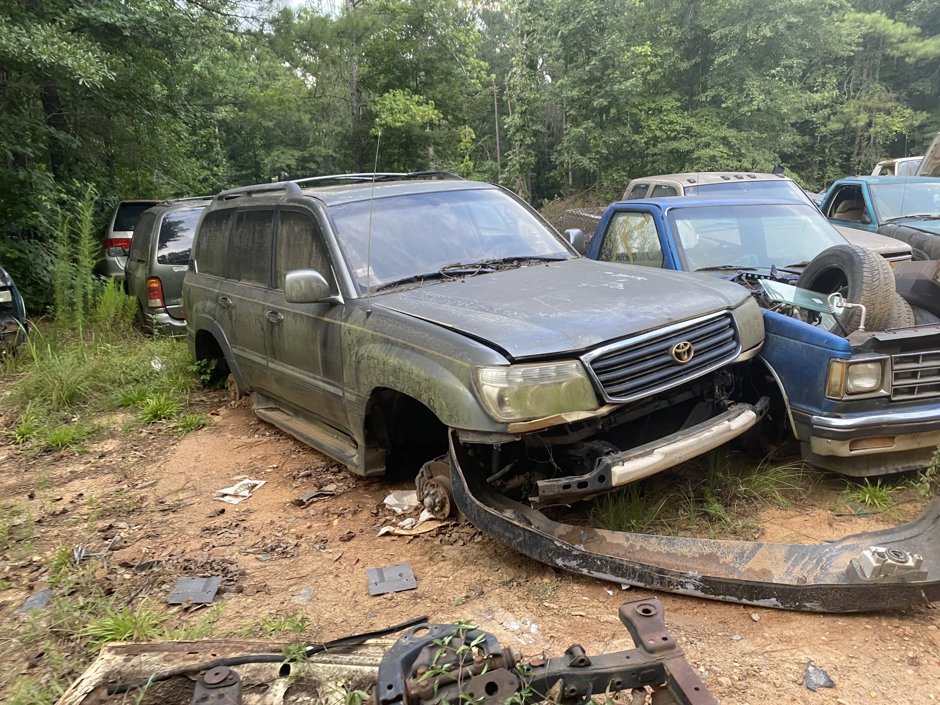

Several months ago @Godwin and I made a visit to a local junkyard after I found two 1977 2wd Toyota pickups from marketplace. I had been looking for a disc brake truck for a guy for a while to convert his from front drums to factory discs. When we arrived at the junkyard we saw this '99 100 sitting on its rotors at the entrance.
I paid the man for the two mini trucks, and we asked about the 100. He had it for several years and had intended to drive it but it kept randomly not starting. This is rural Alabama, 350 SBC country, and any sort of potential electrical issue is a death sentence. He and my dad agreed on a very cheap price and made arrangements to come back the following Saturday to retrieve it and the second minitruck.
My dad intended to just part it out or sell it, but we ended up deciding I would fix it and turn it into a driver/ light tow duty truck. I buy and partout minitrucks and 4Runners when I find them and up to this point I have either used my FJ60 or one of my dad's 80s for that stuff. This will fill the role a bit better.
It is a '99, has a factory rear locker, with 318k miles on it, it's from Georgia, then came to Alabama at some point. No rust just dents and neglect.

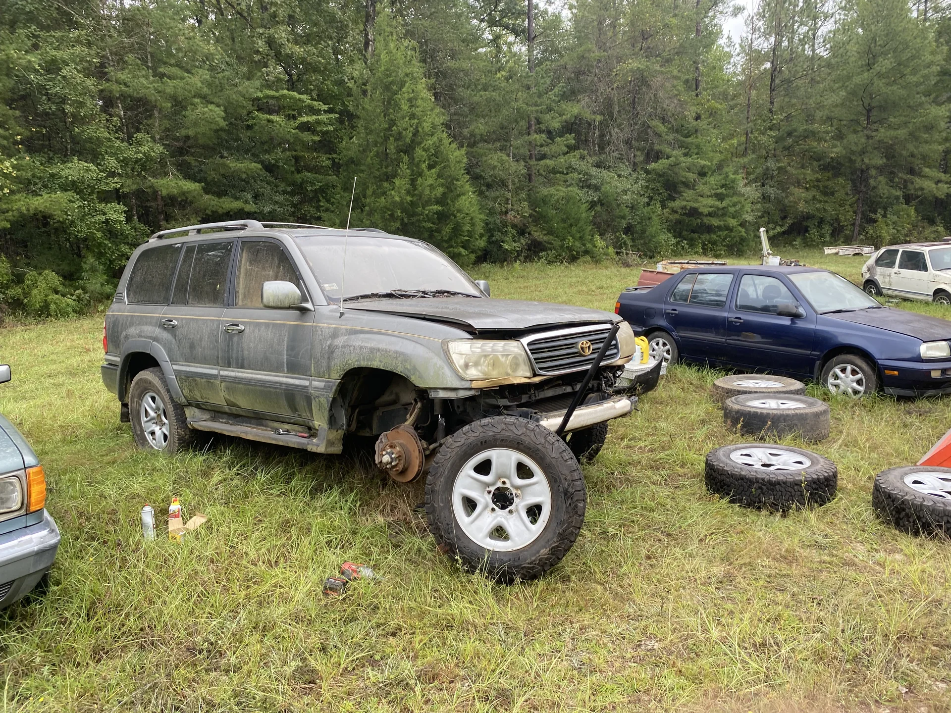

The cats were cut off at the junkyard but @BamaPaul hooked me up with some, and the driveshaft got bent when it was loaded with a forklift. I found some cheap almost new KO2s on marketplace for ridiculously cheap and slapped them on today to drive it around the field.
It runs like crap, I think it's only running on four or six cylinders and has died on me a couple of times. I only put a few gallons of gas in it so I'll start there and see what happens.

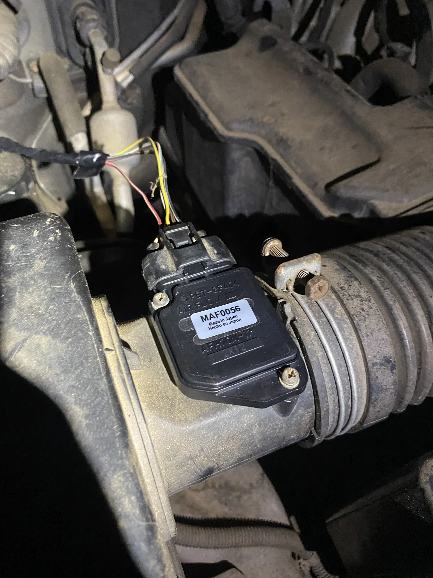

After I had the 100 running it had a sporadic idle where it would bounce between 500 and 1000 RPM, and after idling for about five minutes it would die if I revved it.
Under the advise of a several people I replaced the MAF with a Japanese Hitachi unit from Rockauto and corrected some horrid wiring from a PO. The MAF it had was completely unmarked.
After I replaced the MAF it idles steady and I’m able to drive it without it dying.

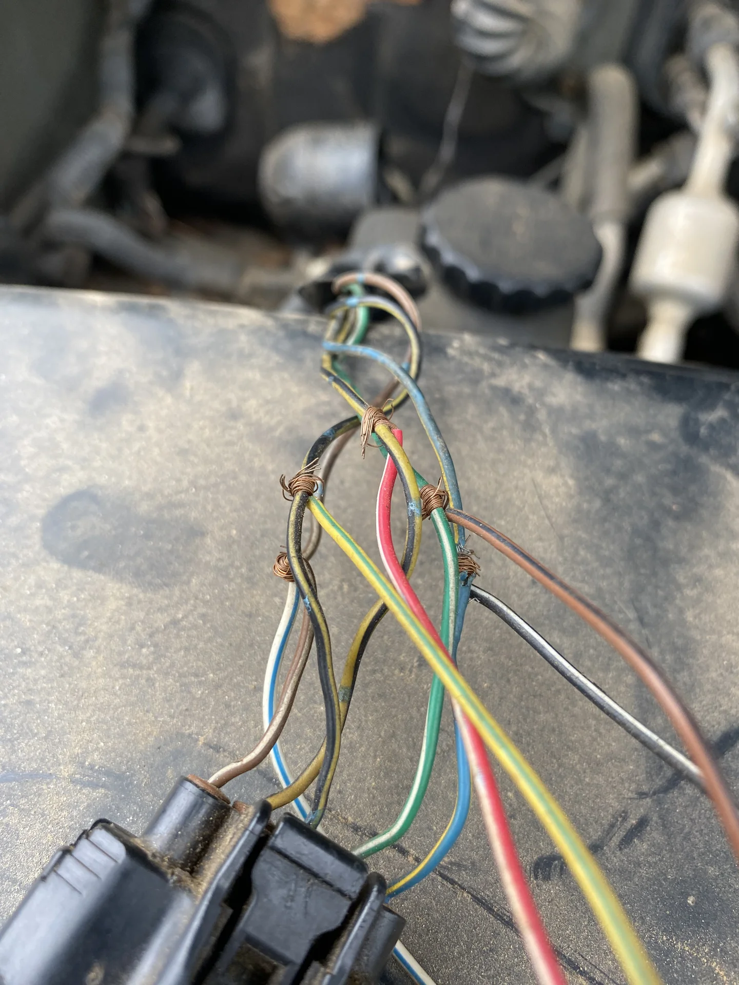

just cut, strip, and twist the wires. Add some electrical tape, call it good. LOL, man, not sure what part of Alabama you're from but it looks very similar to rural south Louisiana from that.

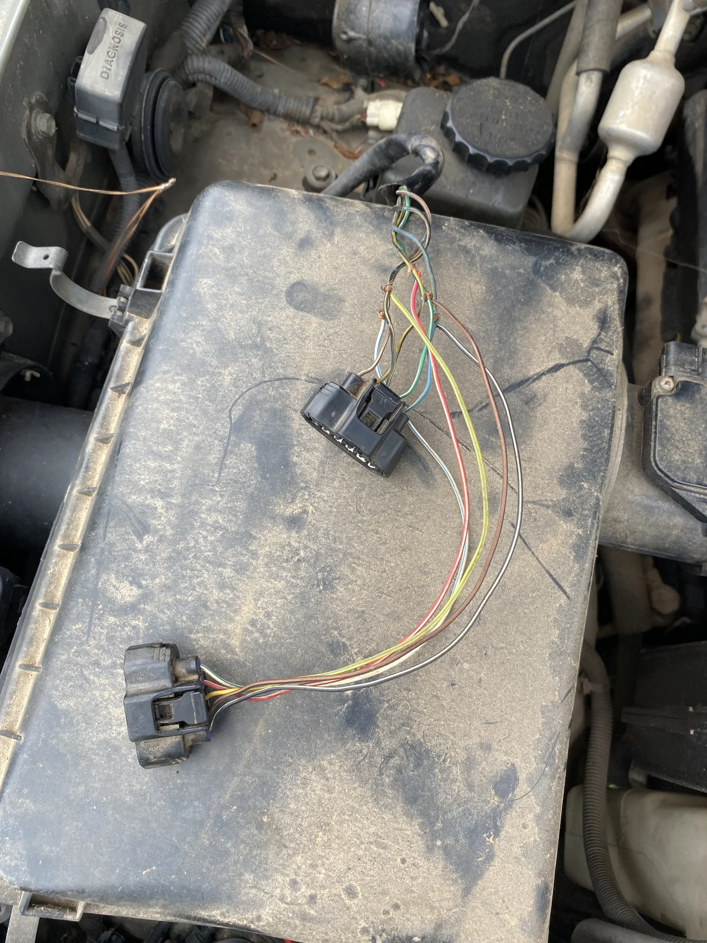

They didn’t even add electrical tape, just stripped back the wires and half way twisted them together.
I have it repaired with one connector instead of two now.
This is central eastern Alabama, between Montgomery and Auburn, it’s hard for folks to understand more than a one-wire temp sensor out here.

Nice save on the 100. MAF and PO wiring are good ones to knock out first. What's left on the list? On a truck with no history I'd write down every fix as you go, so if the idle acts up again you know what's already been changed. Worth checking for vacuum leaks too if it's still hunting at all.
