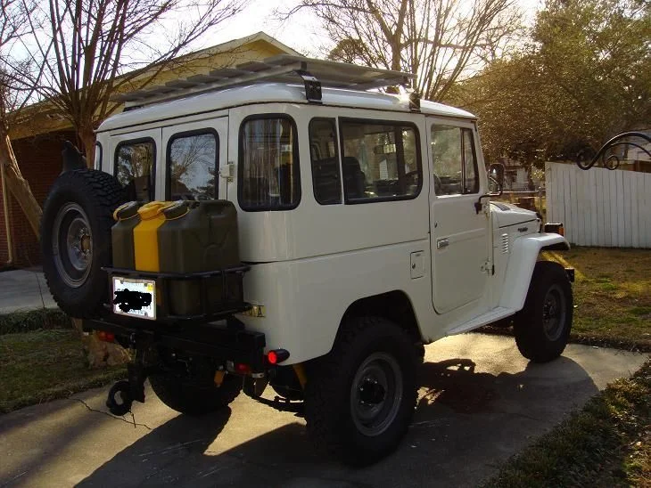

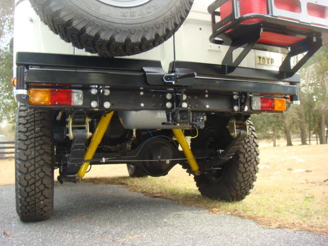

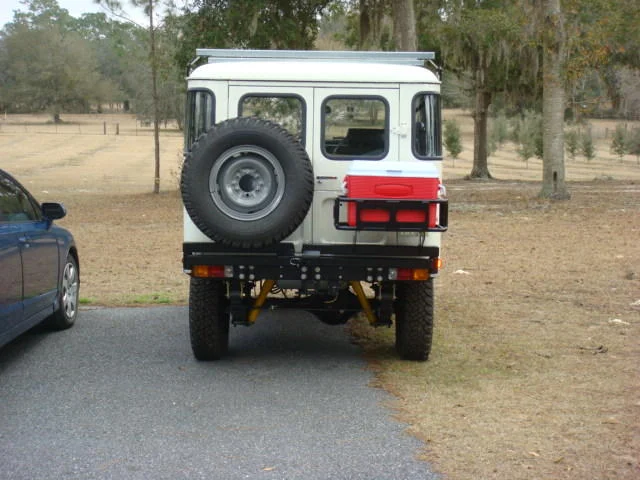

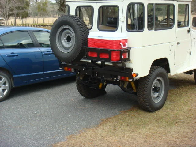

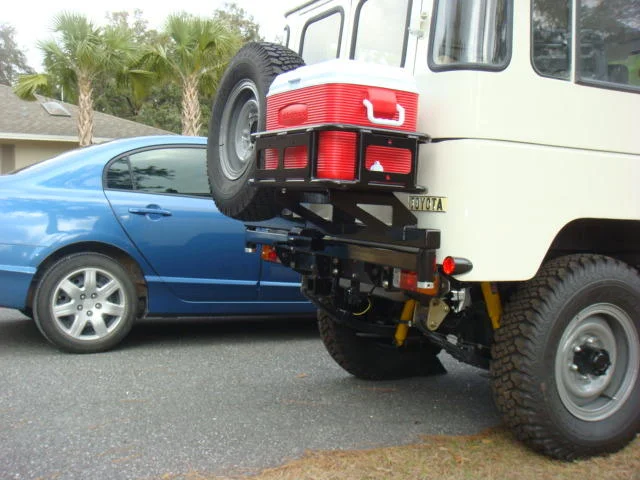

got the MAF-1045 bumper on, heavy, heavy unit, my pop actually installed it since I am 7 states away. with the 235/75-16 tire the amby door just clears by half of an inch thank god. he said was a pain becuase comes with no instructions and that my onboard air tank in the rear interfered a little with the mounting bolts but he got it.
R

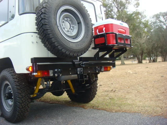

Awesome work, i'm loving it! That outside esky (cooler) carrier is something we don't see down here in oz, but it's a good idea considering the lack of room inside a shorty. Hope your engine woes are soon fixed! :cheers:

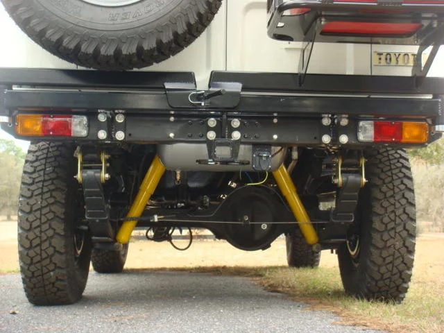

Rob, where did you get that battery tray holder/bracket which attaches to the chassis on the driver's side ? Is it OEM ? My LHS one is like that but the the RHS one that came (un-mounted) with the truck only has mounting points into the fender and I am not sure that the fender is strong enough to carry the weight of a battery etc ?? Could that be the OEM gasser setup ??

just spoke with engine shop 10 mins ago, they had to send engine back to machine shop to bore out liners for he said piston was too tight, they knew liners came semi finished like I told them, as long as it comes back right I can hang a little longer for it. cooler rack holds 3 jerry cans or approx 24" x 14" cooler, I like that for I have 4 new diesel scepter cans and my camp trailer holds 2 jerry cans as well.
Wayne, the bumper came with some scrathces on it but what can I do now, they should wrapped or handle a little better than they do? Heavy, heavy!!
Theo, I can only imagine the $$$ it would cost to ship to the Cape, it cost me $200 inside the U.S to FL?? The battery tray mount is OEM out of the Canadian spec 40 series for they are 24V with dual batteries, I ordered a used one from a shop in canada and it mounts just like the other one on top of frame rail and through sides, holes are already tapped for it on yours like mine was. it sits a little farther forward than our passenger side ones but that is how they are in the CDN spec cruisers. very heavy. I actually just seen one on ebay not too long ago, it would cost you a little in shipping but if you need me to locate you one I will see what I can do,

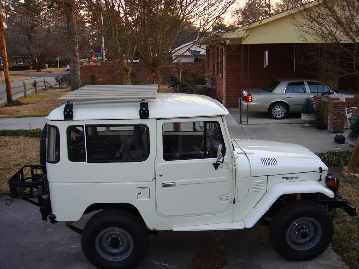

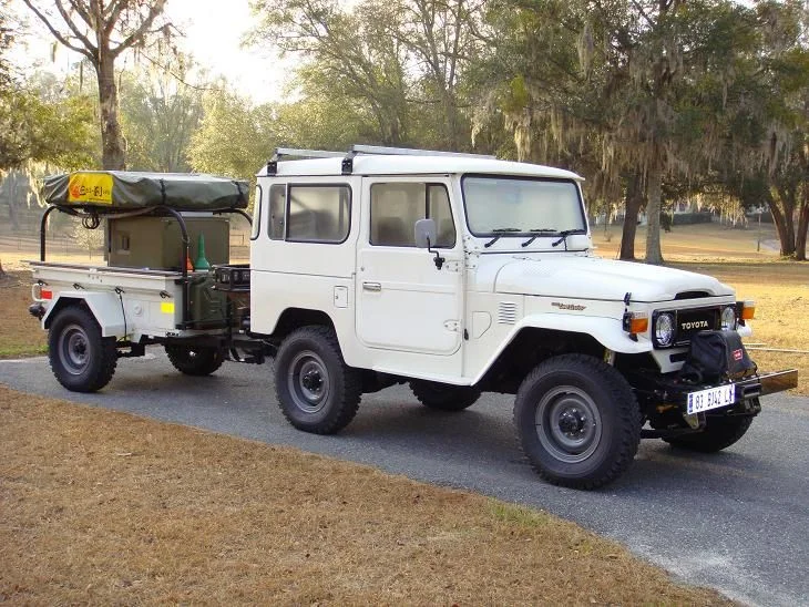

well finally got engine back in and it made its ride from FL to NC or about 500 miles. she did great after she finally loosened up, initially she wouldnt go over 50 mph but by end of 12 hour drive she was doin 68mph @ 2500rpm with no hills or headwinds and this is with my headers back on. I will reinstall turbo now so I am able to pull my CDN M101 trailer, my folks had to pull my trailer for me on this trip while I broke my rig in. finished my homemade roof rack made of recycled composite decking board and Kendorf electrical conduit holder for braces (both heavy and stout).
R
R
That is great to hear :clap::bounce::bounce2:
And your rig/trailer combo look awesome together!!:eek:
Sooooooo... can't remember or maybe you never said what your plans are now that she's done? I take it you are goin' on a little trip?
