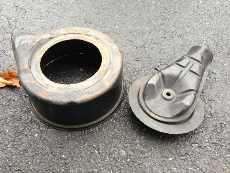

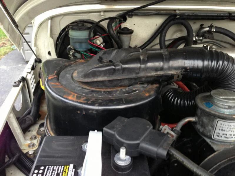

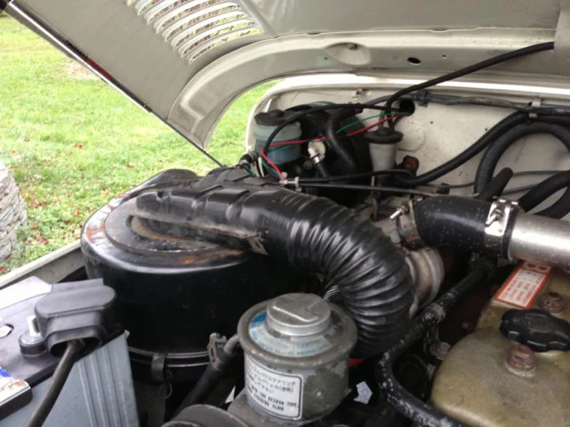

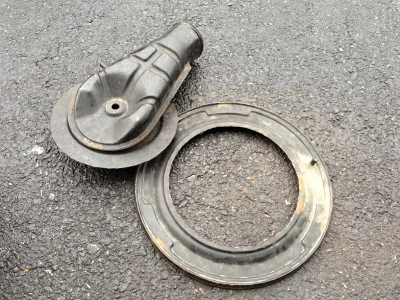

Purchased a 70 series air cleaner so I could cut top portion of lid off and incorporate onto my cyclonic air filter housing since the 70 series has a shorter snout. I was thinking of welding the portion once I got it aligned and when I get SS turbo tubing made to go from outlet of air cleaner to turbo but instead or at least for now I just added some military grade rubber foam and tightened down the lid and it works fine so I may just leave like that so I can make easy adjustments or I still may weld it down.

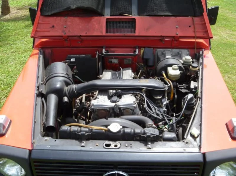

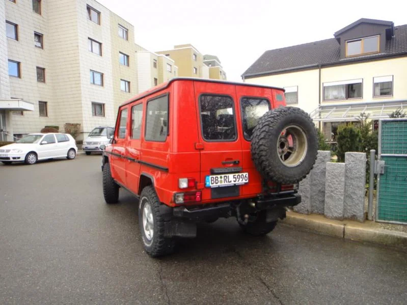

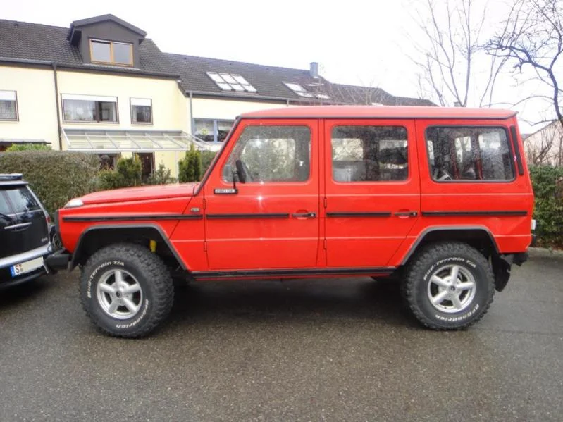

Kinda off topic but here is my newest ride I just picked up. 1985 MB 280GE, factory hydraulic lockers, coil springs on all corners, 4 speed, 4.10 gears, 2.8L twin cam inline FI 6 cylinder. So here I start again.

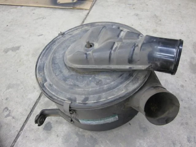

What is the id of the 70 series air cleaner outlet? i want to go this route also for my 42 turbo build
