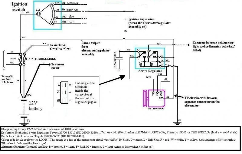

If yours is a 6-wire regulator with a connector like the one shown in this diagram - then a "Transpo IN551" should be a suitable aftermarket solid-state version (sold over your way) Rob:

I looked at the diesel parts ref in this diesel section and someone said Transpo IN218? So i just ordered on for $35
R
My searching isn't very successful at the moment on the IN218 version. (I can't find any images.) I think I saw something on MUD about it being used on a 12 volt BJ60 ...But I wonder what type of connector it uses (round or rectangular) :hhmm:
IN551 uses a rectangular 6-pin connector as shown in my schematic.
I hope it fits anyway Rob. (And for all I know you may have a round connector on your BJ42 anyway.)
:beer:
Edit 24/2/10....IN218 is for internally-regulated alternators so it is unsuitable. IN551 is the ONLY suitable Transpo regulator for this application AFAIK.

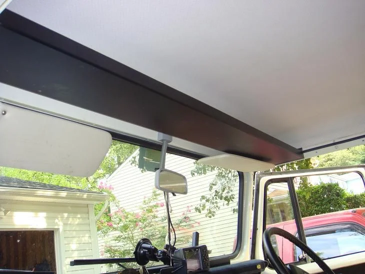

few more things done lately. added some more heat thermalsoundproof from CCOT under rear bed mats and need to do the front next. added some vinyl hood blackouts to reduce glare and added the headliner and overhead console from SOR.

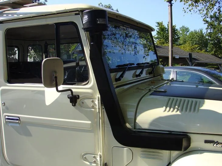

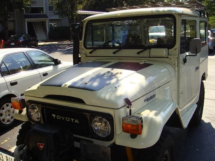

few things done this weekend:
added a stainless steel brake vauum tank from Awl_TEQ here on MUD in vendors section
custom aluminum snorkel from Awl_TEQ here on MUD here on vendors section
stickers i had made
roundeye H4 headlights
