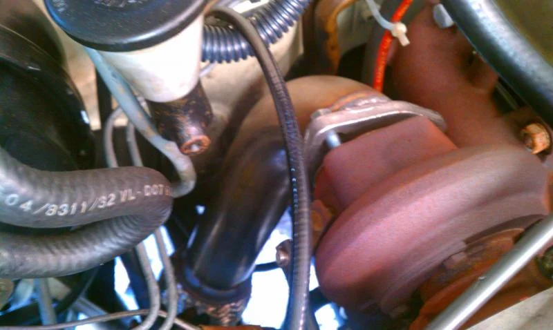

not installed exhaust brake yet, just the shifter switch. I actually just went to the exhaust shop today that is going to do mandrel bent 2.5" SS exhaust for me in a few weeks and told them about the exhaust brake as well as an exhaust stack in rear that I will clamp on and off if ever fording rivers or streams, lol. My little rig wants to look like the big boys. they noticed immediately how tight the turn is from back of turbo to firewall so needless to say they have their work cutout. Will post pics and results of exhaust brake when installed.

They claim you don't have to actually attach it to the turbo, rather it can be down stream(possibly the drop). Not to far as to interfere with your deep water fording adventures your planning -LOL back at ya!!! The undercarraige of that thing could be eaten off of.

Forgot to add that I finally have plumbed the snorkel into the turbo and wow that snorkel growls right in my freakn ear. I can no longer hear my exhaust out rear drivers side which I would have to say was a more pleasant noise, lol

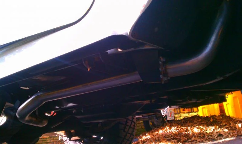

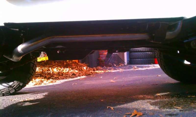

so had my 2.5" SS exhaust installed to include toyo exhaust brake. Cant try it because the retard solenoid is 24V I just found out so trying to get that swapped out. the shop did a real clean job on all the welds and heavy duty isolators. also figured a way that I can use my existing air cleaner housing. I sawed off the top portion and am going to have the exhaust shop weld/ tac a 3"circle maybe 1" or so high to top and they can just put the silicone 90 elbow right on it and route into turbo. it actually worked out perfect and I wanted to keep my overseas cyclone housing. I will post more pics once they add this piece to top.
