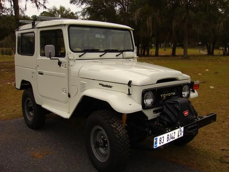

1983 BJ42 buildup/ resto
WoW mate that is 1 truly awesome build up dam near amazing looks factory , ive just got a 6/82 LX 4sp stock as a rock with the same winch rust proofed from new 1 owner and i thought it was clean , i actually bought it after seeing this build up back in august searching google for info , theres a pic or 2 in my user thingo , check it out , and hey werent you the fella with the sliding winda`s`` :))
what happened there ?
i wil check ur rig out, thanks. on the windows, the felt inside the slides cannot be obtained and anyone I asked didnt have an answer, so I bought late model hardtop sides with pop out vent windows, and had all LX specific rear seatbelt and plastic paneling mounts taken off old sides and welded on new sides.

thanks for the comments fellas, got the cruiser back up to my folks place 3.5 hour drive from where my engine still is, hopefully in a few more weeks I can get the engine back in??? making the roof rack as I go, using kendorf which is heavy duty used to hold electrical conduit on ceilings in commercial jobs, in these pics it is galvanized but getting some new stuff in stainless, and then 5 pieces 48" long that are smaller in height will go across these 2 pieces spread apart every 12" on center and then buying recycled plastic grey decking board from Home depot for the slats, they will be 64" long x 4" wide with 2" gaps inbetween the slats. Just ordered the Man-A-Fre 1045 rear bumper/tire holder/ cooler carrier yesterday, will get that on when it arrives in a couple weeks. got a matching second battery, and installed my subwoofer box under my rear seat/ JL Audio 8W7.
